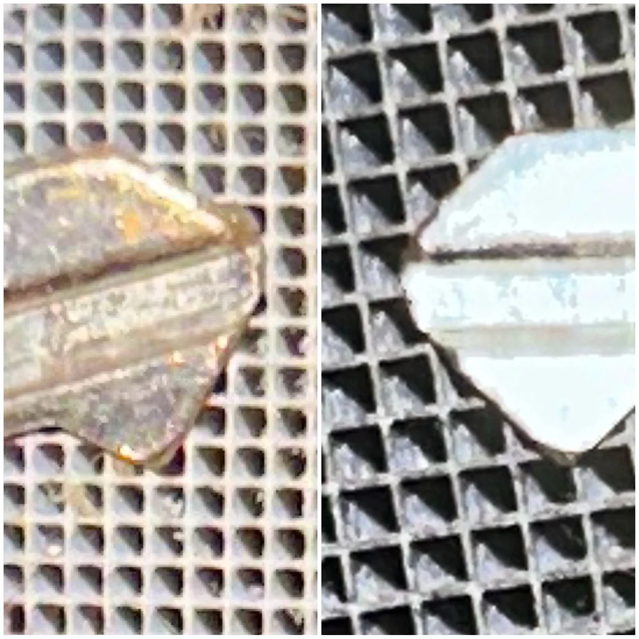

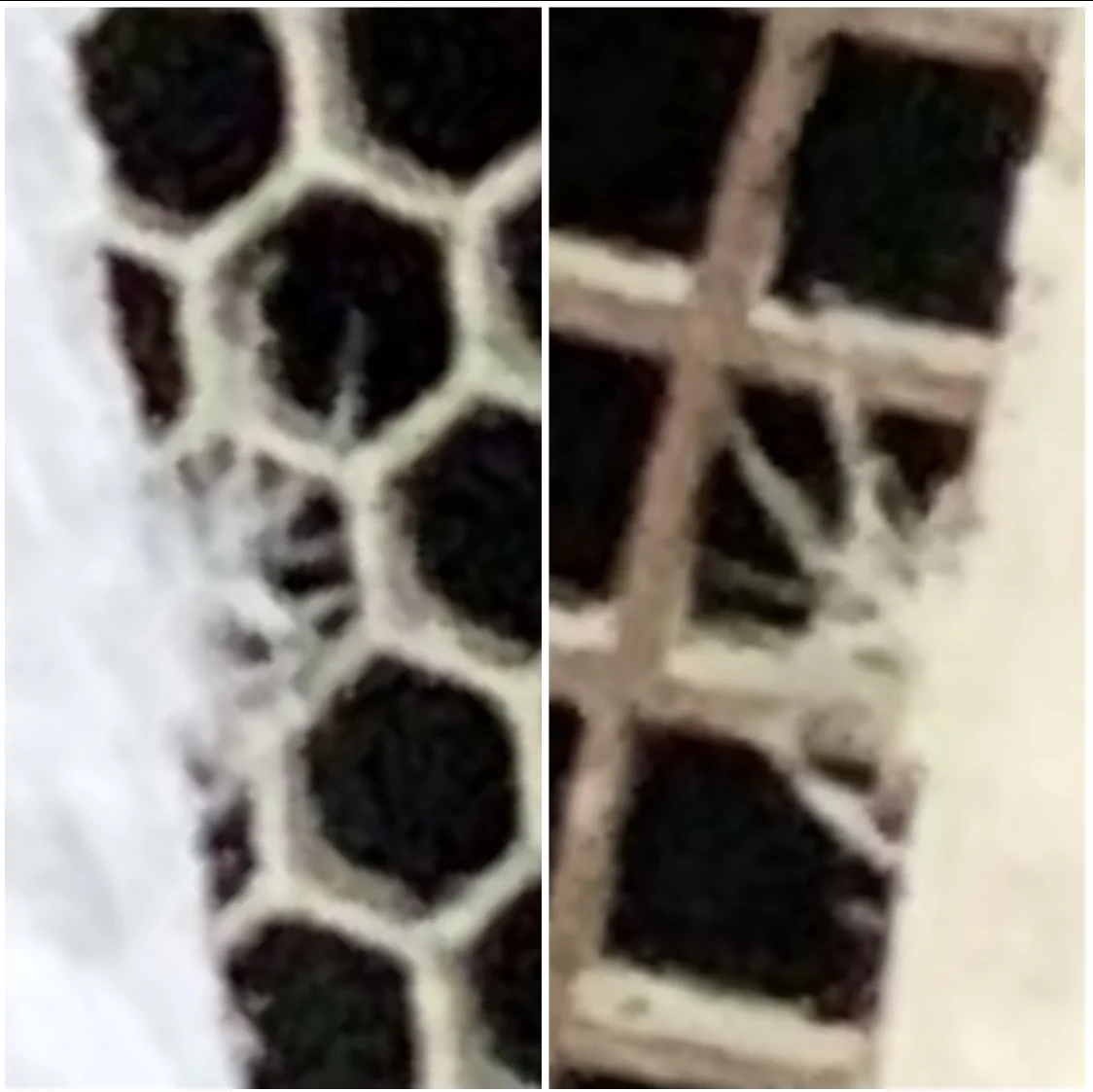

Attached are two photos of cats, comparing the F150's to the GT500's.
In the GT500, the surface area is more porous, less-restrictive and more free-flowing.
