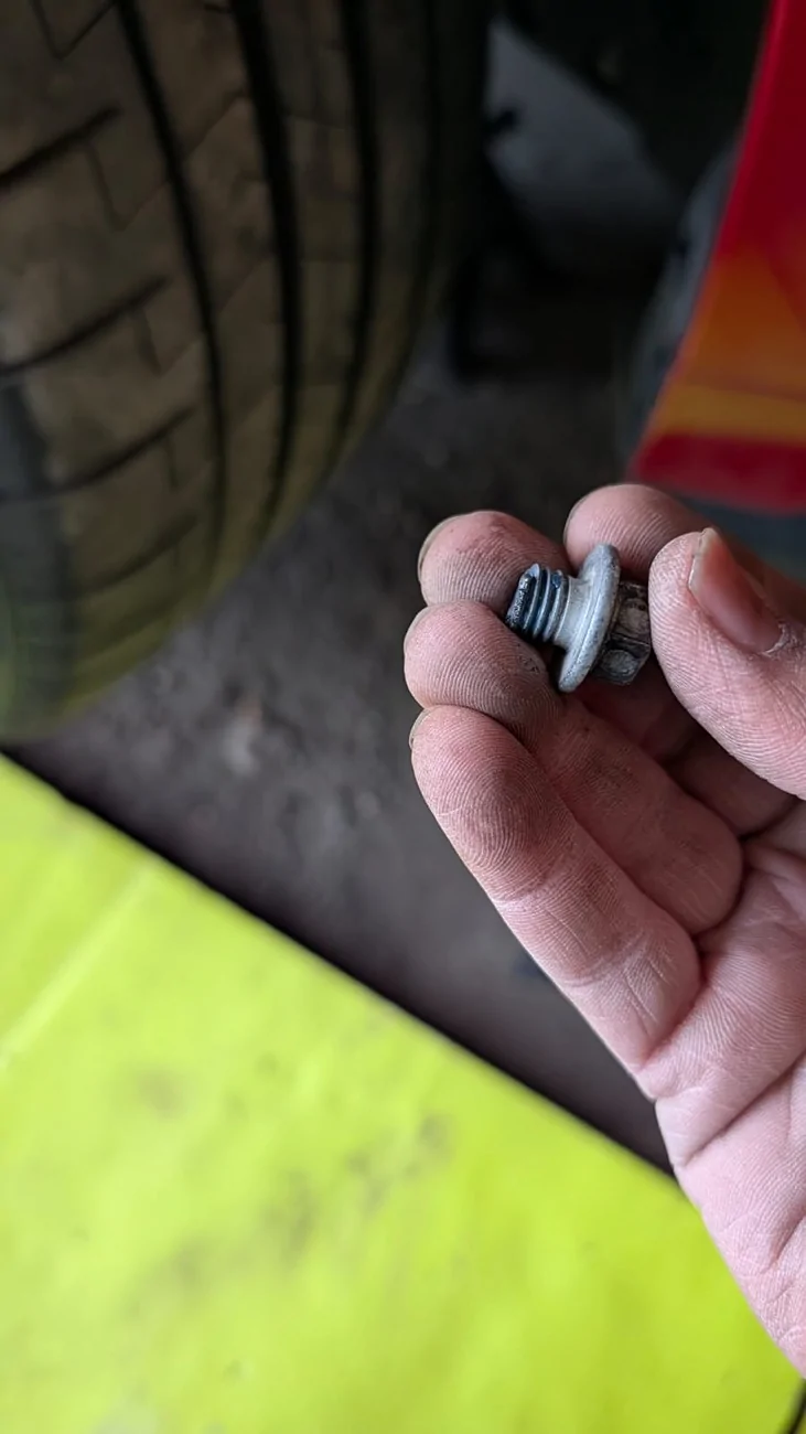

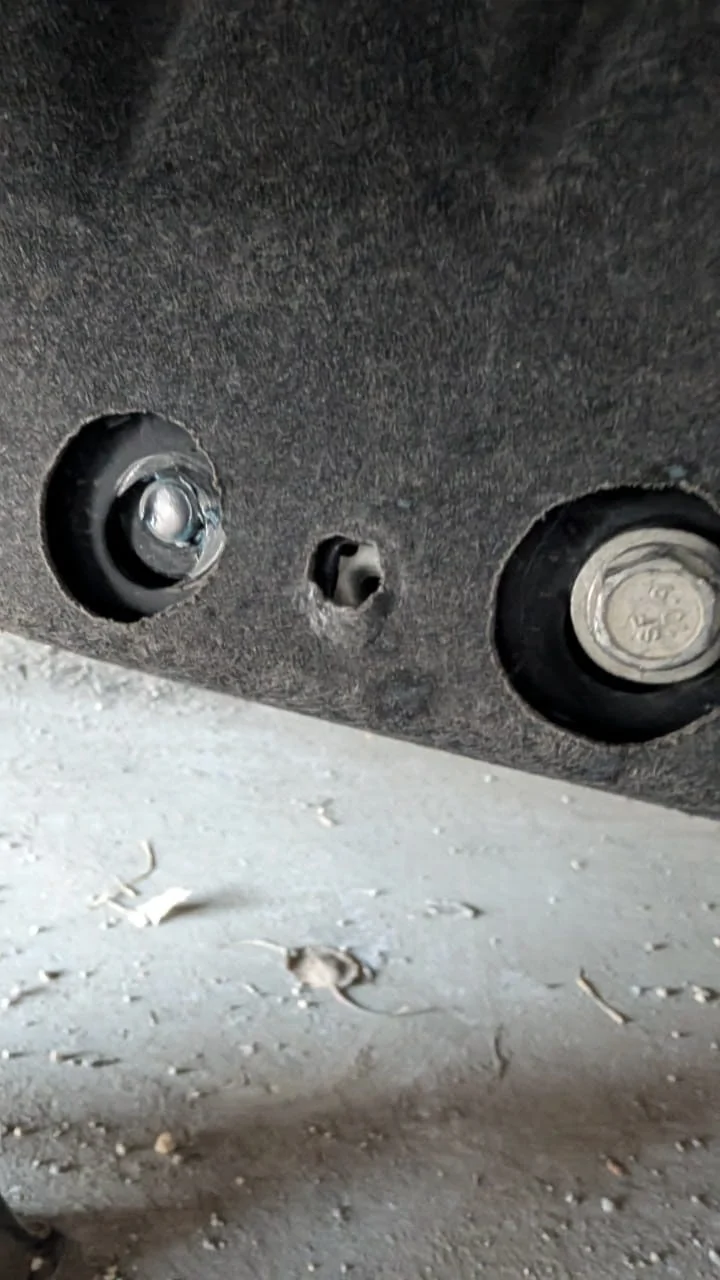

I took out the 2 bolts behind the wheel which are for the k member I think. I was reinstalling the strakes. One of the bolts went in fine but the other one was very hard to go in. It eventually broke while I was putting it back in. I did notice that the hole was a bit misaligned from factory. Now like 3/4 of the bolt is in and the rest broke off.
What do I do now?

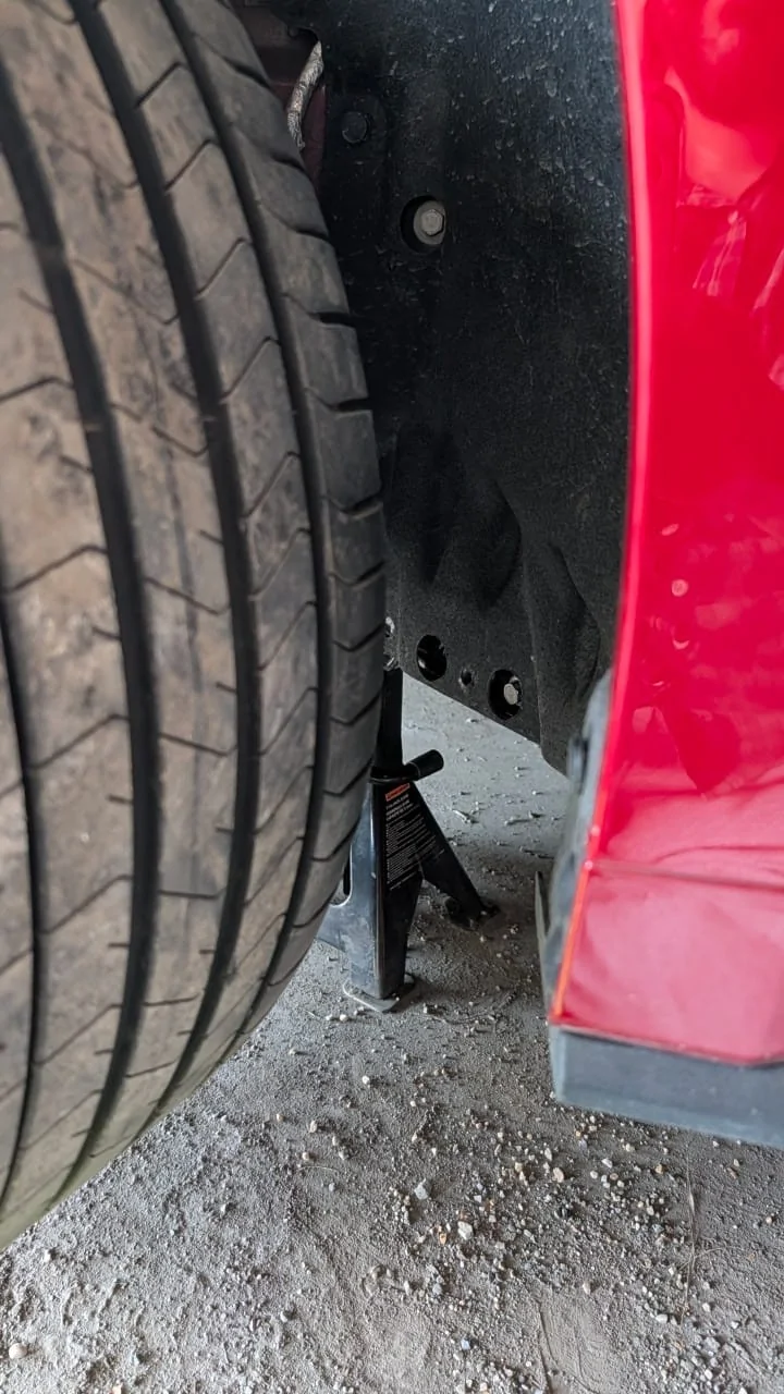

Judging by the placement of your jack stand there, I would wager that the hole was not misaligned from the factory. Rather it was the jack stand causing things to shift with the weight of the front end on it once the bolts were removed.

I actually placed the jack there after to see if it will help align the hole. The jack was not there before.

Spray with penetrating oil or PB Blaster, then try an easy out? Obviously you'll need to take the load off as mentioned.
LouG
Mar 11, 2025
2,579
2,972
New Zealand
Drill it, easy out it.
If that fails drill it very carefully with a larger bit that's smaller than the thread diameter, clean up the threads with a tap. Next will be thread repair.
Job done.

with the amount of force I had to apply to make this go in and then get broken off im scared even easy out might not work

When they're going in hard, it's the backing out that usually ends up breaking them.
So, when they say to try an EZ-Out, don't!
The bolt itself, is hard enough. You do not want to drill through tool hardening.

Chances are what remains is sufficient, while the additional remain in place, to drive to a shop - just don’t hot rod much.
or as was suggested flatbed to repair location.

A welder at Harbor Freight is like $100 I would just weld the head of that bolt or another Bolt weld them together and then just screw it out
