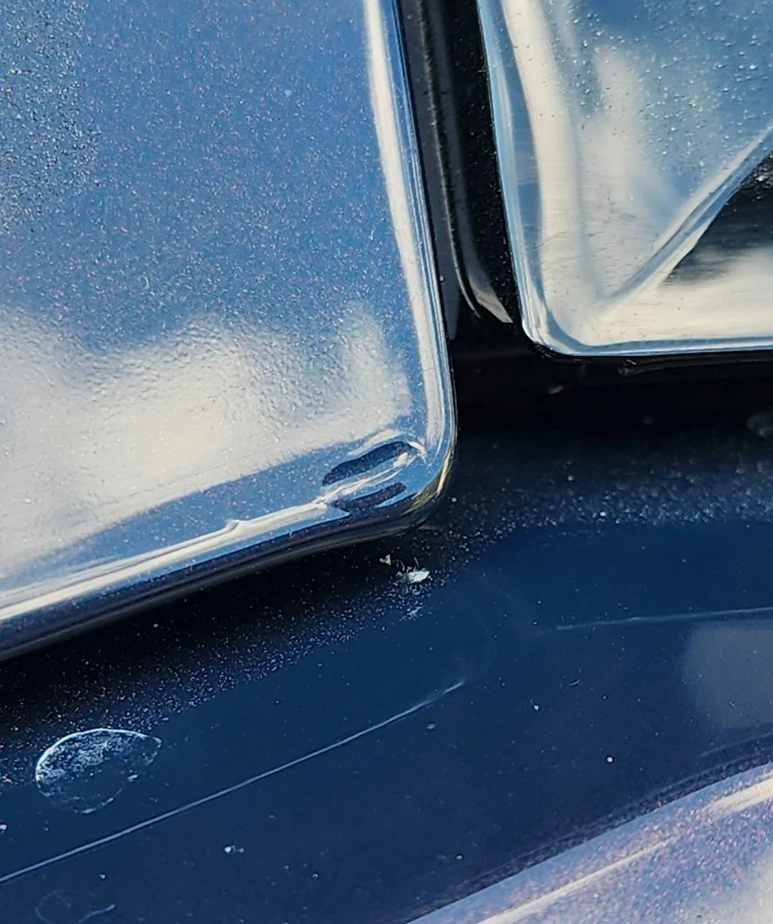

I didn't think I had a picture on hand but I do. 3/4 of my Mustangs had paint issues. The first IDK because it was beat when I got it but it was my first car so it didn't matter. My hood has portions where in the Sun it's clearly teal and not a behavior of Blue Ember Metallic like the coating was uneven, it straight up looks like overspray but I can live with it since you only see it in the right light and up close, at the end of the day it's not compromised and a corrosion risk. This on the other hand stinks like a corrosion nightmare that'll take enough time to manifest long enough for the warranty to expire first.
That is a very common paint blister that is caused by impurities on the body area before it was sprayed., Problems of repairing this type of issue are: First the trunk itself would need to be stripped down to metal, cleaned, reprimed, urethane base, clear coated and everything that happens in between. That is straight forward, next issue is matching th color exact. Could be a bigger issue. This really cost Ford nothing, but that does look like a factory sourced defect. Simply because it is a blister. Once exposed to the sun, which heats the paint, the impurities underneath forms a gas that lifts the paint and the blister is formed. (I use to restore Corvettes and very familiar with this issue. Vettes are glass or urathane Iplastics) that needs to be perfectly cleaned.)

One more point; Ford is probably rejecting your claim as your photo shows water spots and dirt, so Ford would assume that you are not maintaining the paint, feeble but that is how they look at ti, I think that is wrong. Appears you must be in snow area, as the bumper appears to have salted dirt spots, again any excuse they will use. This is on the lower right trunk lid, or on the bumper. On trunk lid, metal, on bumper urethane, two different ways to prep for paint. Just saying.
Thanks for the input, it'll help me be a bit more coherent when arguing my case. Your solution is pretty much spot on with what the manager said to me. She told me all they need is for Ford to approve the warranty job so they get reimbursed, which is apparently the problem.
These are just my pictures. The manager took her own. The last time I saw her I came straight from the detail shop for a one week checkup on their PPF work, at their request I washed the car earlier that day so they could see any potential problems with lifting etc. The car was spotless and it was like 70F mid September clear skies, I bought the car new 3 months prior. This booger is on the steel trunk lid.
I'm not conviced there's any care or cleaning product I could use or neglect that would result in paint blistering. I'd love to see Ford argue in court in an easy W for me Maguson-Moss Act lawsuit, "But he let dust and rain get on his car!", ok Ford go ahead and prove that caused the problem.
Very Good, Its so hard to tell when photos are that close. I have been restoring Corvettes for many years and I purchase a 63 Split that had a large bubble on the spine just below the window, I thought I could fix it, but I found the entire care was not prepped properly resulting in a complete stripping to the glass, regelled, and reshot entire car. All this because the prep was rushed as you have to wait at least two weeks and wash the car almost every day once stripped (Corvettes), because of the chemicals used to strip. I wish you the best and think you got a very strong case, as the spraying of these cars are not perfect by far. Urethane and Clear are very hard when waterbased to shoot without peel or small bubbles. Again I will check back and have them do the WHOLE trunk not a Dr Chip solution.

I bet your car was one of the first shot that day, but usually trunks, doors, hoods are shot in batches not on the car but by themselves and installed on the car painted. I have seen sometimes when installed on the line the installer chipped the paint during installation and during QC it was detected and did a spot fix using a Dr. Chip type product. This could be another way of looking at it. Oh here is the paint job on my old 63.
