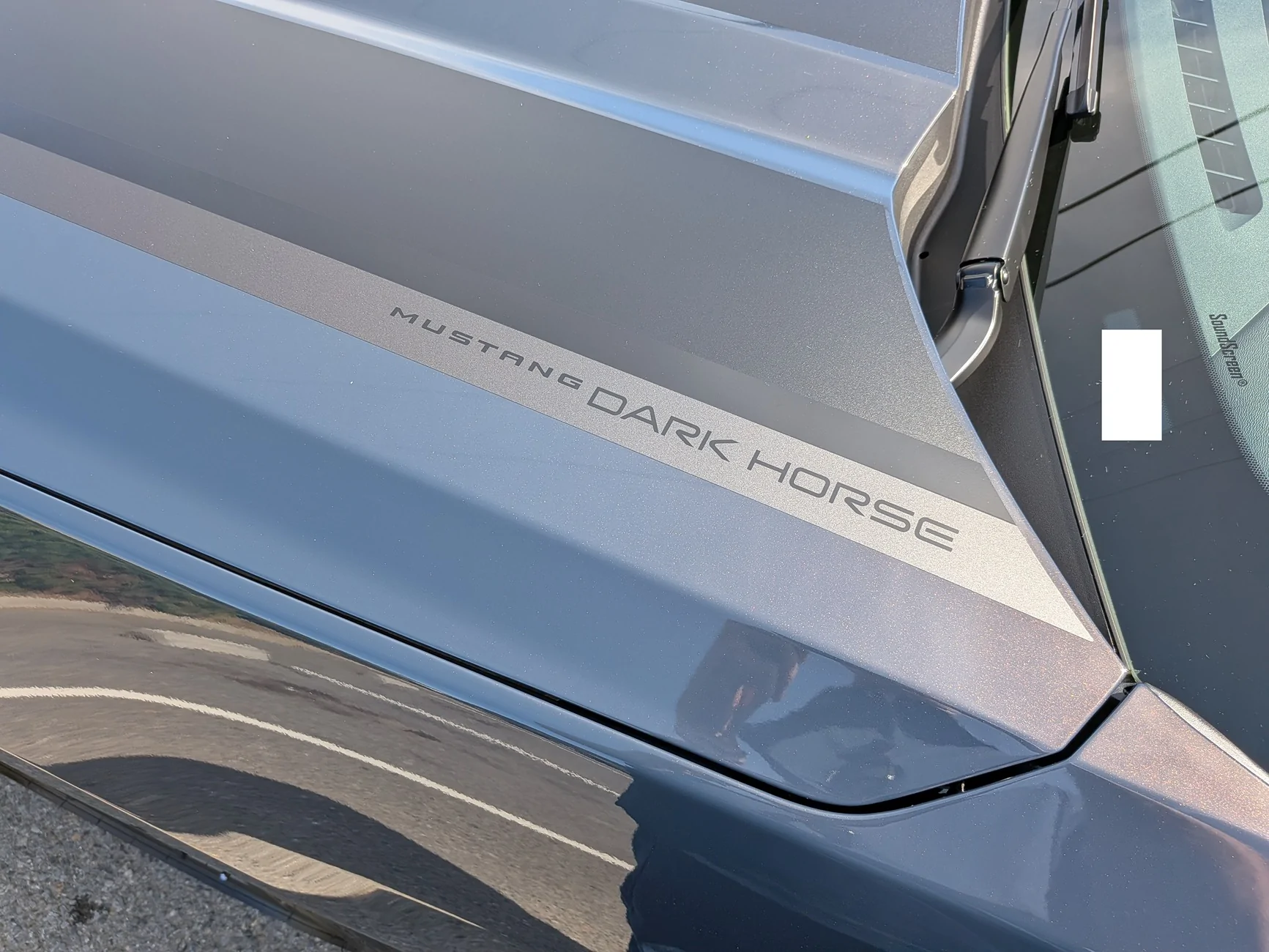

First wash fo for me... washed the car last night at 1830. Sun was setting. No water spots if you wipe things down quickly. If you live somewhere that has hard water it's tough. You don't want to wash a hot car either.
I also recommend investing in a good UV, vinyl, wrap, etc protectant. Something like 303. Wash the hood, dry it. Then treat the hood emblems carefully with the vinyl, wrap protectant. Then go back and do the paint around the emblems with a graphene or hydrophobic type protectant. The next time water will just bead up and wipe away. Its time consuming but if you stay on top of it its easier on subsequent washes. 😂
Last night result
S650 Mustang I have a 2024 Mustang Dark Horse after a wash my Vinyl stripes were hard water spotted on one side. Has anyone experienced that issue? Blue Ember Hood

Yes, this happens to me, too. Drying it off quickly helps, but I can never get the stripes or the paint looking like @DarkHorsePremium's photo, even though we have the same color of car.

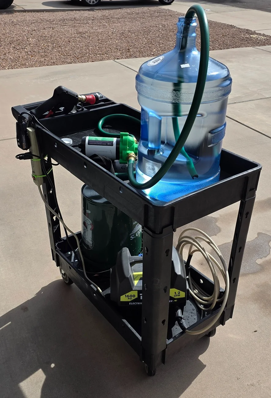

If you want zero water spots without drying use osmosis water that has less than TDS of 3. Filter systems are expensive and need media replaced that start to degrade after a few uses. I pay $2.50 for five gallons which takes three gallons for a final rinse.
S650 Mustang I have a 2024 Mustang Dark Horse after a wash my Vinyl stripes were hard water spotted on one side. Has anyone experienced that issue? 20260212_113849

Get the 303 protectant (non marine version) or the Chemical Guys spray that @AZ_Ryan recommends. Both have UV protection. I use a clean towel and wipe it on evenly in one direction. At first the 303 will look wet, but it mostly evaporates. It's water-based and completely safe for your decals. Then I use a t-shirt and trace around the edges to get it off the paint. After 10 or 15 minutes you can just wipe it clean. Makes your black decals dark and rich looking. The pic I took above was after wash but before decal treatment. A few good suggestions here to attack this. Hope it helps.
$2.50 for 5 gallons?
Where?
Osmosis water 5 gallons returns $9 everywhere around here.
