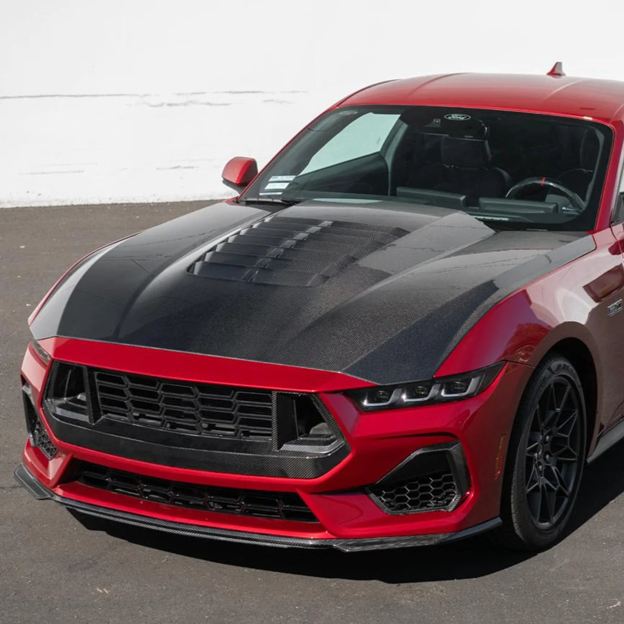

Anyone added hood scoops or fake vent? Anyone cut the hood on an ecoboost to add the GT vent?

I'm not a big aftermarket hood guy, but I do like that GT500 hood.
As for how the aero works, I'm no engineer but obviously the heat extractors are huge. I don't think the vents and cowl cancel each other out. But keep in mind that hood was designed so work with the front end of the GT500 which has large grille intakes for air flow.
Are you doing this just for looks or functionality? If it's for looks, just get the one you want and stop overt thinking the aero. If you want functionality, I'd consider the GTD hood, as I'd think that will work much better with the S650 front vents. 👍🏻

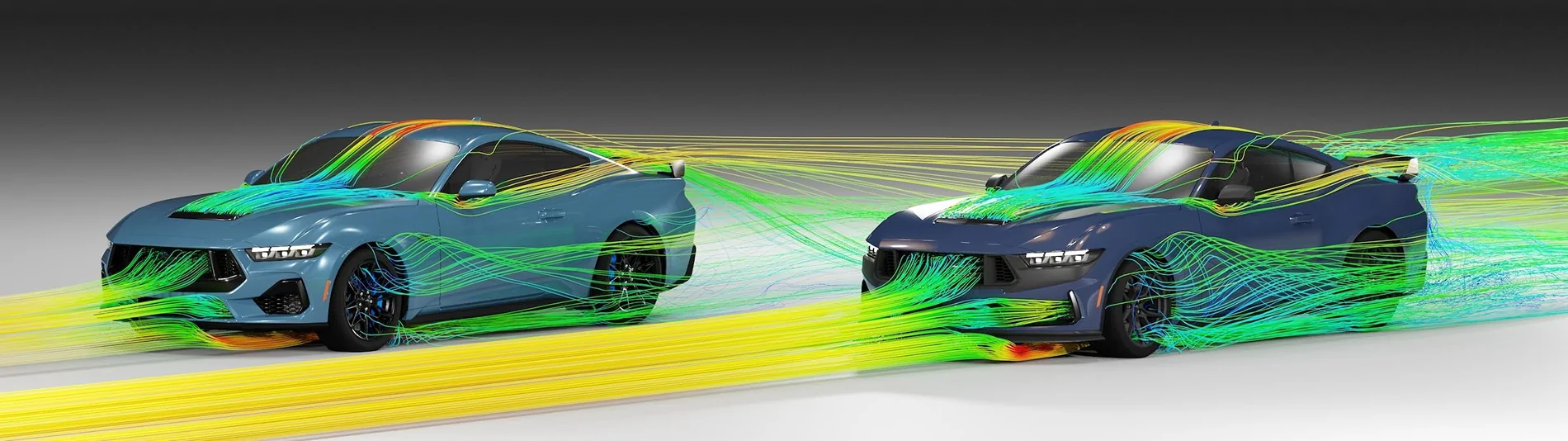

Another solution to mitigate lift at the front of the car is the addition of a hood vent to redirect airflow. “Any of the air that comes in the front of the car, it's got to go somewhere," Gesek explains. "If it comes in the front and it exits through the tunnel, which is where I think most of the air goes, you have a net momentum change in the vertical direction. And so if the air comes in high and exits low, then it's going to create lift. So if you can get the air to come in high and exit higher, that's going to be better for lift.”

The hood vent is not only a functional lift-reduction device but is something that Ford has been able to maximize based on what it's learned from its GT3 and GT4 racing programs. The aerospace background from people like Gesek certainly doesn't hurt, either. He shares that the hood vent on the GT Performance Pack and the Dark Horse has an enlarged front slat called a "scupper" in order to accelerate the air coming out of the vent. Gesek added that the goal is “creating this low pressure zone behind that raised leading edge, which helps to draw more air out of that vent. So if we just had that vent flat on the hood, it'd be 20 percent as good as it is. Putting that little leading edge on it kind of turbocharged it.”
