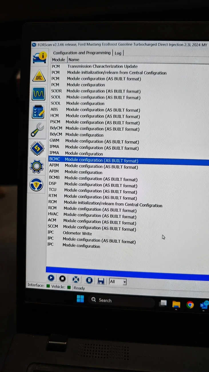

I tried doing it like in the video today but ForScan did not list the LDCMA and LDCMB. Had some issues showing all blocks in the PCM as well. Updated ForScan but LDCMA and LDCMB still do not show up.

Did you load a saved profile?
Linwei
Aug 3, 2025
54
Germany, UK and UAE
S650
Yes, the second time I started ForScan it remembered the vehicle, just like in the video. But it was not showing LDCMA/B the first either if I remember correctly.

Nope, but it might due to the fact that this car had aftermarket headlamps installed. Hence, I could not find LDCMA/B in the ForScan Modules. Confronted the dealer with it but nothing more I could do on that unfortunately.
