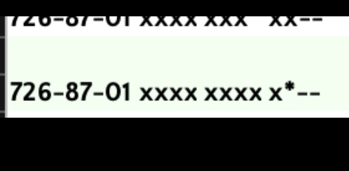

Hey guys! The mystery is solved!
First, you will need to enable the approach light from forscan (Search how to enable the approach light in the forum)
After enable the approaching light, to enable the tail approaching light , change the BCM line 726-87-01 to enable the taillight.
Change to x1--
Now we can all be cool!
Thanks everyone in Discord group for pushing and researching together!
