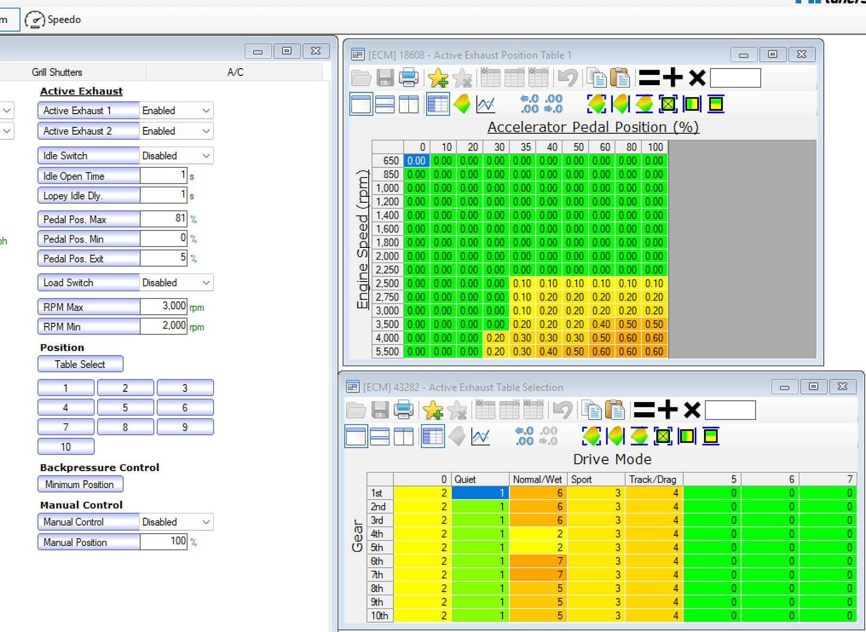

Some active exhaust data for your viewing pleasure from the tune.
S650 Mustang How do I set quiet mode 24/7 1749652439566-v3

Well, I guess mine must be “special”! Car in normal mode and normal exhaust.
When I start the car cold engine the exhaust is very loud for about 30 seconds. Then it seems to go to the normal exhaust mode. Perhaps it is just the increased revs for that time, but sure seems like the exhaust changes. If I start somewhere that this is too loud, I hit my FAVORITE button (programmed for QUIET exhaust) and it immediately goes to quiet mode. And, it’s all fine with me.
I’ll actually watch it closer next time I’m out.

Coyotes are very loud on cold start up. It doesnt have anything to do with the active exhaust.
Go stand behind your car and watch the valves next time you do a remote start.
