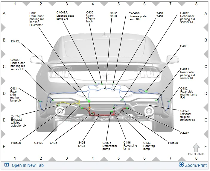

Yeah, I didn't find any microphones for ESE front or rear, looked through the diagrams. I wouldn't be surprised if its just digitized sound being played through the speakers, or pre-programmed.

or ese is the active exhaust version ? Enhanced capability of same function. If preprogrammed it would be easily detectable with the resonator delete or even resonator increase (as in add more baffling) and the faux would then increase since it can’t detect the variance ?

If ESE was there, I'd see it. I went through both ecoboost and GT diagrams. Didn't look at DH or GTD, though I could.
