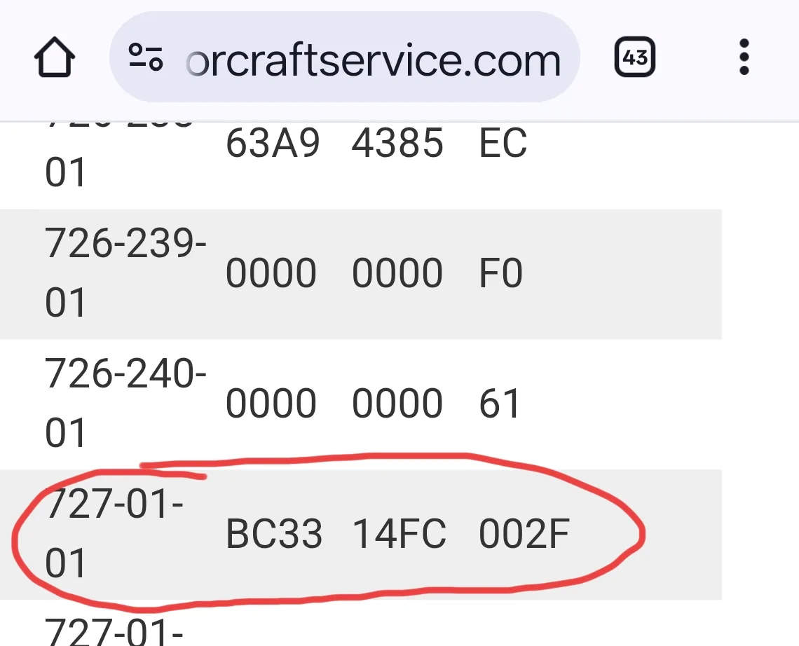

@Junkyard Dog
Go to that motorcraft website, enter your VIN and once you see the very long table on the website, search for the line 727-01-01 and post the complete line here.
You do not need to download the file.

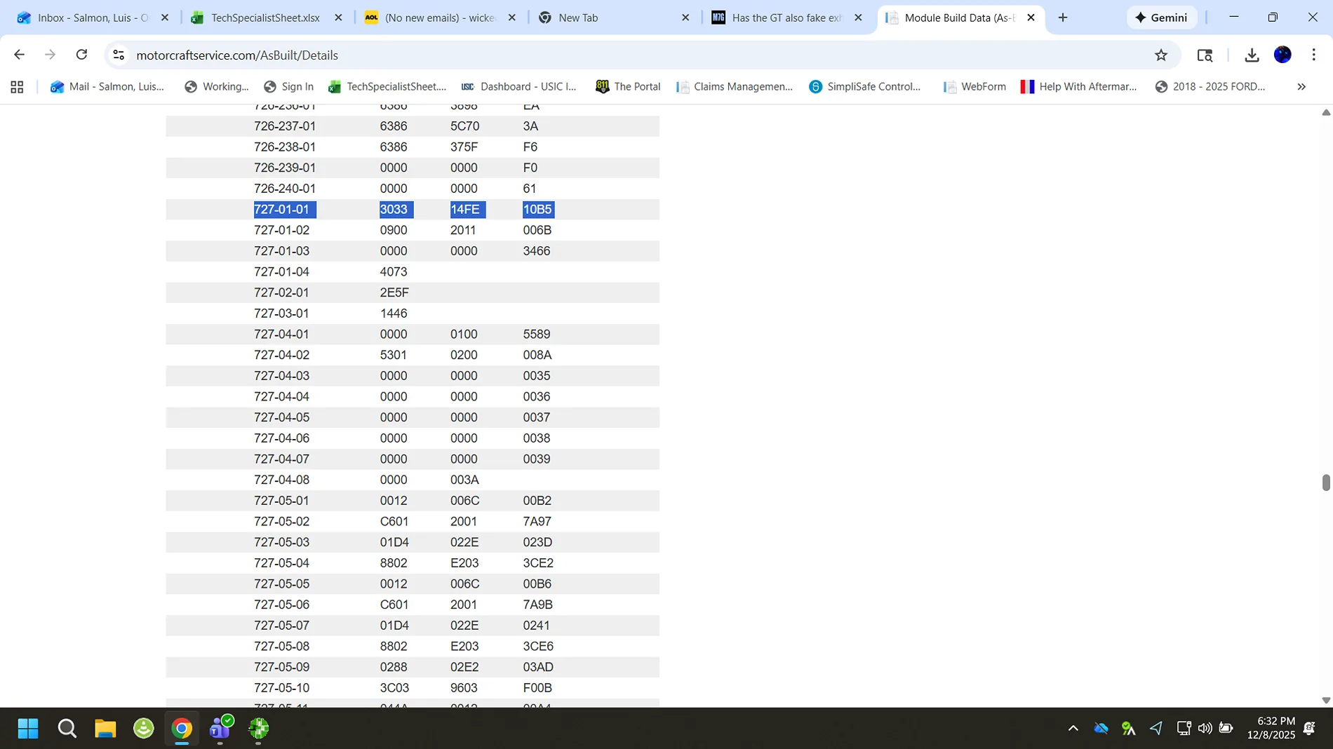

What would I change to disable the ESE?

The first value in the third column is what needs to be set to 0 instead of 1.
So instead of "10B5" "00B5".
After chaniging it, you might get a checksum error message which you ignore/accept.
The "B5" is likely to change later automatically as it is a code generated by the other values in that line.
