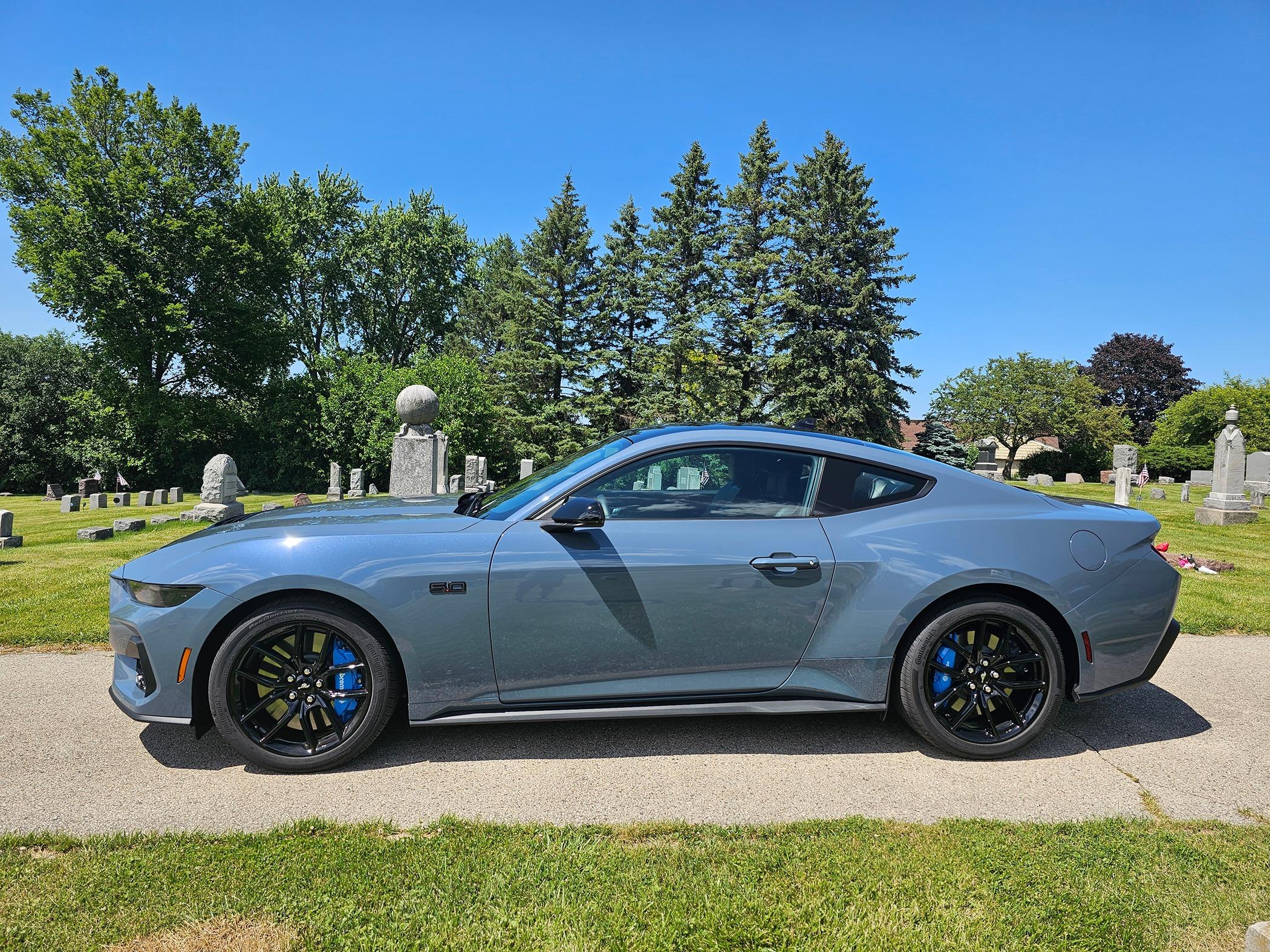

You can spec the nite pony package w/ brembos from factory.
Yes they fit. I’m currently building my car for autocross. Now I need to find out if the FP control arms can fit the 2024 models for the brake cooling.

Ours has the Nite Pony package, with BREMBO'S
