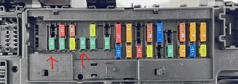

Hey stang fam, I bought the hardwire kit for my Cobra Road Scout dashcam/radar and ran the wire from the unit under the mirror and around to the passenger footwell fuse box. Got it opened only to discover none of the usual fuse taps or add a fuse i've used in the past will work on the H style Case M fuses (had to look this up). Can anyone help me out with either a tap that will work or another solution? Are the empty slots in the fuse box actually powered? I've read the manual and know which I'd tap if i needed to share, but if there's an empty slot with power, I'd prefer that. It'll auto off after a few hours anyway.
Also, there is a nice bolt and bundle of negatives right under the glove box hinge if anyone else is attempting this. you gotta really crawl in there to see it, but its straight up, about 1/3 toward the right side of the door.
Thanks!

Can you confirm those blade fuse types actually fit? I have a whole "multi pack" of taps like that, and when i pulled a fuse out (either size) neither had blades like that. its a cartrdige.
Yes, that link I posted is the exact one I purchased when I hard-wired my radar detector.

@sicksix
Can you tell me which product on that amazon page you used? Micro2? They just look too wide for either of these slots (power windows, left and right). Not disbeleiving you, just only want to order once!
S650 Mustang Hardwire radar/dash cam help Fuses.PNG
Edit** I also have the rear window fuses available as well, but they are lower amperage. Should still be plenty, I'd think.

Pic of cartridge fuse?
That kit from Amazon comes with 6 fuses that are all the same dimensions, and will fit where the power windows fuse is (top left red 10 in your picture, IIRC). If you want to double-check, pull that fuse and measure it. The second picture on the Amazon page has the fuse dimensions.
Yes, those are the Micro2 fuses. Haven't dug into my Mustang, but my '21 F150 uses them.
These is what I ordered when I tapped the fuse in my F150 for the dashcam (pick Micro2):
https://www.amazon.com/gp/product/B07ZV4LY54
Use that link to the fuse boxes diagrams in my last post -- you'll see what EVERY fuse is used for and/or is available in your vehicle.

Thank you all. the LMR site is were i found the pic i pasted in. Those two arrows were marked as the door windows.
