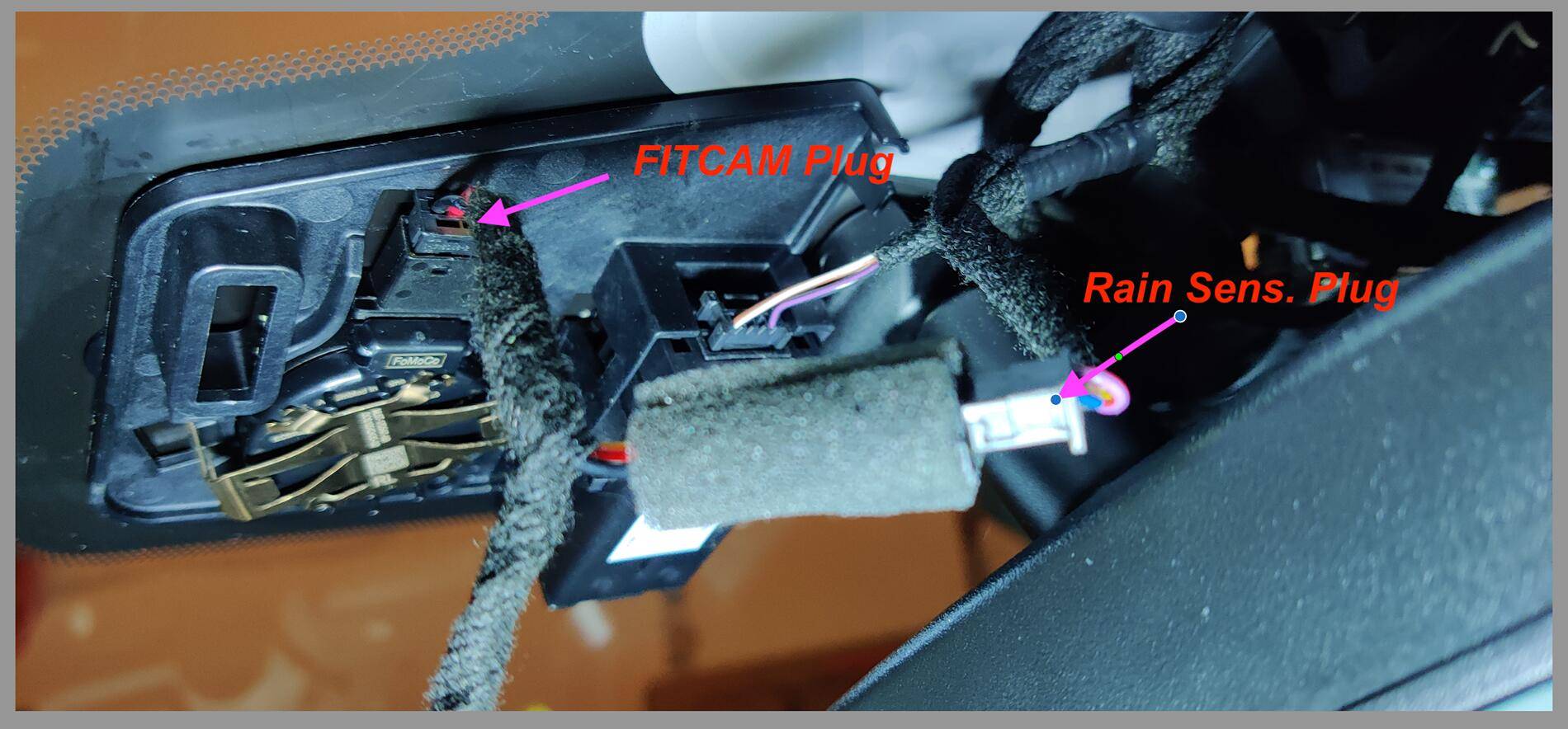

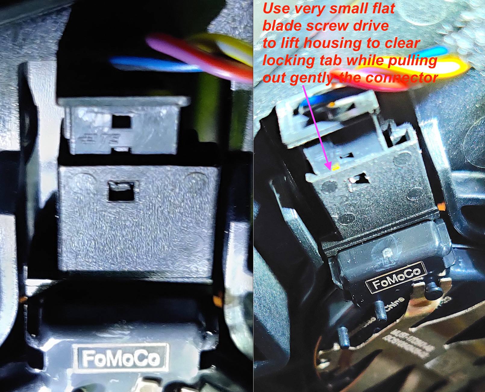

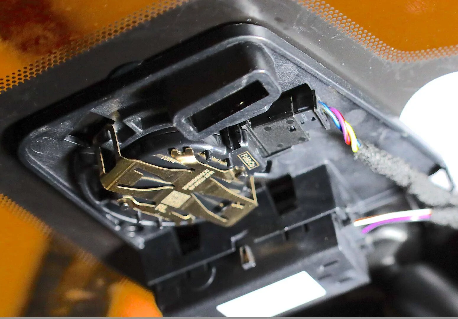

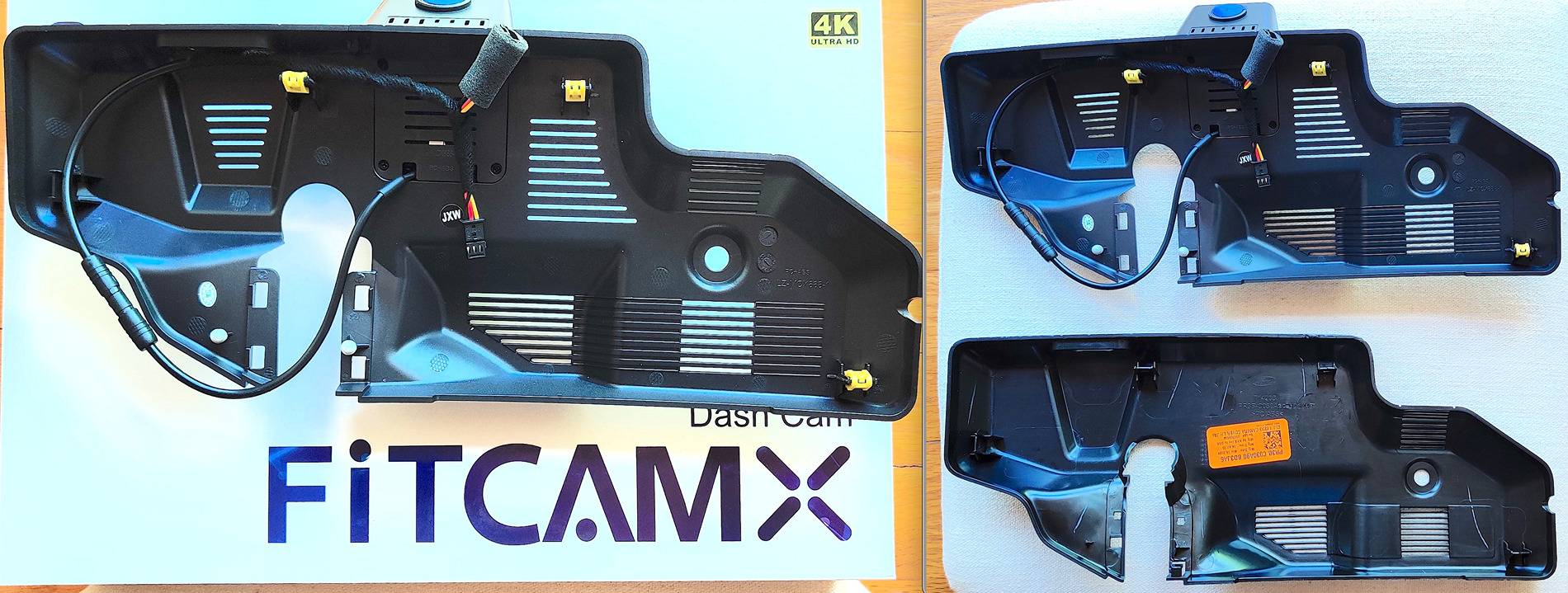

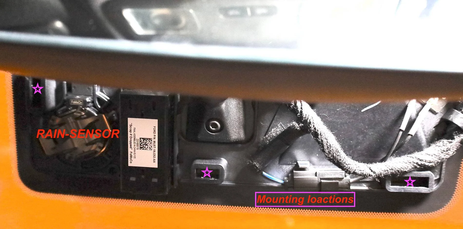

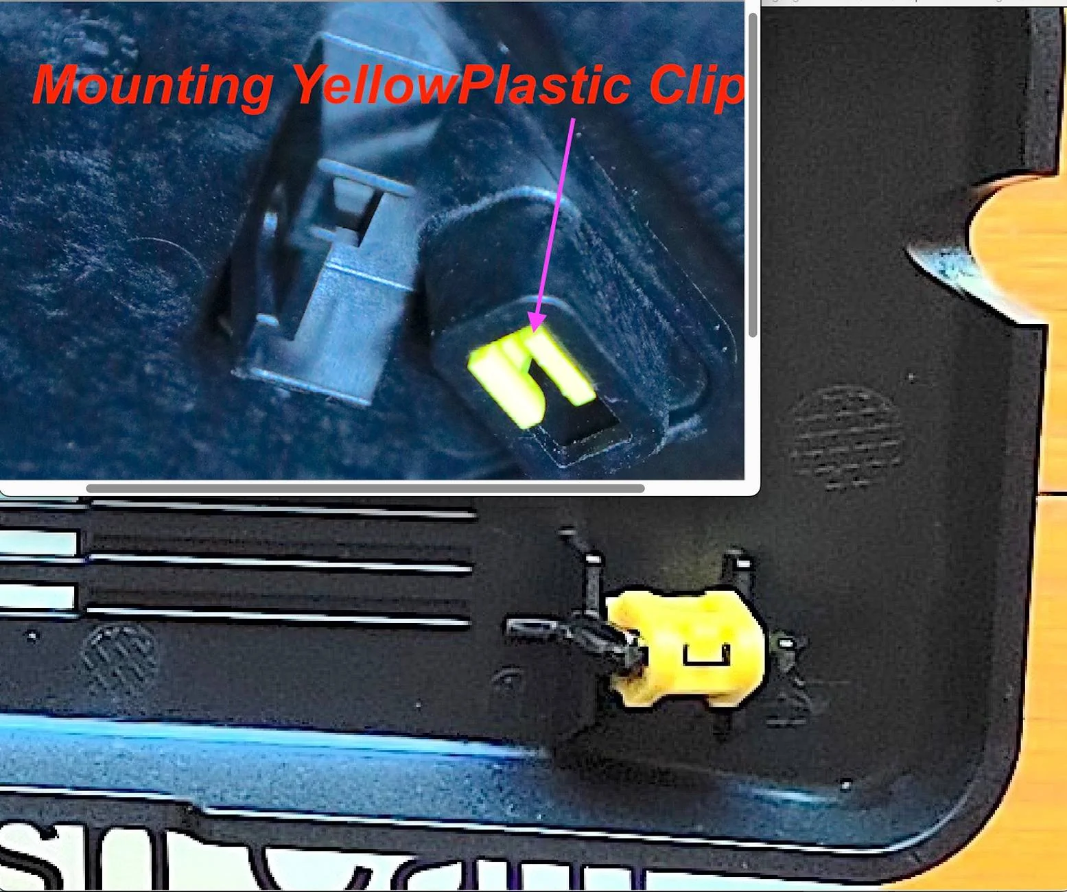

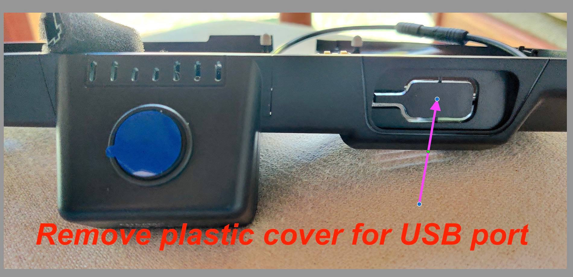

So I decided to install the FITCAM into my DH premium. It is an easy 2 hours of work as the extraction tool that come with the product to remove the cover is not very useful. Also removing the wired plug from the rain sensor requires jewel size screwdriver to get the plug out from holding to its locking tab. The four little yellow plastic clips are not easy to remove and transfer from the original cover to the FITCAM cover. The custom look and finish with no cables is great and worth the product purchase. Few pictures of installation attached for others that may want to use this product on the their S650 Mustang.
S650 Mustang The Dash cam thread USB PLUG HOLE-Detail
S650 Mustang The Dash cam thread Mounting Clips

Great to hear, and thanks for the pictures. This is the one I'll be getting as well.
Probably will have to disable the Gforce/crash detection with the subs I plan on putting in the vehicle. Car wash blowers like to set off the one in my truck.
