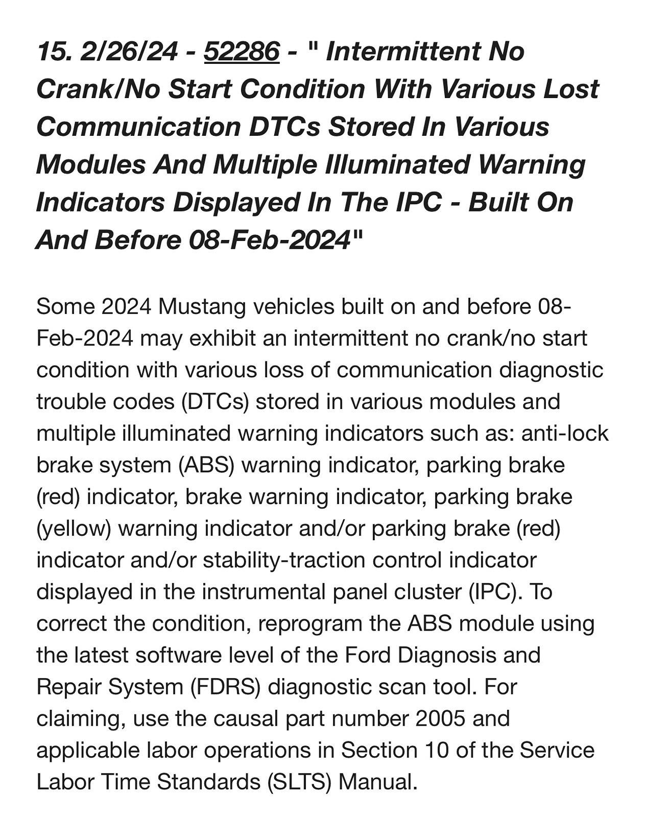

https://www.mustang7g.com/forums/threads/tsbs-ssms-and-recalls-for-the-24-mustang.157809/
Link will point you towards all the current recalls, Special Service Messages (SSM) and Technical Service Bulletins (TSB) for the S650.
It's not always the same thing, but fortunately, the fixes are often quick and painless. Thus far we've seen battery resets, battery replacements, ABS reprogramming/re-flashing and Gateway Module (GWM) replacements.

As odd as it may sound, the ABS module requires updating. There is a notification from Ford regarding this. Your dealer should be aware of it.

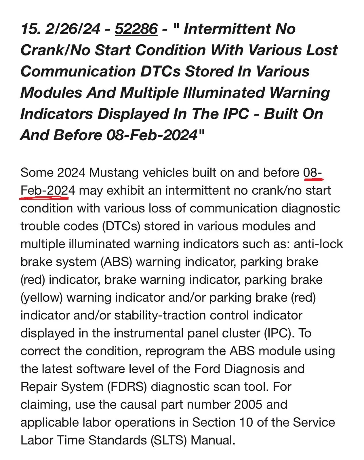

So what changed on February 8th 2024? What is the fix? Just a ABS module reprogram? Thought there was a battery issue related to this?
