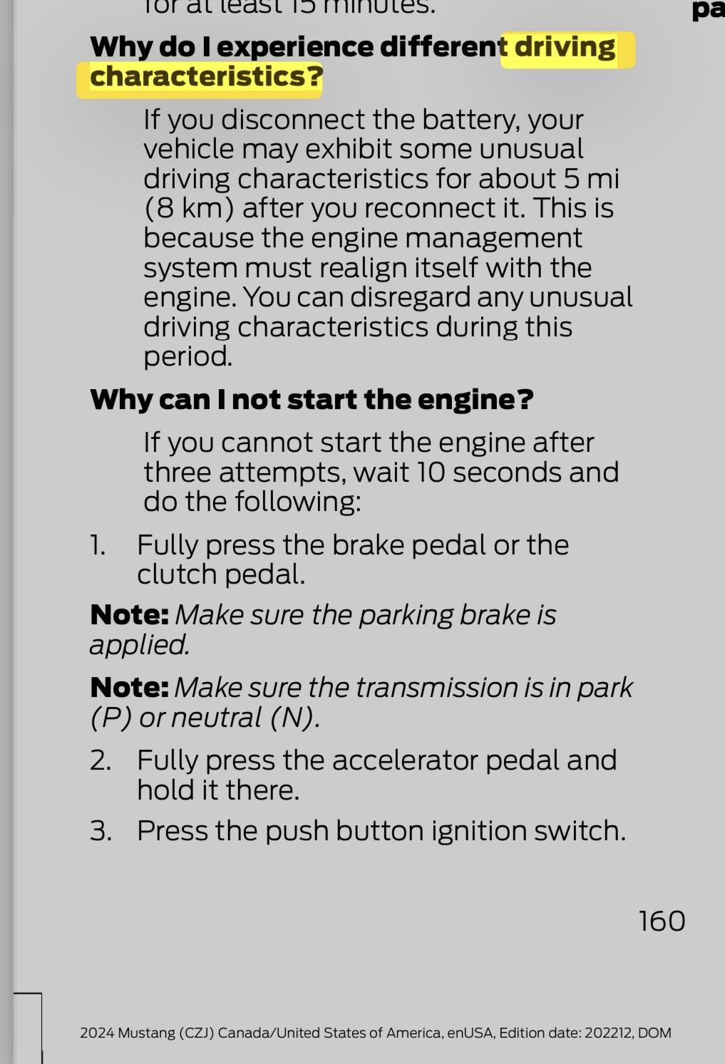

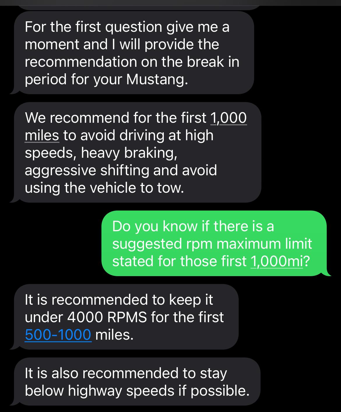

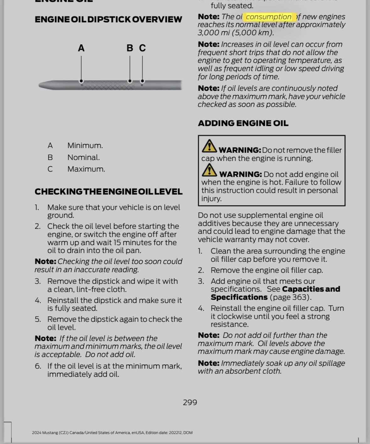

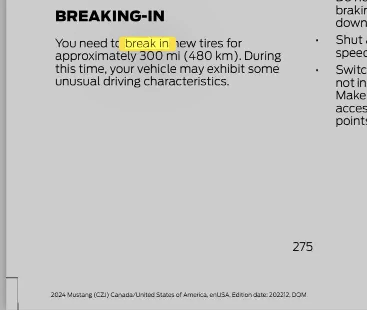

Besides the screenshots from the manual, Ford’s Mustang reps answered the break in question for me while I was waiting for delivery of my order.
S650 Mustang GT Break in Procedure IMG_7403
They also recommended varying the RPM as previously mentioned, not keeping it at one constant engine speed for extended periods. Those were my answers from the Mustang team , not from a dealer.
