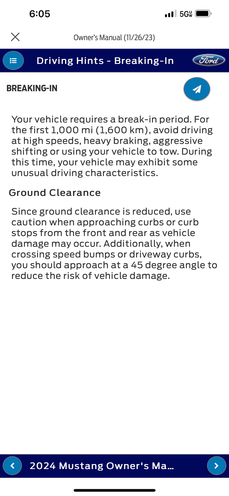

Thats what my dealer said on delivery, they said ford told us you don’t need to break in anymore, drive it the way you want, and don’t come back before 10,000 KM for the first service.
Am going up to 4-4.5k rpm, not more and haven’t gone WOT yet, not sure if i should while things are still settling in.
The ‘break-in’ period is not solely for the engine.

I know many say to drive it hard from day one and no break in is required. My thoughts are it’s probably wise to follow what is said in the owner’s manual. Right or wrong, I don’t figure taking it easy is going to cause any damage, but pushing it too hard from the start could. Will it cause damage to drive hard from day one? Maybe or maybe not, but better safe than sorry.
As said by others, break in is not just about the engine.

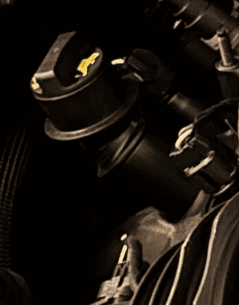

Out of interest can you see the cam profiles / followers through the oil filler cap ? or is it mounted to remote ?

Shame, that will take a borescope then, inline engines tend to have the cap on the cam cover and unless they put a splash shield in the way you can see the valve train of one cylinder.
Piston rings want a hard break in sure, but all bearings (crank, cam, rockers) do not. Cam lobes / followers will have a few faint lines on them early days which should fade over time. If they're permanent they had a hard early life and the hidden bearings could be the same.
I agree with all u said, quite weird that they removed that from the physical and pdf manual.
