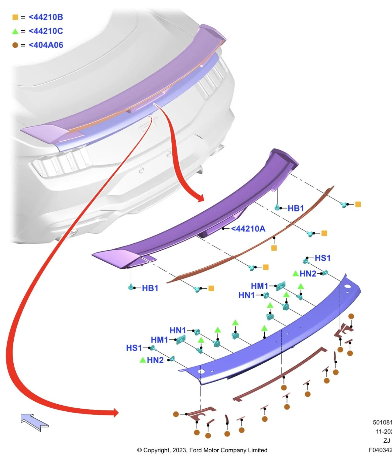

Check out part number: PR3Z-6344210-EC
Pic below, might help you with bolts
Yeah, I have seen a few people seeing theirs for quite a bit. I have also seen that image on the website too but was confused which spoiler was which since there is like 3 different variants of it.

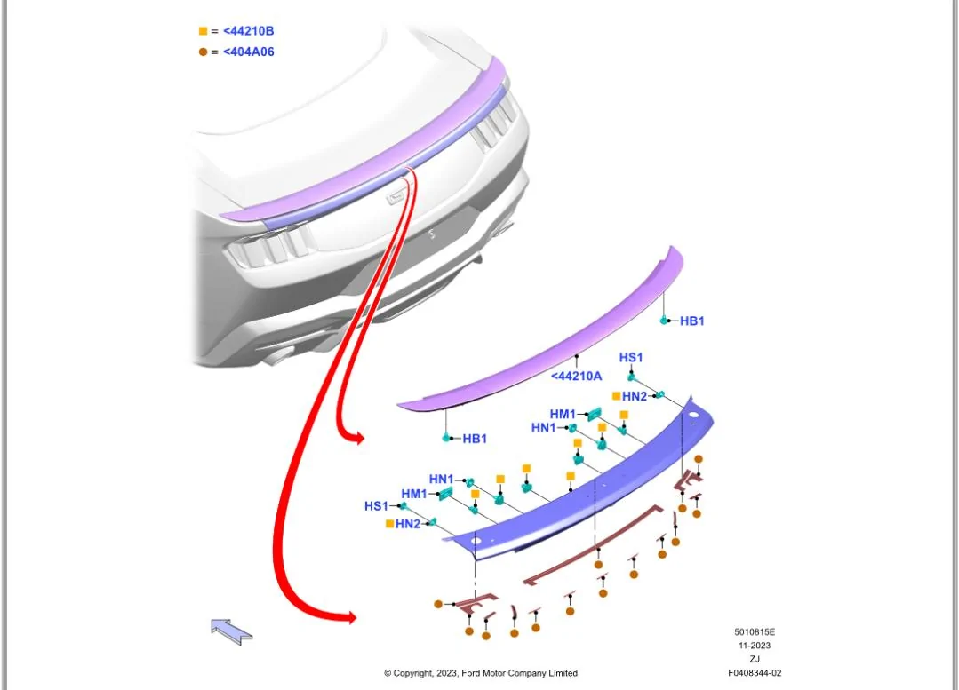

I think this is the pic for the spoiler I have on it now. From the looks of it it uses all the same hardware. From that I assume that I could just put the PP wing on.
yeah it should be a simple 2 bolts off, take the adhesive off, slap and bolt the PP wing on, they both use the oem spoiler decklid, same holes and all.
