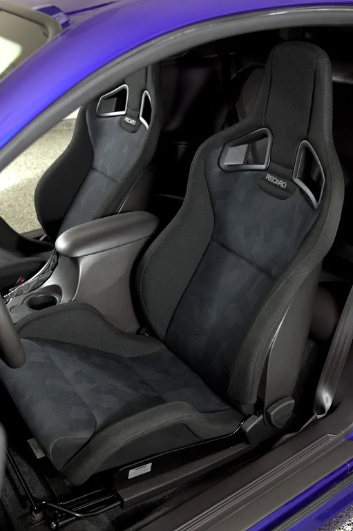

Race seats.
Honestly though, it seems like a lot of trouble and expense for minimal improvements.
That's true, but I will say, the Recaro Sportster seats have caught my eye
