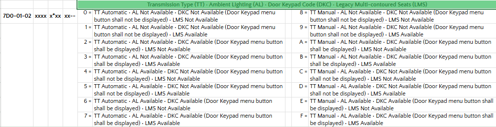

If you know how to pull the as-built data on your car, check what you have in this bit of the APIM. If the value you have in that location coincides with "AL not available", then that is why your ambient lightning is no longer there. If that is the case, it is a very easy fix.
S650 Mustang FORD: One of the worst 1767824109352-37
