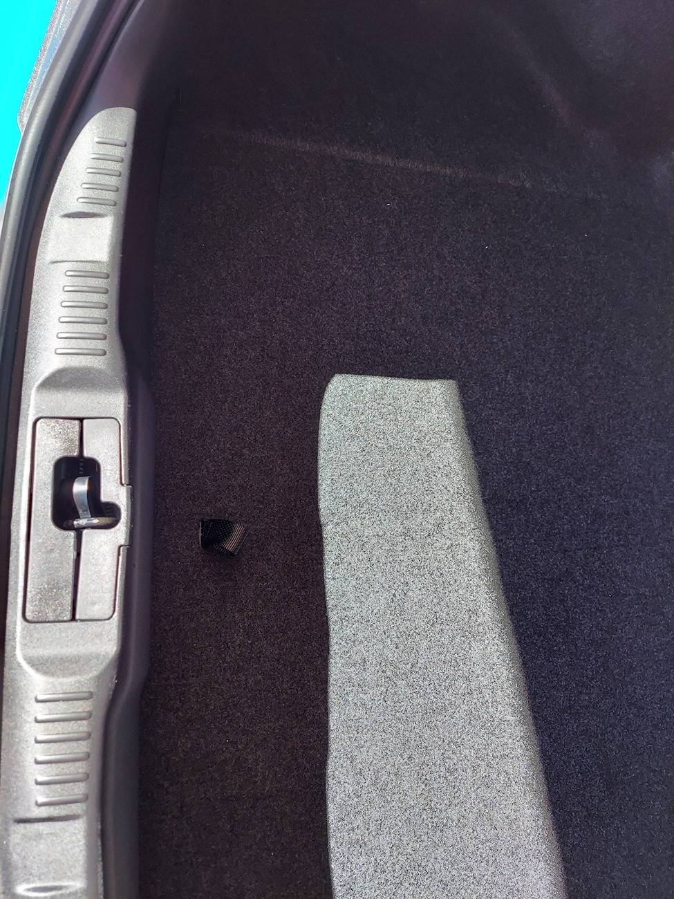

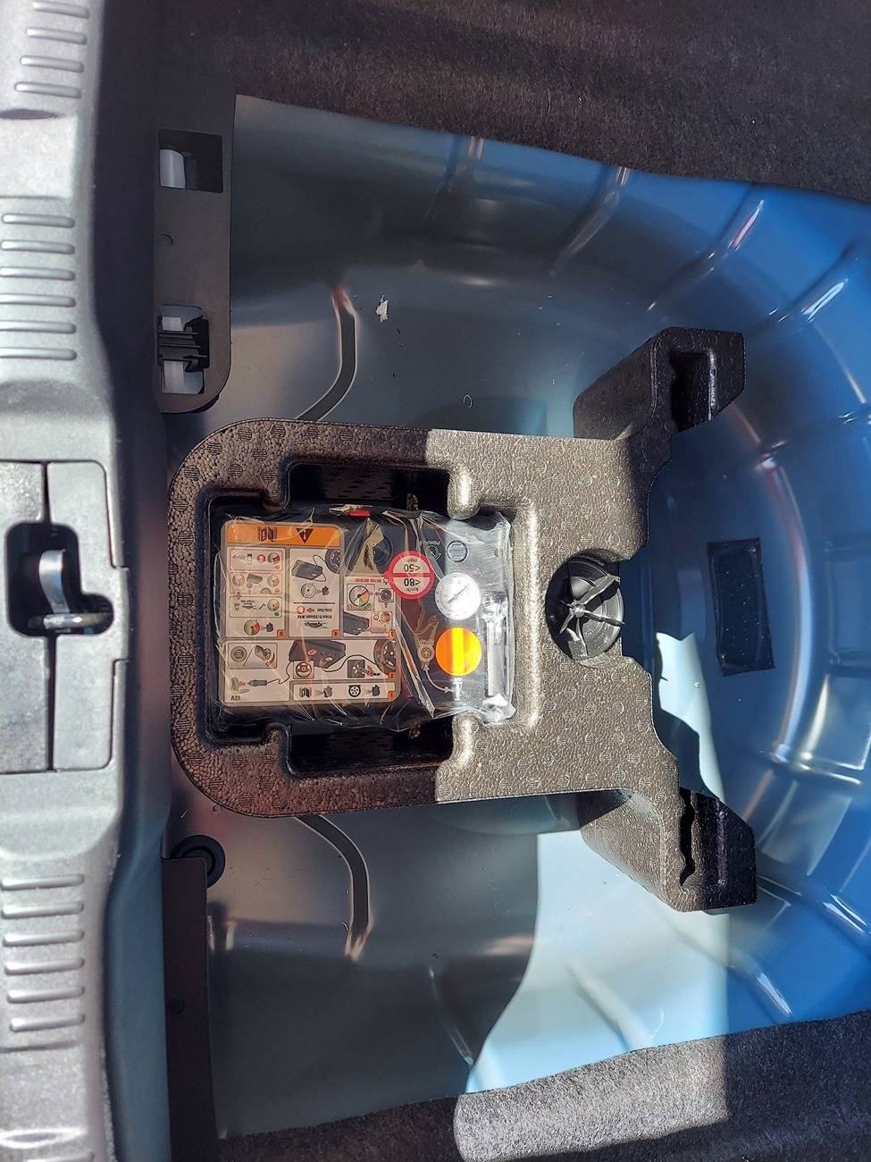

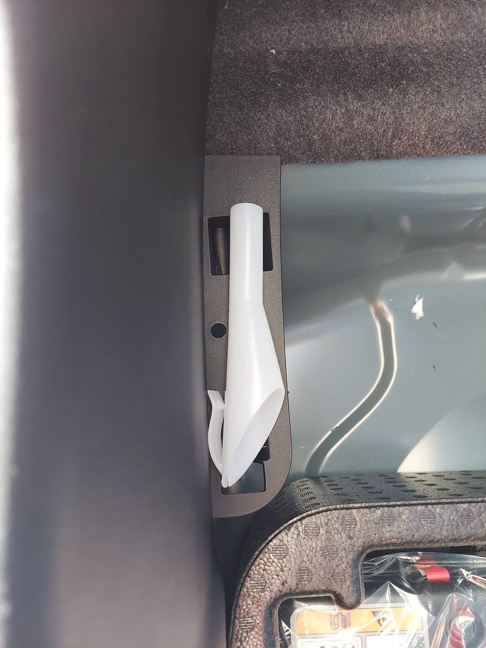

To compliment the discussion, it'd be a good idea to confirm a filler funnel exists, for anyone's car. Odds are it's there. But the driver might not be familiar with it and why used.
The cap-less system relies on two flaps. A nozzle of the correct size and length has to be inserted in the filler neck to open both. Gas pump, sure. But a gas can, as in when you've run out of fuel? Or a bottle of Stabil? No.
In the trunk of the Mustang, there is a small, white funnel; this funnel will open both traps. See images below.
There's a 99.9% chance 7G owners have one in the trunk.
I was aware of the cap-less system, but I did not know about the flaps until I attempted to add Stabil my first year; it did not go well.
S650 Mustang Easy Fuel Capless Fuel funnel 003
