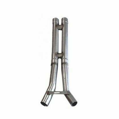

Does anyone have an H-pipe yet?

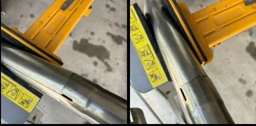

I decided to take the exhaust off because I only had a hack saw to cut the pipes. The biggest problem happened after that. I couldn’t get the h-pipe to fit over the oem pipes. I even called MRT and sent them pics and they didn’t know what to say. I ended up having to heat the h-pipe to get the pipes in far enough to clamp them. Then I had to remove the hangar mounts so I could get the assembled exhaust back on. Due to the tight fit the mufflers sit a little farther back now, which I know was an issue for s550s. Luckily the AE plugs are not rear-facing on the s650, so there shouldn’t be any rubbing/shorting issues. I guess Ford did a good job redesign the AE so we’ll have fewer issues. I got the AE plugged back in and no codes or problems so far after 2 short drives. It’s definitely louder than before too. My wife called it obnoxious, so I guess it’s about right 🤣

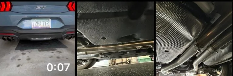

Just had the C&L h pipe installed yesterday on mine with active exhaust … sounds great a nice improvement across the modes!!!
