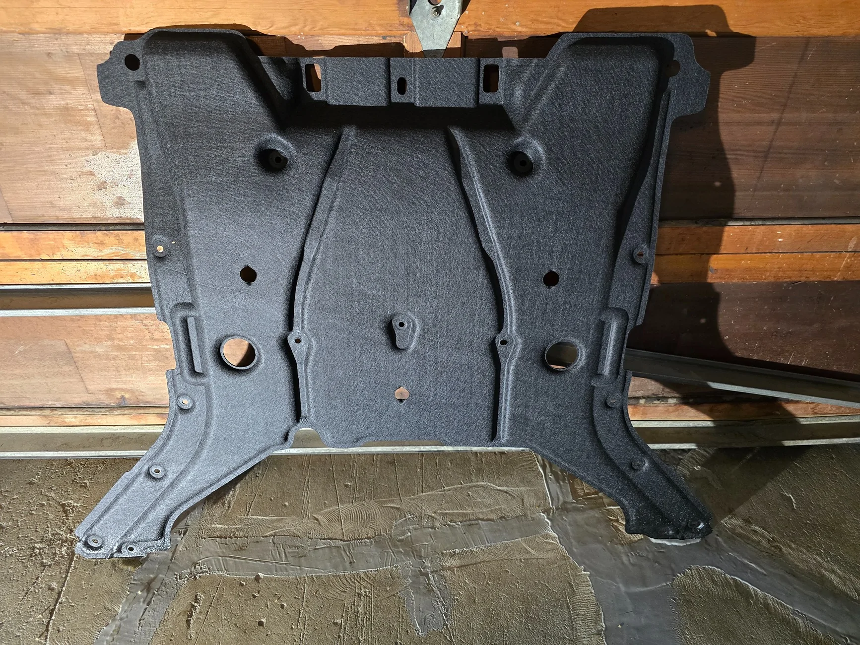

I've read that the S550 has a little door in the plastic/fiber bottom engine cover to access the oil filter but not our S650s. A good way to dissuade cheap-ass DIYs like me from doing it themselves so that the local dealer might get the business!?

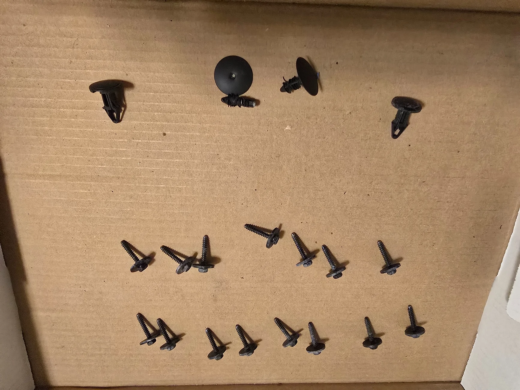

15 metal screws & 4 plastic fasteners-2 retaining clips & 2 push pins (ripped 1 in half).

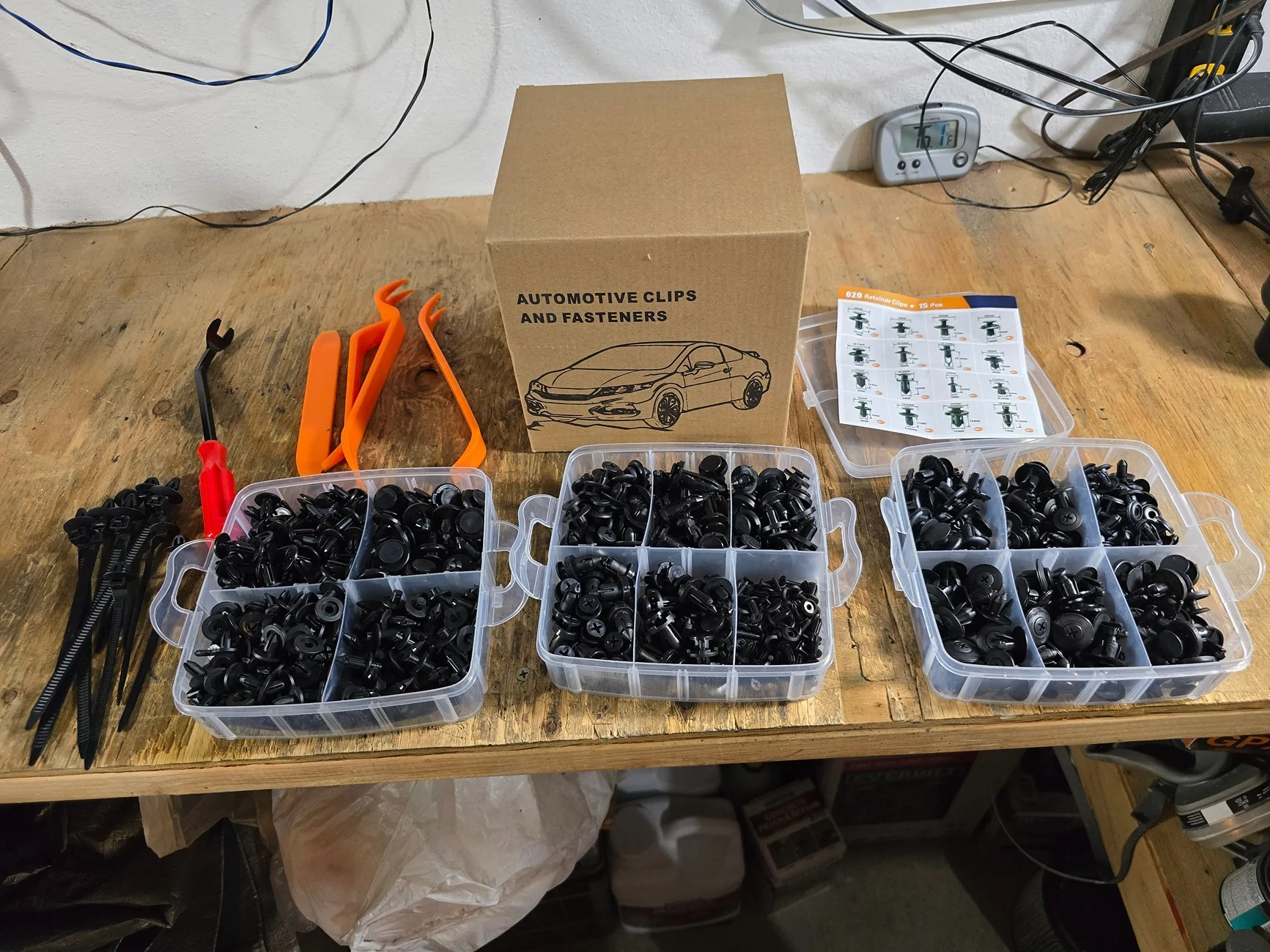

I got a fastener kit off Amazon a while back. I replaced 2 push pins with retaining clips.

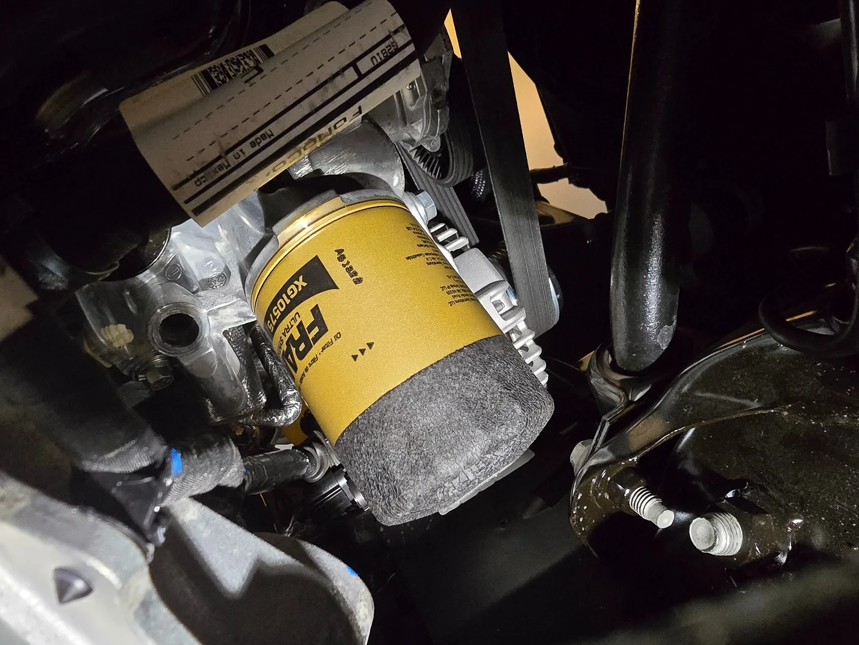

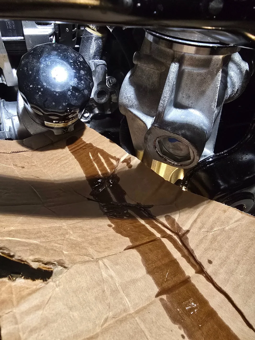

Pull factory filter.
S650 Mustang DIY: First Oil Change w/ Ramps 1000004037

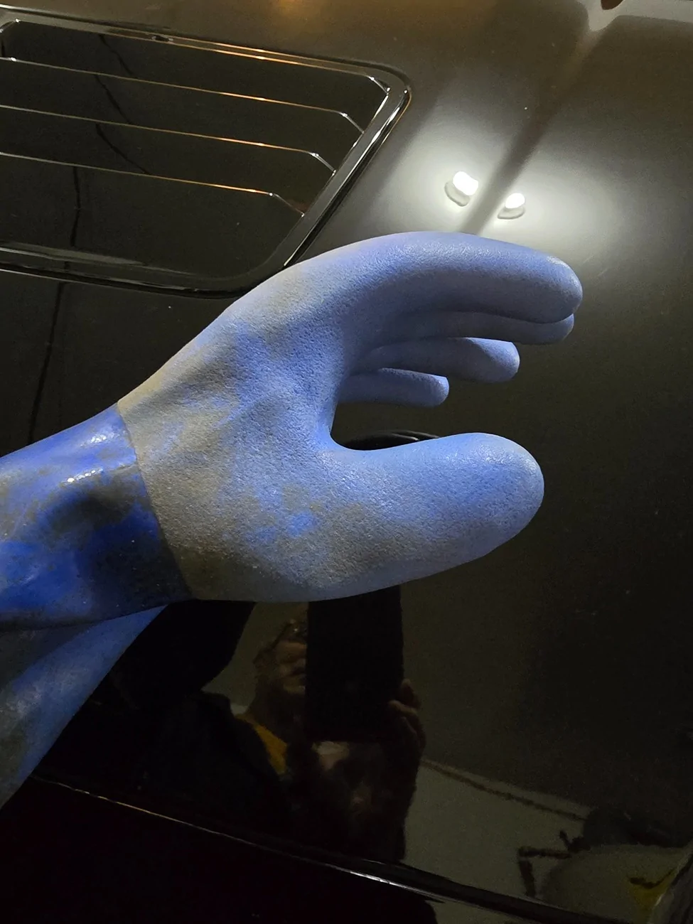

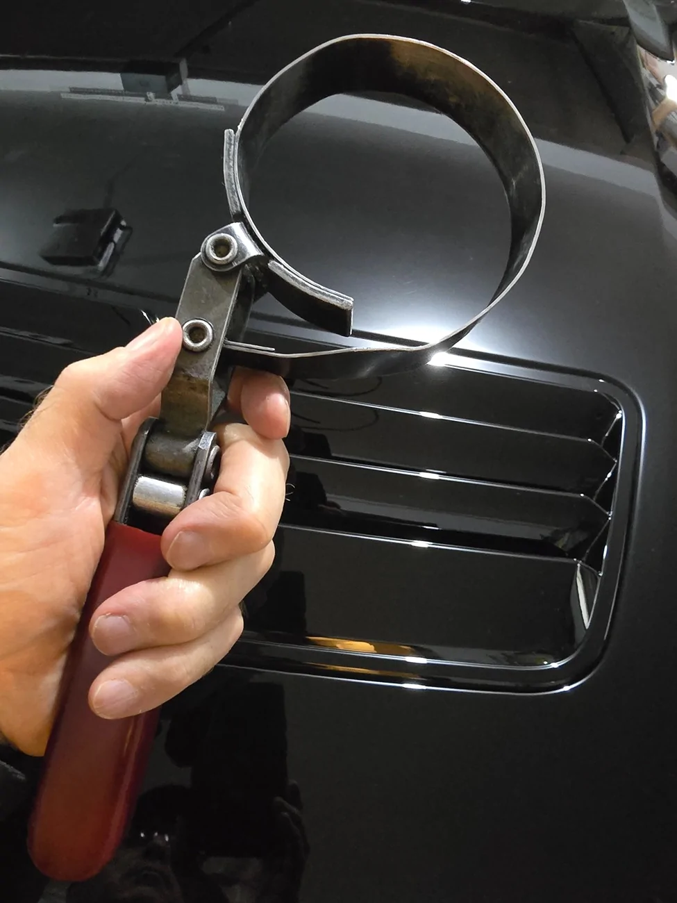

My old filter wrench is too big. Rubber glove gave me the grip to loosen.

6"x12" cardboard fastened with duct tape to keep oil off components.

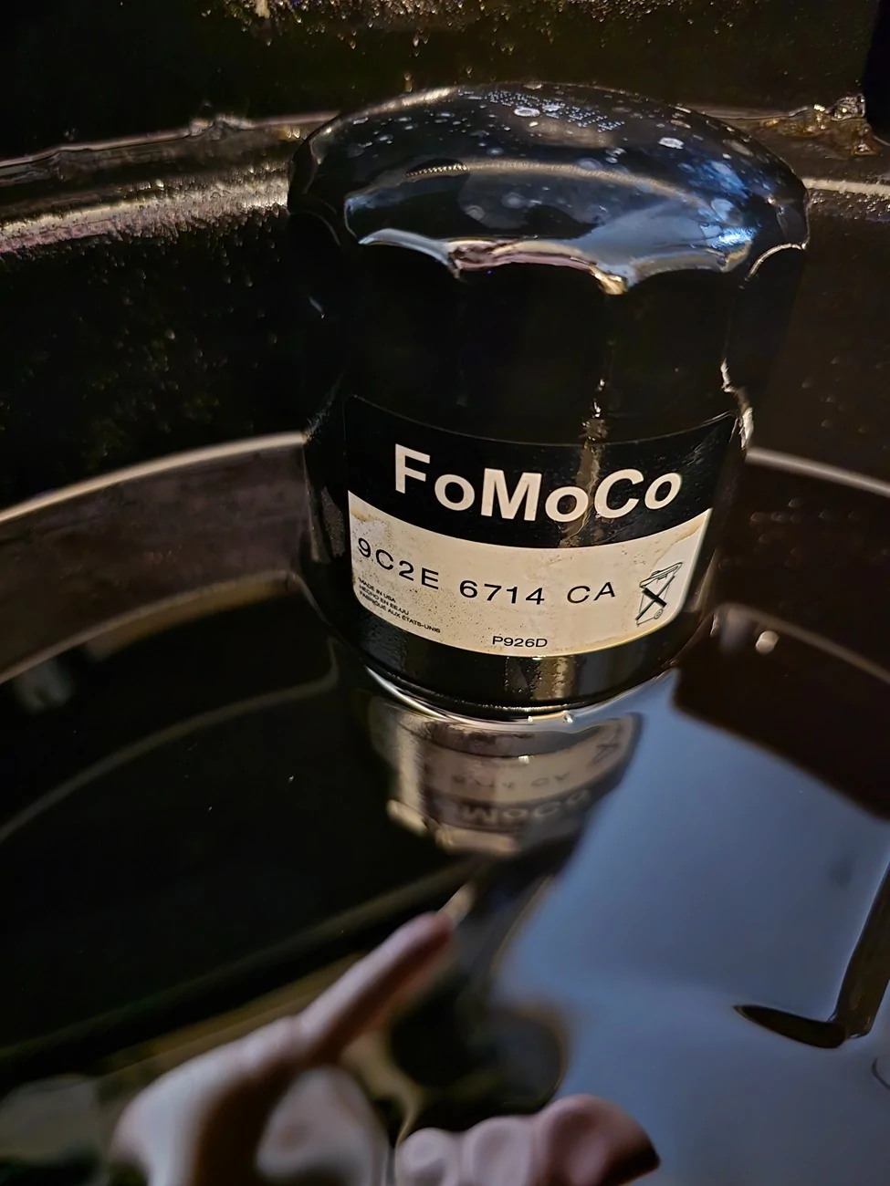

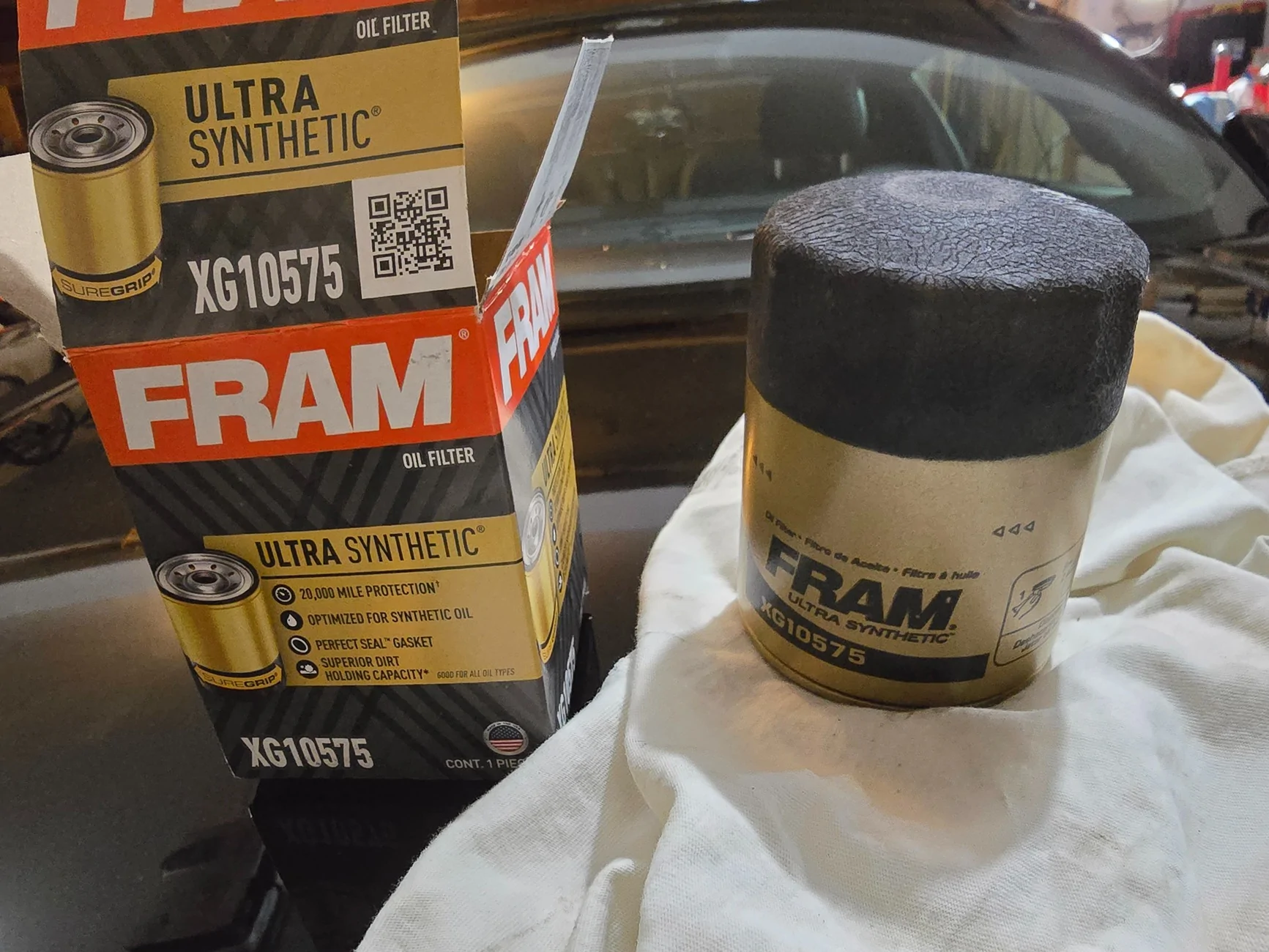

New filter.

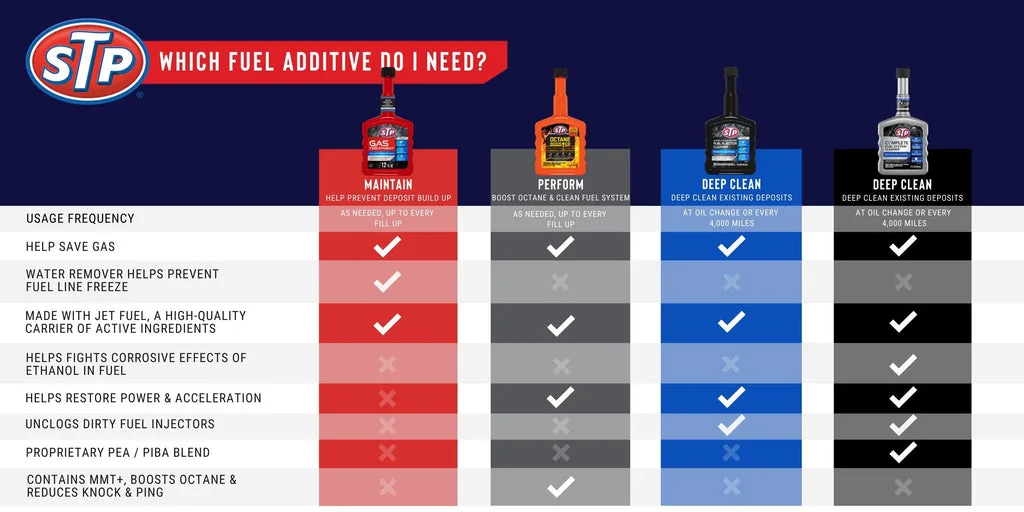

Excellent write-up and pics. I do question the need for the fuel injector cleaner. Unless you've got just horrible gas, you could cause damage* to the injectors using a cleaner too often.
* - or so I was led to believe from a very experienced mechanic many years ago
First time I've heard that! Plus I'm guessing he's only doing it every oil change.
I would suggest using a cleaner with PEA in it, though. So not that one.
Well, in hindsight, I was told this back in the 90s in reference to an 80s car, and with today's DI and presumably higher tolerance in the injectors and everything else, maybe using a cleaner every few thousand may be OK. Still, I never use one unless the car is experiencing performance issues. Old habits die hard.
2,822
2,809
I would argue it's more of a maintenance thing, if your injectors are dirty enough to be causing issues, pouring a bottle in the tank won't do much. They need to be removed and cleaned and put on a machine to test.

I do my own oil changes all the time with ramps. Change the push pins to the ones with pull heads much easier to remove and won't break, also did the same with the battery cover. I'm not sure about the Kirkland oil and using injection cleaner. I use Chevron with Techron already added and Pennzoil ultra platinum oil. Take a look at "The Motor Oil Geek" on YouTube he has some great videos.
