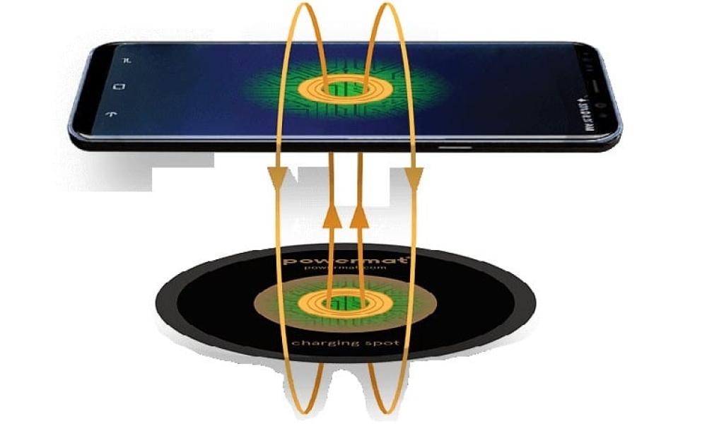

For maximum efficiency, the device's induction loop (referred to as the "antenna" above) needs to be centrally located above the charger pad's induction loop, and with minimal distance between. (ie; thick cases are bad).
S650 Mustang Proper usage of the wireless charger Wireless-Charging-Technology-1-1000x603
Poor alignment (or increased distance between) means reduced efficiency, which results in heat (wasted energy) and extended charging times.

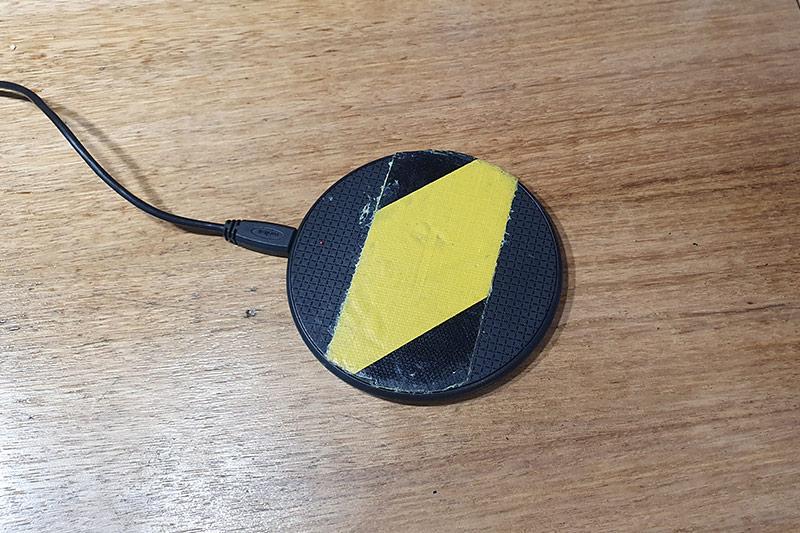

I do a lot of travel (domestic and international) with work and went through a phase of using a flat Qi charging pad in the hotel room, ultimately the same as what's fitted in vehicles.
S650 Mustang Proper usage of the wireless charger 20240211_113736
Ignore the hazard tape.
This was only to make the charger pad more visible so it wasn't left behind when checking out.
Black things tend to be harder to see when packing your junk up, and easily left behind - ask me how I know. :facepalm:

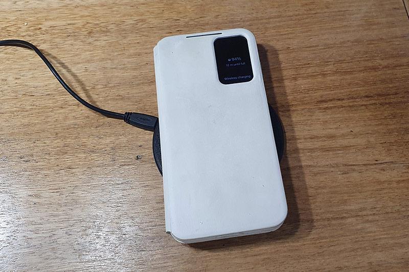

All of these charging pads are finicky with device placement.
Off by a cm or so (½" for you Merican folks) and it stopped working.
S650 Mustang Proper usage of the wireless charger 20240211_113732

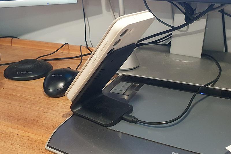

These desktop Qi chargers are great (I have 5 scattered over the place), but aren't suited to a vehicle center console.
(The device becoming a hazard under hard acceleration/braking)

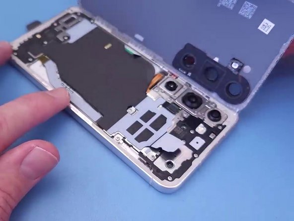

Trial and error placement, or try Googling for a "tear down" of your specific phone model.
In my example, a Samsung Galaxy S23+, we can see the induction coil is horizontally central, but less than half way up vertically. Confirming that some length-ways offset is required on a flat charger pad.
