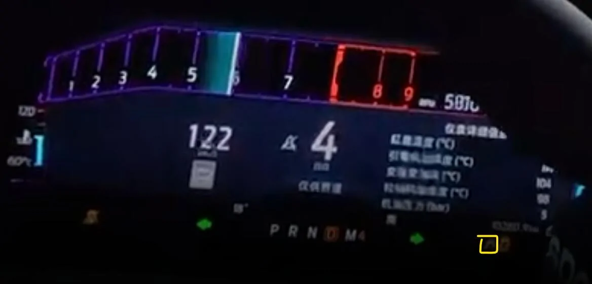

Mustang 2018 GT PP1
Track problem help!~
My Dark Horse on the track, when the fuel tank is less than 75%, there will be insufficient fuel supply after turning left at high speed. refer the video.
Has anyone encountered a similar problem? and where is the issue form?
Stock car whit any modified

Can so I have. That sou ds horrible and must be very disconcerting?
Also, where are you? That display showing tire temp and pressure is not available on my Dark Horse!

that light does flash in the first video when your exiting the corner do you have the traction control fully off?
i believe you hold the button for like 10 seconds to fully turn it off
track mode or just pushing it i believe just disables traction control
holding it disables Electronic Stability Control (ESC) or something like that
its hard to make out but i think that is it

...Also, where are you? That display showing tire temp and pressure is not available on my Dark Horse!
looks to be China, where 2024 Mustangs are fitted with DeurOS made by Baidu instead of SYNC 4. plus it says on his profile "Location: China". also i agree, i would love to see my tire temps. its also interesting that despite having an auto, he appears to have launch control
I live in China, this is Ford's export version of Dark Horse to China
tire temp is a hidden function, adjusted by software similar to forscan

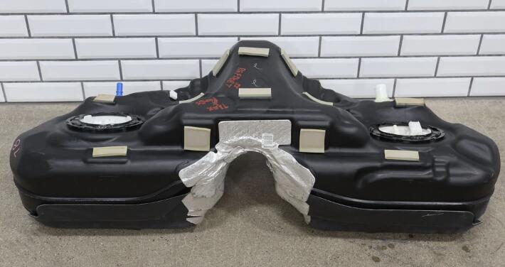

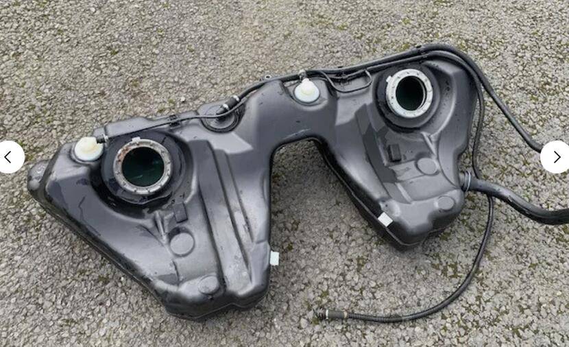

keithwalton
Feb 17, 2024
185
175
N/A
2024.5 Dark horse, SLC 250d
Wouldn’t the fuel show empty if that’s the case?
It might drop a little but won't show empty. Fuel senders particularly when used on a digital dash are heavily damped to avoid the effects of cornering / hills on the fuel level reading.
They are also act over a much larger area than the pick up.
I'm also not familiar with the mustangs tank design. But if on a 'track ready' car they are only using a single pump with a single pickup then that would be a fail on there part.
Most performance vehicles will use either dual pumps (my E60 M5 had 2) or multi pickups on one/two pumps to avoid the issue.
One car i owned had a 'saddle tank' where there was essentially two smaller tanks either side of exhaust / prop shaft that were interlinked and had a pump in each side that could each pull from both sides.
Edit quick google it was the M5 that had the saddle tank.
More googleing and it looks like ford have gone the same way, or at least provisioned for it.
Top is E60 M5, bottom is S550
4,713
2,573
