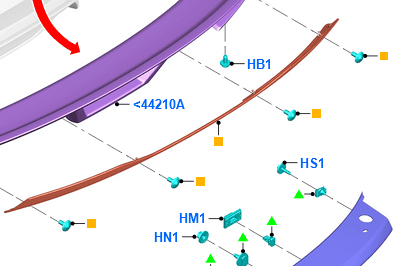

From page 321 of the 2024 Mustang Owner's Manual: "Note: The Gurney flap comes with longer size bolts to install it onto the rear spoiler..."
The dealer installed my Gurney flap. And I suspect they tossed the shorter screws. Several Mach owners have reported missing one set or the other.

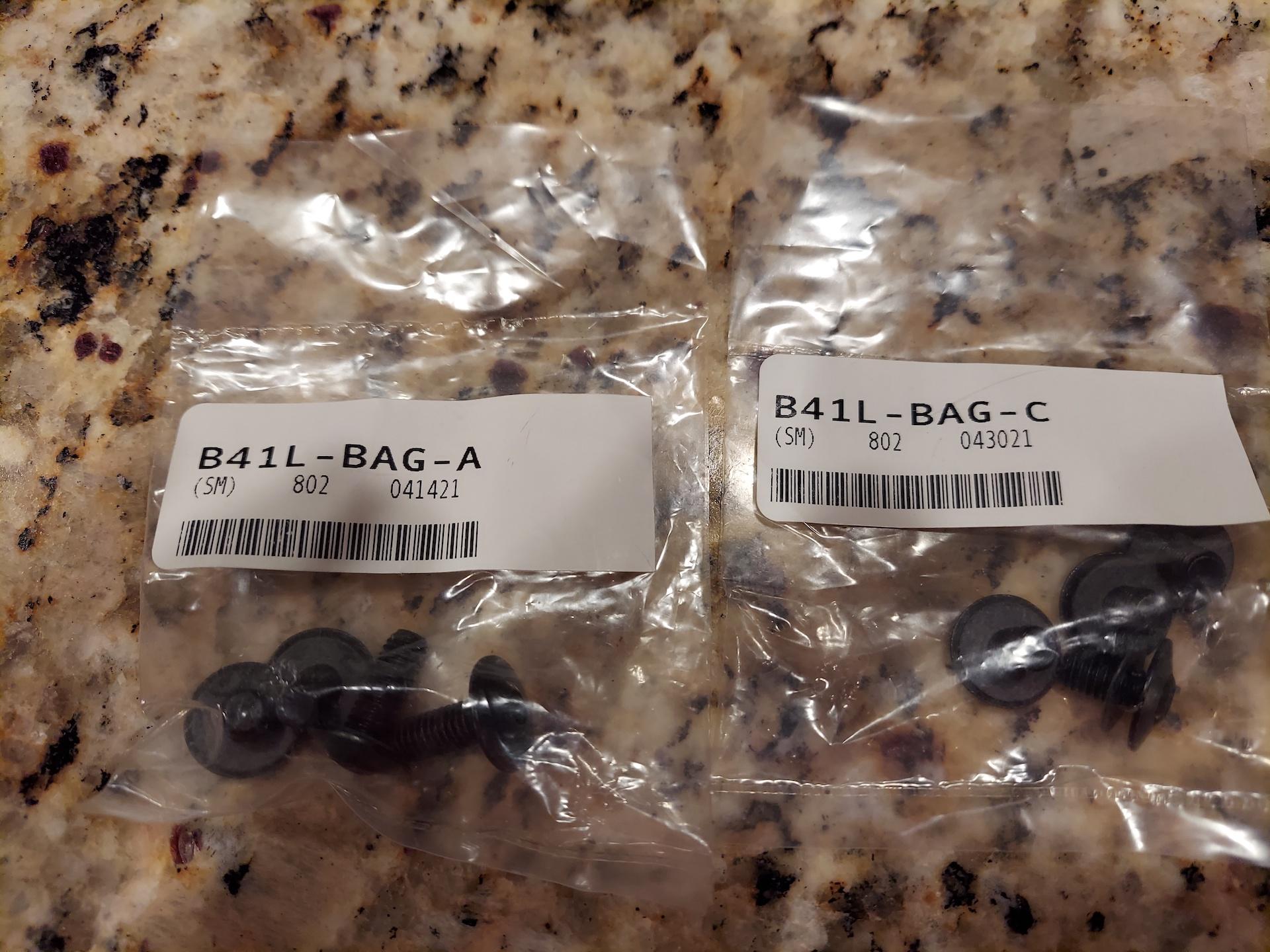

I understand physically it could all be different with the DH. FWIW, the PN#s for the Mach screws.
Fairway Ford Parts.NET
KR3Z-63442K03-A is the Ford PN# for a kit which supplies both sets of screws.

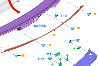

yeah, they changed that for the DH, it's one set of bolts that are always in the wing.
S650 Mustang Dark Horse Handling Package Gurney Flap: Longer bolts included? 1699001459122
the bolts only come with the gurney flap and all together cost an outrageous $1161.83 retail
