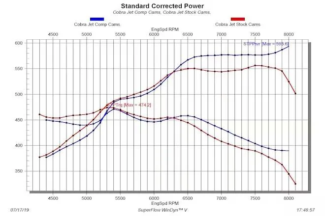

It's not much more than the stock engine made with a cobrajet intake, headers, e85, and tune

Cams were only worth it on an S550 if you had a Cobra Jet manifold and full bolt ons and supporting mods. I had a GT30 manifold and did cams twice (Comp stage 3 cam, then down to stage 1) and revved the engine to 8,000 rpm, and it really wasn’t worth the hassle or cost. The stage 3 cams lost power all the way until 6K rpm, and then only picked up a peak of 11 hp. The stage 1 cams were better for the GT350 manifold as the power was closer to stock in most of the rev range (ie, the car didn’t lose power) and they picked up more on the top end (but still not enough to justify doing them, IMO).
if you want to stay NA, that’s fine, but obviously from a cost to power standpoint a blower is just a much better deal. Regardless, you can’t tune the S650 for cams right now so it doesn’t matter. And OP, cams on these cars don’t sound any different than stock.
