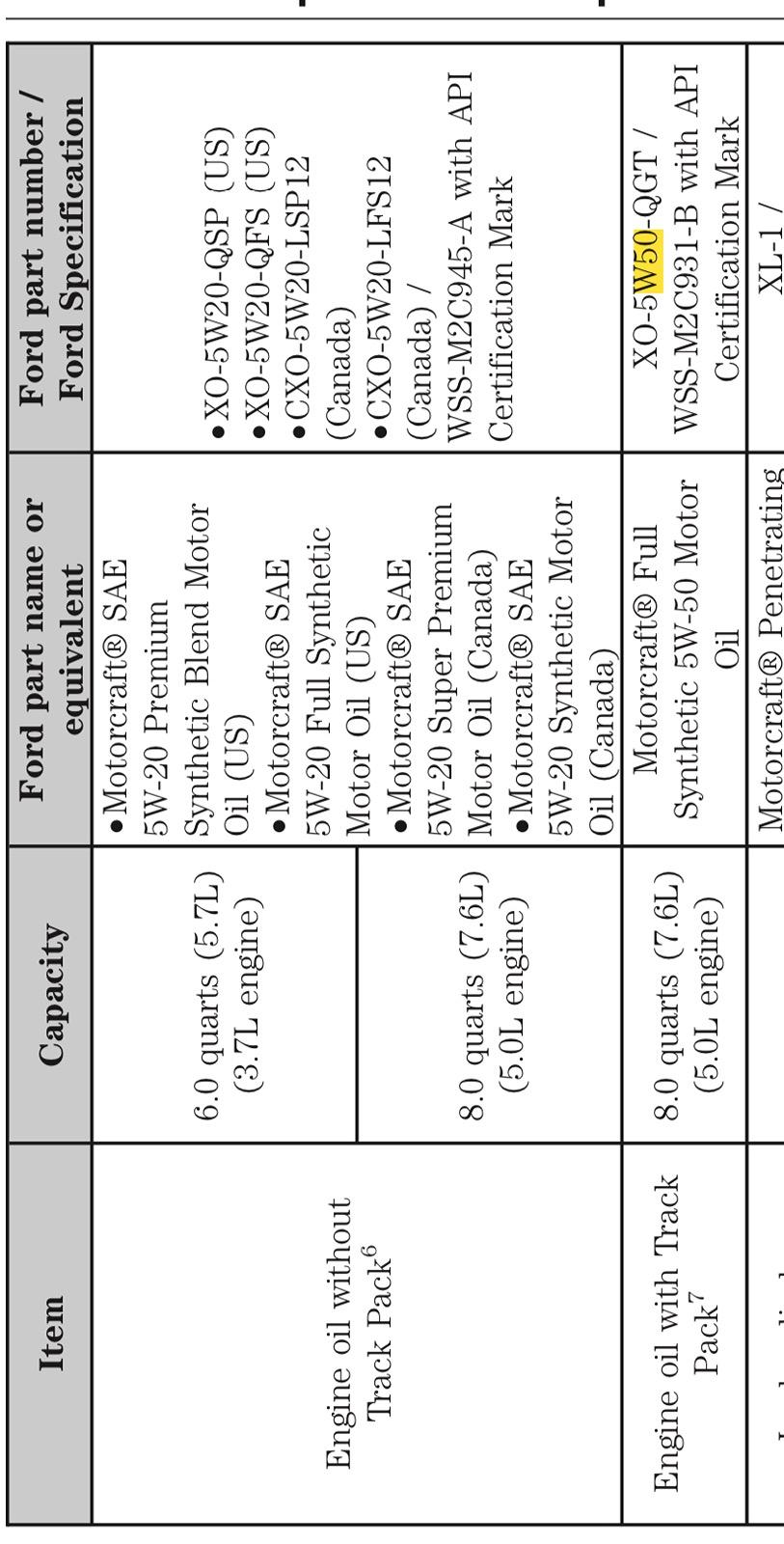

Also, doesn't it count for anything when those same Ford engineers recommend a different viscosity oil when running the car hard?
I reviewed my owner's manual. I see different viscosity recommended based on anticipated external temperatures during operation, as well as a revised schedule as to when to change your oil based on severe duty, but no recommended change in viscosity due to "running your car hard".

Varies over the years. Track pack etc cars with the exact same engine as the regular GT
something similar is in the ford racing supercharger instructions
Irrelevant. Your S650 came with a 2024 owner's manual. Follow that one, not one from a different car from a different year.
