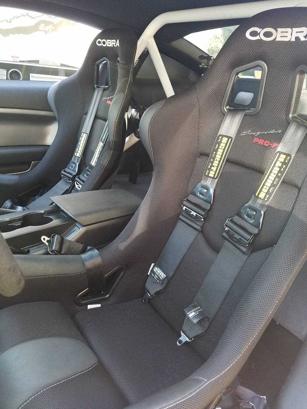

After much contemplating what route to go with the setup of my car interior, I settled on the following for the track.
1. Watson Racing 4 Point Cage
2. Cobra Nogaro Circuit Seats with PCI slider mounts
3. Schroth Quick Fit Pro harness with sub straps (6 point)
4. NecksGen Rev2 Carbon HNR
5. Element fire extinguisher
I finally completed the install this evening. None of the items were that difficult to install by myself, but it certainly would have been more work getting the cage installed if I didn’t have a lift. I’m very happy with the way everything turned out and am excited to head to Barber at the end of the month.

I assume you did not do anything to defeat the airbag light, so you are getting a light in the dash?

You are correct. I have not done anything to defeat the airbags, and I do get the airbag warning light since I have none of the seat sensors or seat airbags installed.

Thanks for the suggestion. I’ve seen those, but I haven’t seen anything like that for the S650. Plus, there is possibly a lot more that would have to be done because not having the factory seats also means disconnecting the sensors for the seatbelt as well as the seat position and occupancy. There could be others as well, but I’m not certain. I figure in my car’s current state, one of two things would happen with the airbags.
1. They don’t work at all. I find this unlikely, but this would actually be fine with the harness, helmet and hnr.
2. The airbags deploy, including the front airbag at full force thinking I’m not wearing a seatbelt, vs a reduced force as would normally occurs with a seatbelt. With my seat position, 6 point harness and hnr, I don’t expect my body would contact much if any of the front airbag. The rest of the airbags I don’t see as there being any issues with deploying while wearing a helmet.

yea, I never used the plug either, I just remenber it being suggested years ago when I went to race seats. covered the dashlight with a piece of black tape

Keeping yourself from having to brace with your knee in the apex will be the most noticeable improvement. Also on track you will be more focused on the line as you won’t be bruising your knee every session! Lol

You also now have a great location to mount your choice of recording device.

I should mention that this is in a 2007 S197, not the s650
I also have kept my stock seatbelts but have the resistor to take out the warning in the dash. I also have replaced my steering wheel with the Sparco.

On the way home after my first track day, I wondered why my left knee was so sore. I didn't even realize I was using it to brace myself while making the mostly right turns at The FIRM. LOL
