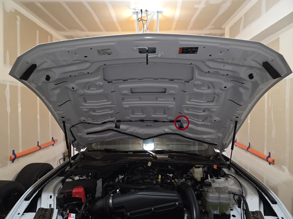

Both wiper nozzles wouldn't spray. Pump audible, no visible leak at tank or in engine compartment.
Fix: remove hood liner (pop out Christmas tree pins with trim removal tool). Then activate the wiper fluid, observe for fluid drips. My red circled hose connection was disconnected and dripping. It's a plastic C-clamp type connection. Twist the clamp (either direction) to unlock it. This allows you to plug in the hose properly, then clamp it on locked again.
S650 Mustang Brand new car: wiper fluid hose was disconnected 20260410_161912
Looking back, I noticed the salesman repeatedly run the wipers when he first got in to pull it out of the parking area (leftover '25 model, windshield was covered in a thick layer of dust). "Why not squirt some wiper fluid?" I thought. Now I know he probably tried, it just didn't work.
