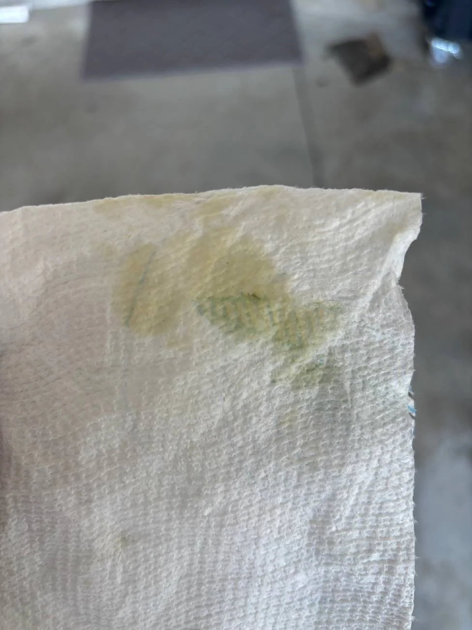

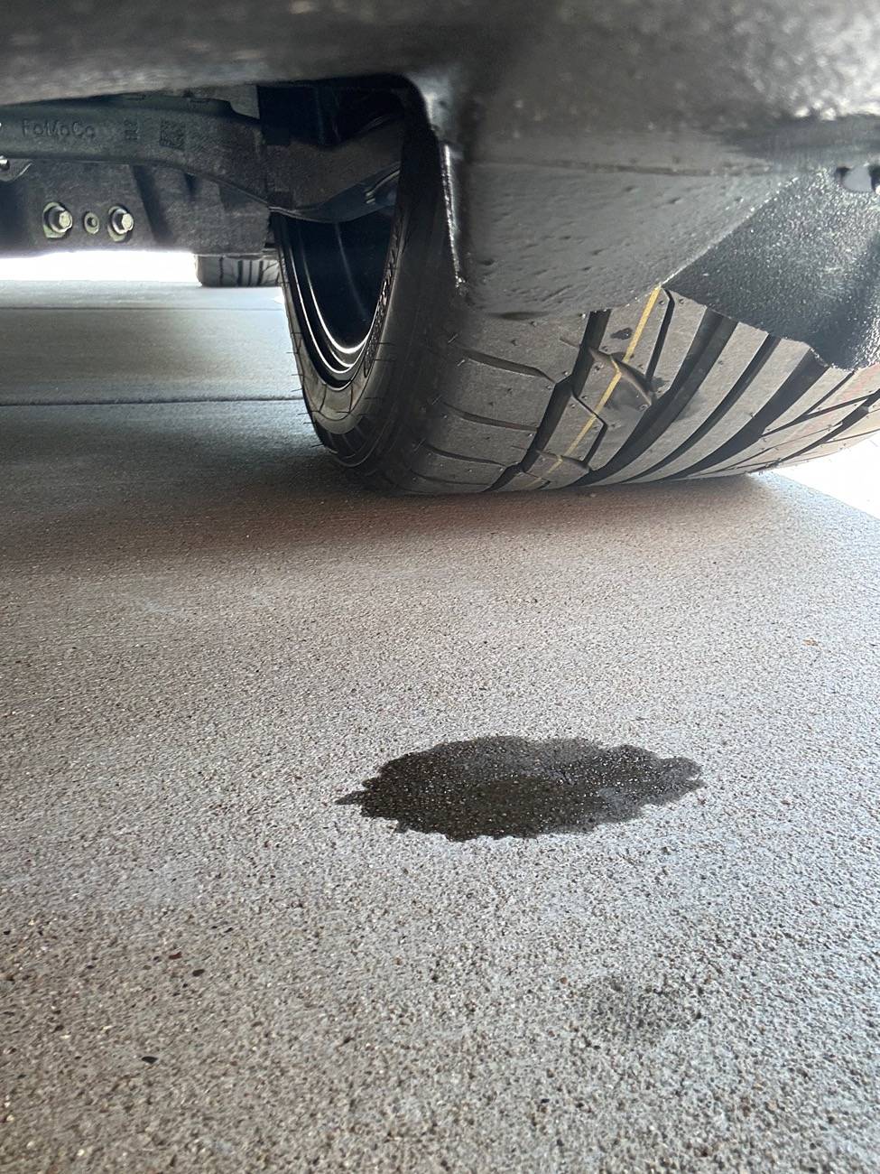

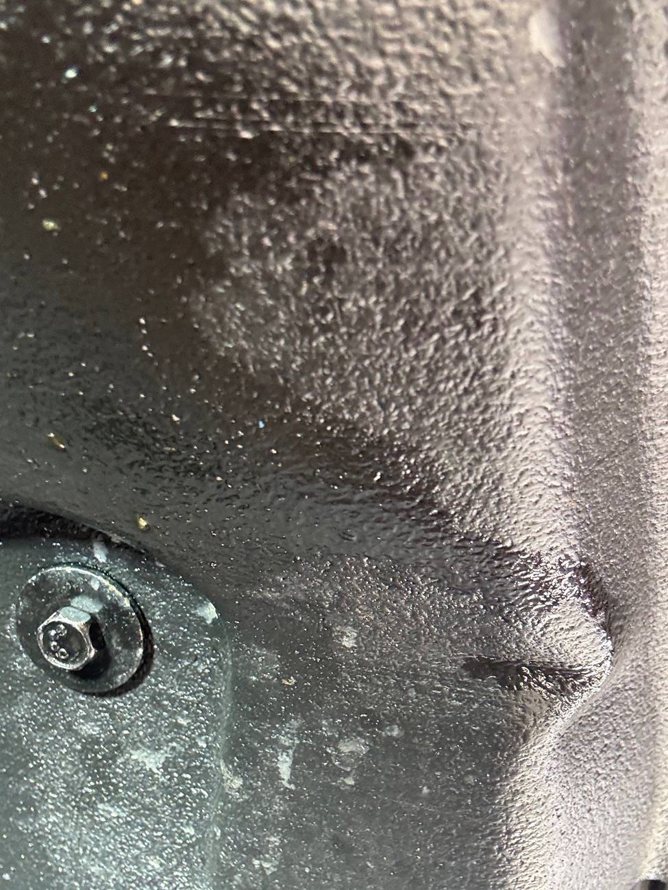

Hello all! New 2024 GT bought this afternoon- found something leaking on my driveway. Towed this evening back to the dealer. The leak is coming from under the front bumper driver side between and bumper and the front wheel. Fluid is kinda yellow and pretty slick/ greasy. Pics attached. Appreciate anyone’s input on what this could potentially be? Thanks!

Responded to you on reddit: (engine) oil from the oil cooler in front of the wheelwell.
I would lean more toward coolant than oil. Oil usually doesn’t get sticky

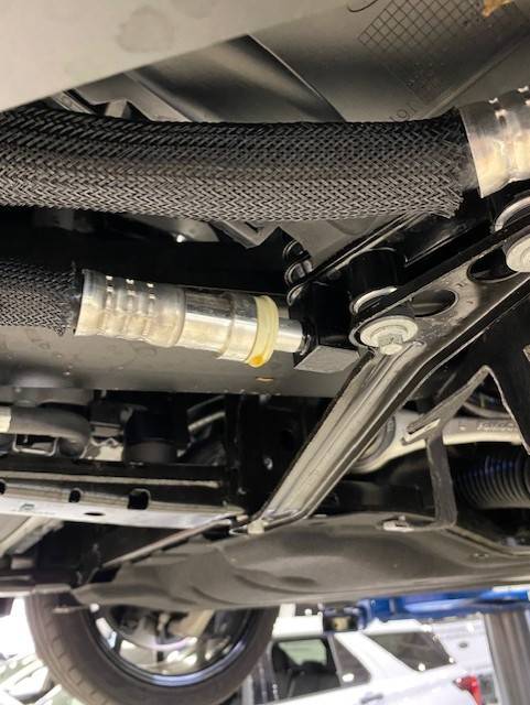

Just got this photo from dealer. He says oil line leak. How big or small is this fix? Thanks

Just repair and replace the line. Top off fluids. In terms of failures, this is easy to repair and it's good that you caught it early.
