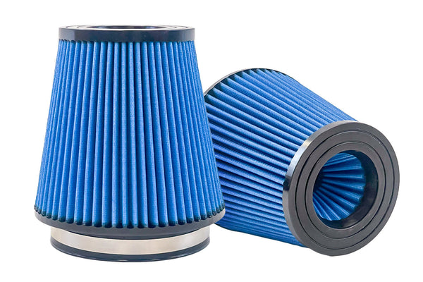

Mehhh, I went with the Steeda Pro Flow Air Filters and change them out every 3-6 months depending on how much I am driving. Bought a 2nd pair so when I replace the ones in current use, I can let the washed ones dry for an extended period. Always have a pair on standby. Cost wasn’t a concern. YMMV …
Agreed. I've run Steeda filters literally since I can remember. Have a second set, wash them by soaking in warm water with their cleaning solution. Put them in the sun on shop towels for a day. Conservatively coat each pleat with new oil. Next put them on a shop towel below and on top, first with the small end down, then flip them with the small end up for a day on each end. Gently rub the rubber ends with a cloth in mineral spirits. I do this process about every 10K miles, I always have a clean set on the shelf. I've never had a spec of oil in the intake or MAF.

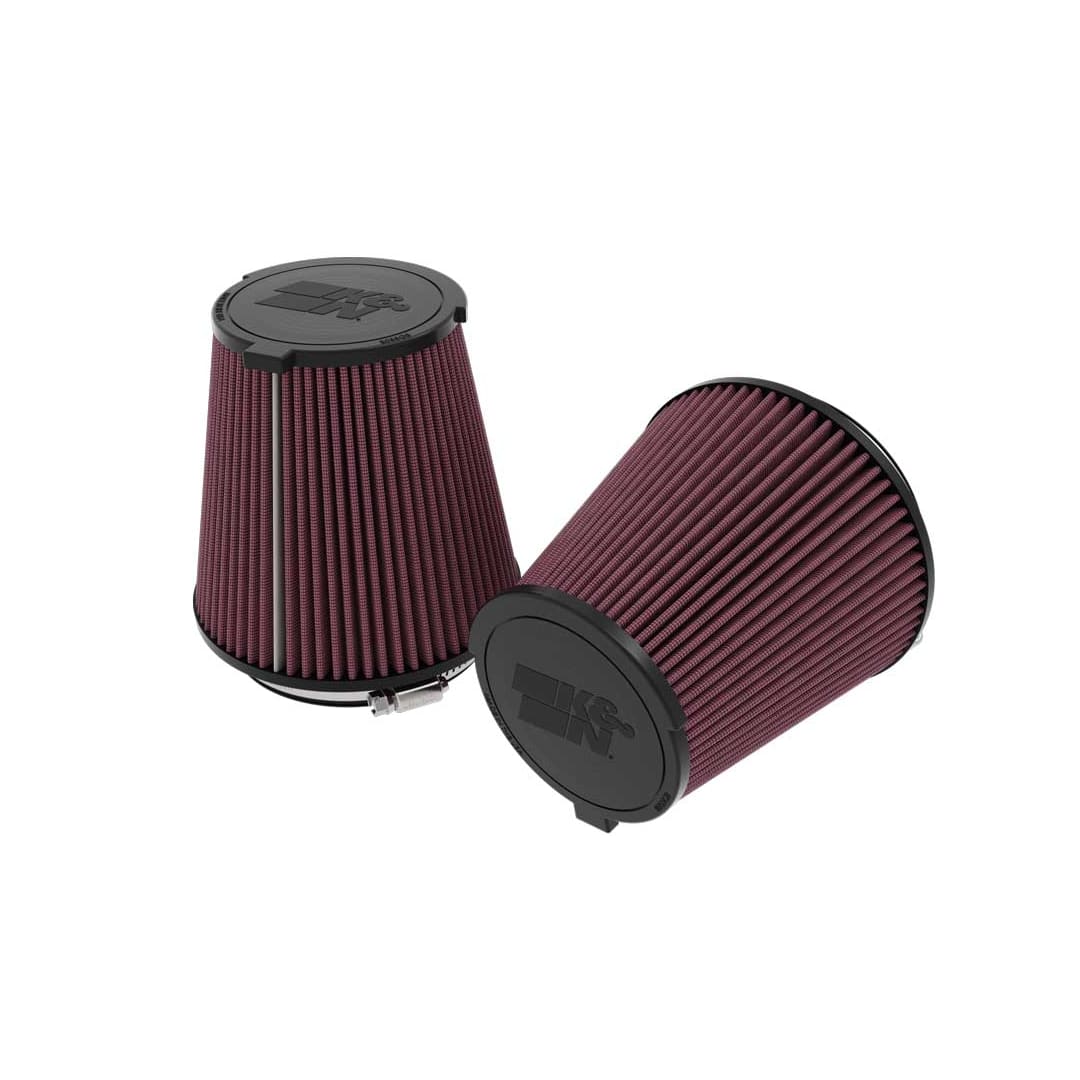

I agree that the double filters and throttle bodies are likely beyond the needs of a 307 cubic inch engine, so OEM filters are likely adequate on the S650. Interestingly, the K&N CAI actually hurts overall HP on a stock 5.0 Coyote. Likely the smaller inside diameter of the air tubes between the MAFs and the TBs on the K&N kits.
