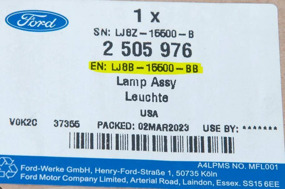

Today I did some more research and I found the complete answer.
LJ8Z-15500-A
is for the US and Canadian Ford Mustangs And does not have the rear fog lights.
LJ8Z-15500-B
Is for the Mustang Mach-E vehicles and regular Mustangs for overseas (Europe, UK, Australia etc.) with rear fog light.
It seems like the Mustang Mach-E back up lamp is used for the newer overseas Mustangs.
I now finally know for sure that I can order the right part.

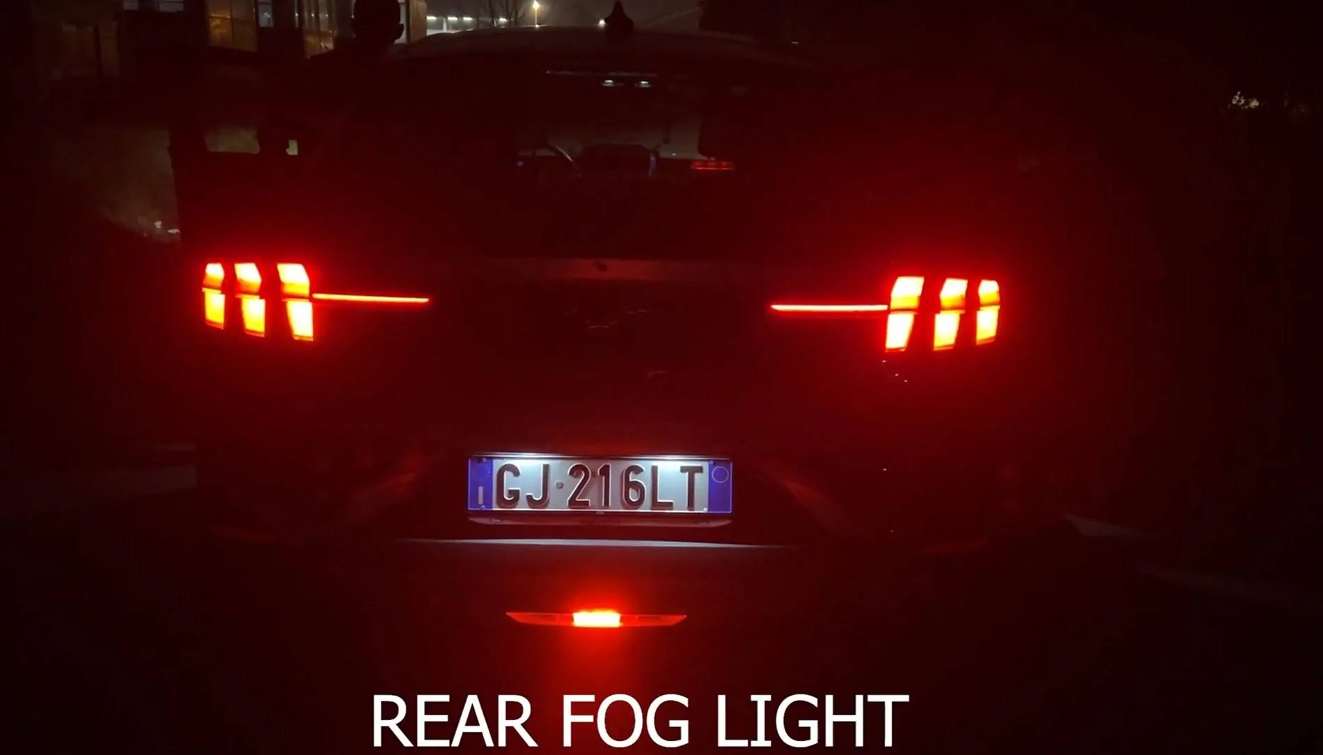

S650 Mustang Backup Lamp. Who knows the difference? Screenshot_20250109_013924_YouTu

Just to be sure I get the right part, I'm going to order it from Europe instead of America, because there is a chance that if I order this in America I get the one without the fog light.
You need that part number:
S650 Mustang Backup Lamp. Who knows the difference? 1736412244959-oa
Do you already know, how to code things?
Just wiring is not enough!
You should also get the light switch with the button for the rear fog light.
PS: I'm not sure, if piecing this together in different threads is a smart way... 😜
Thanks, that's exactly what I found yesterday. Look at 1 comment before yours.
It's a part shared between the overseas Mustangs and the Mustang Mach-E.
Yeah it needs coding, but there is also another way to get it to work. Many homologation shops in Europe make their own light switch and wires to have it done.
I just wanted the OEM look of the fog light.
This is the part number of the light switch that I also going to order if I can get the coding done.
PR3Z11654BA
