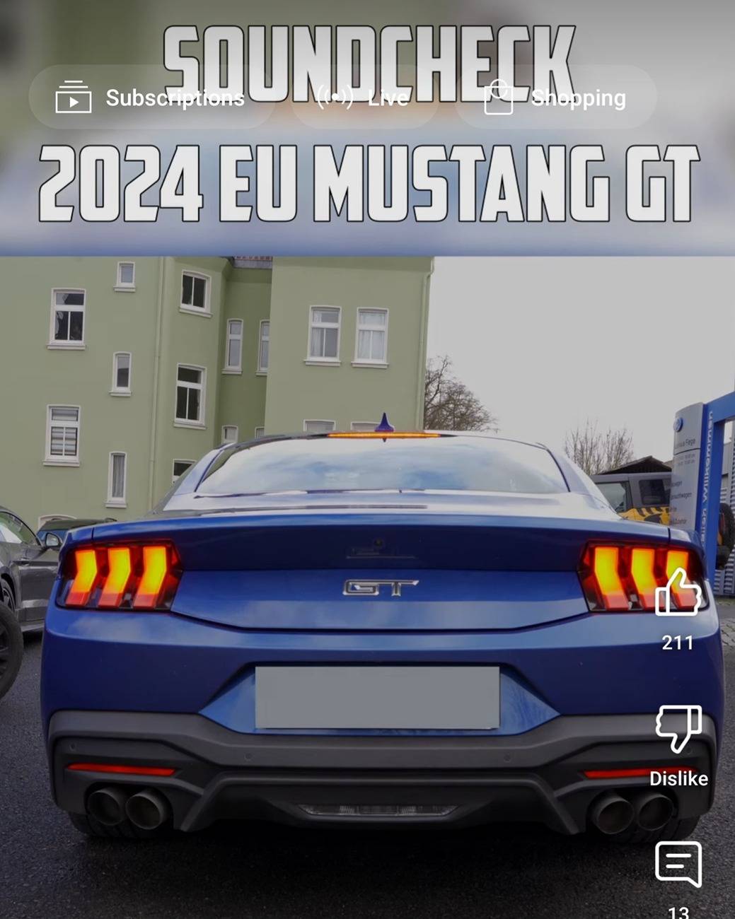

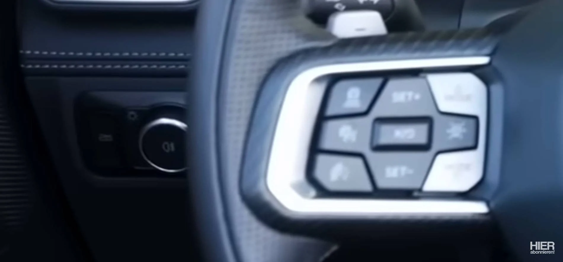

I think we do not have the fog light just as the US Version. Have not received mine yet so cannot confirm but it's different to the S550, seems fog lights in general are all gone (front and back).
@0:30 you can see it's completely white

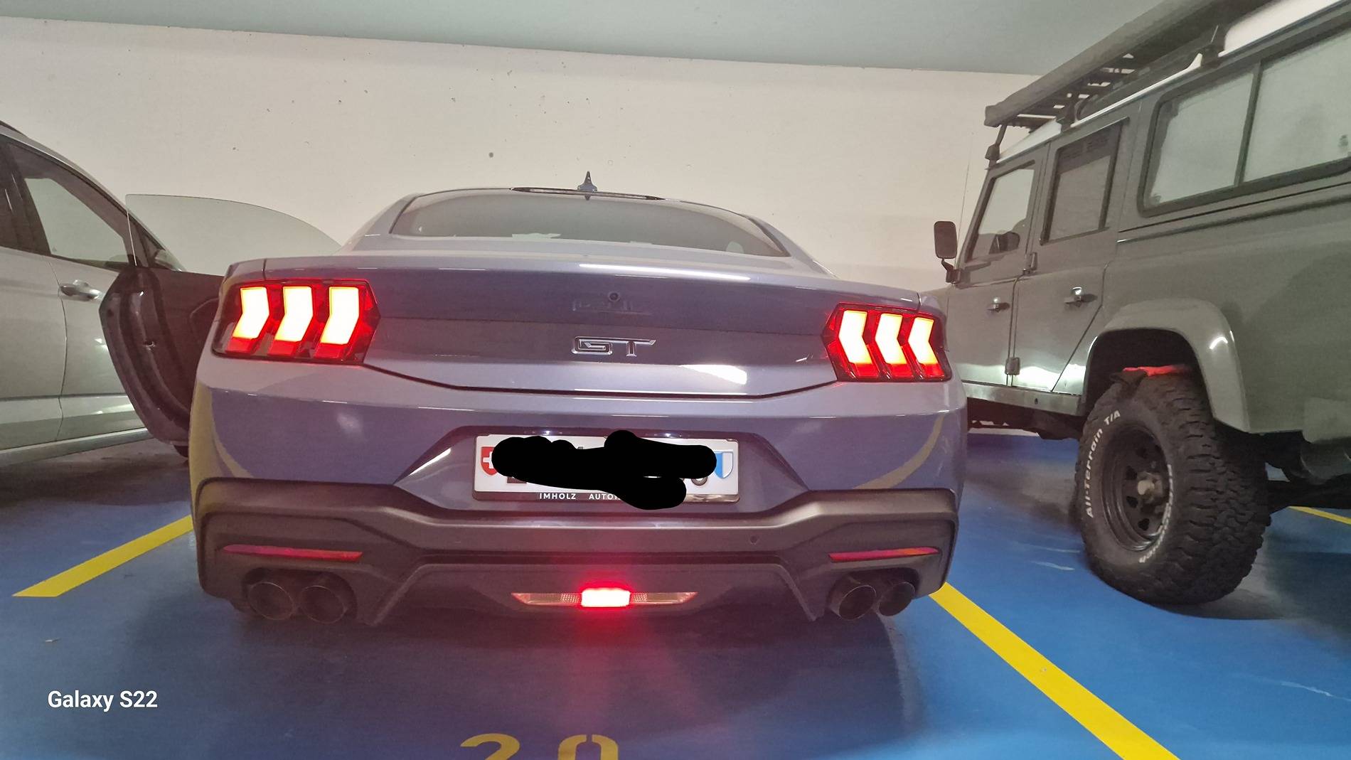

Yes you have if you look closely.
On the S550 the middle part is red.
On the S650 the middle part is white, but with a red bulb inside.
Zoom in and you will see that the white plastic has 3 parts with the fog light in the middle.
The rear fog light in EU is mandatory, so they 100% have it.
The picture I attached you can see it better. The white glass has different parts for different light bulbs.
In the second picture that I attached you can also see the rear fog light emblem on the light switch. The US models don't have this emblem on the light switch.

It is there, it is just clear. Similar to the Euro S550's taillights, the Euro foglight cover isn't red.
Activating it will illuminate the center part of the light fixture in the lower rear fascia red.

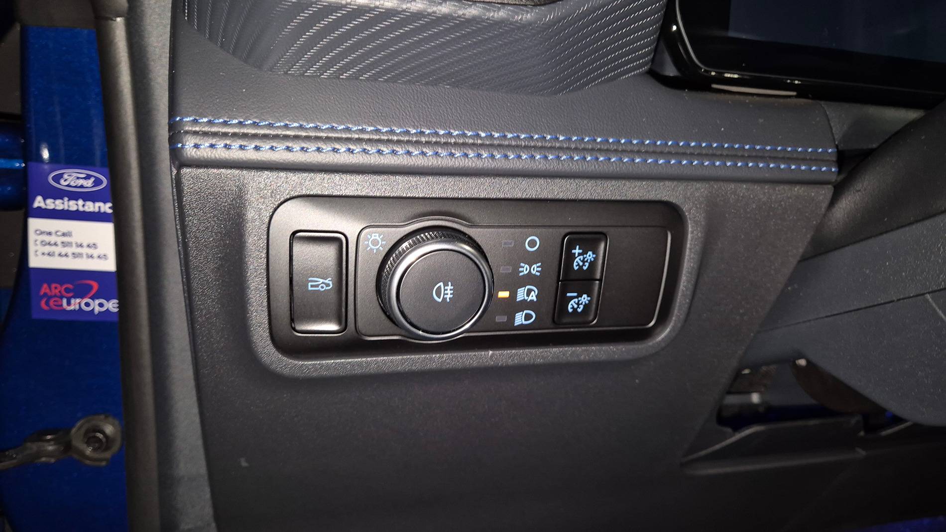

On cars not intended for the US or Canada, there will be a fog light switch in the center of the headlight mode selector, much like any other recent Ford vehicle, but the fog light logo will be mirrored. Pressing it will activate the rear fog lights, and you'll get an orange fog light logo in the dash.
If your car is USDM or Canada-spec, you will not have it.

How do you turn them on and off. Where is the switch no front fog lights?
So we don't have any in front but, you have a button where the light buttons are (where you set it to automatic etc.). Had to go take a picture as the search on google images only shows US models, they added it in the selection wheel as a button.
