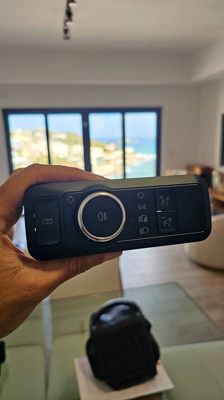

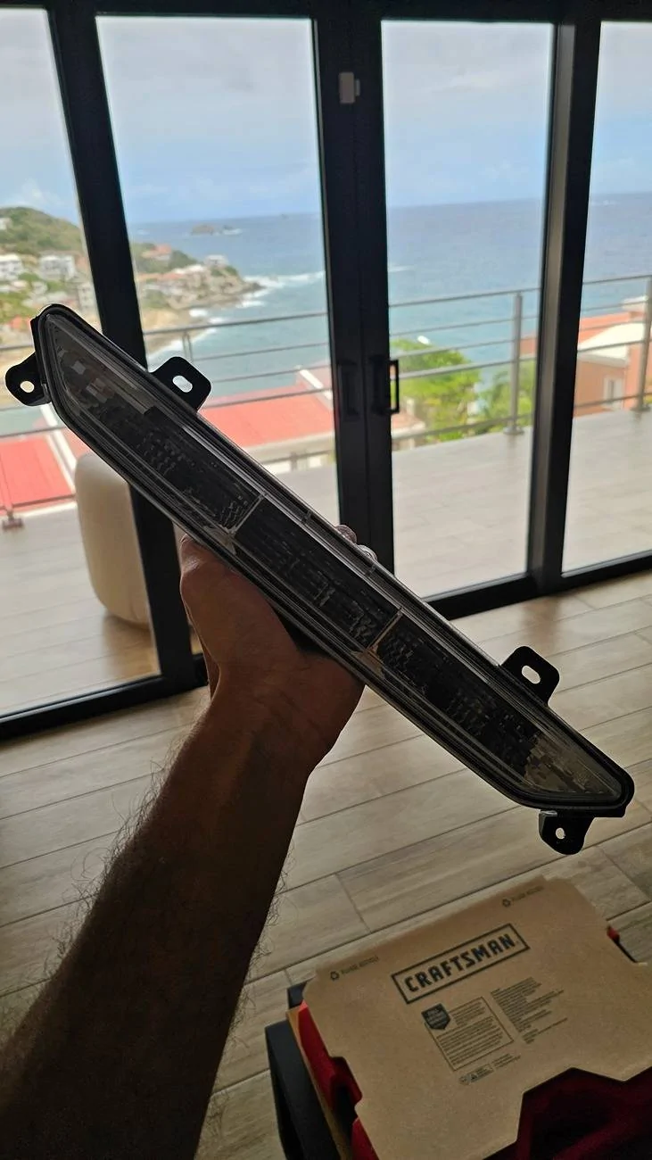

My European fog light switch arrived.
It's time to do the conversion..
I will do this the coming weekend.
Can you share a part number for that European switch panel? I’ve been looking everywhere for one with the fog light included.
Also; was it hard to wire? I assume the existing connections can be transferred directly leaving only the fog light switch itself needing to be connected through the electrical distribution box.
Your advice would be most appreciated- Thank you.
You are just a few hours too quick. I'm preparring mentally to start with this conversion just right now. I took a shower, I had breakfast and now I'm back behind the computer just to put everything on my phone, so I can go to the garage and have everything next to me and do everything step by step.
The conversion should be easy with no wiring at all. Only changing some codes in Forscan.
But I'm always nervous when working on my car. I installed side mirrors with turn signals and that was a job that was 10x harder, but still I'm a bit scared to do something new.
PR3Z11654BA is the part number of the light switch is this what you meant?
If you meant the panel that goes around the light switch, that's exactly the same and you don't need to replace that part. If you want to replace that part, you can order the convertible light switch panel that has an extra storage compartment for your singlasses or something else.

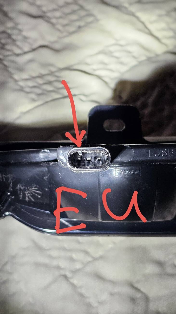

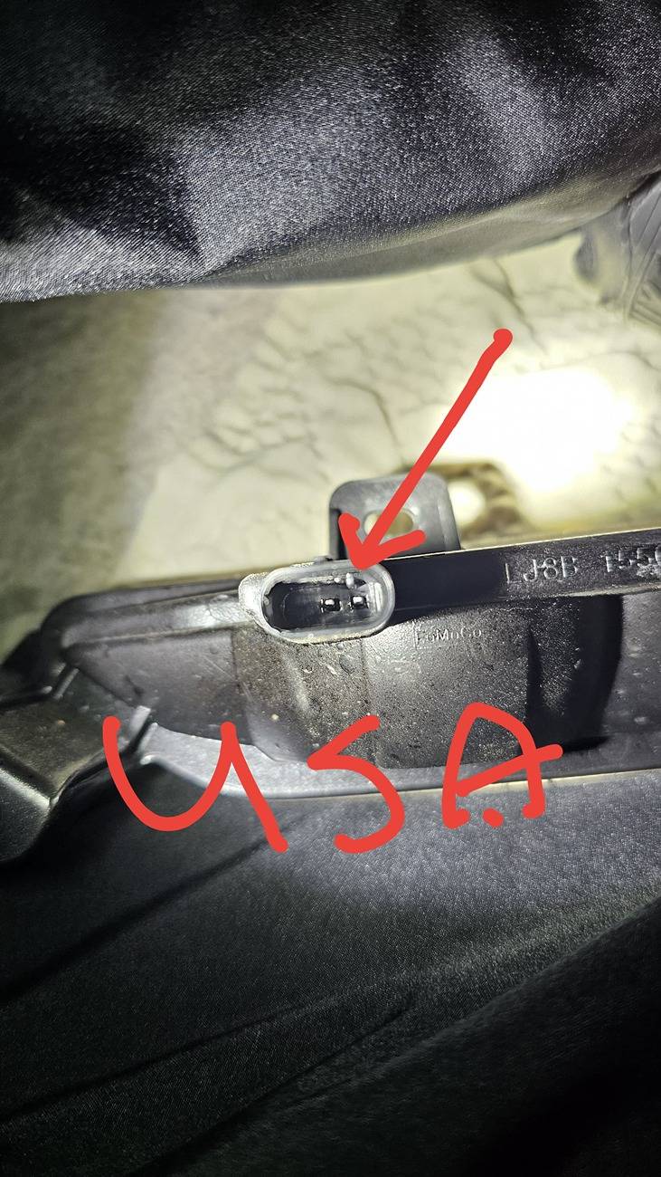

Okay, I have one issue.
The European connector is different than the USA connector or I might got the wrong part.
The iron pin on the European connector is on the other side, so I cant plug it in.
I have no clue if its the wrong part number because on both parts it mentions the EU AND the US part number. Very strange.
What I know is that a European guy did this conversion and it was plug and play, so I might got the wrong part.

UPDATE:
It seems like it is not plug and play, but the person who already did this conversion told me that I need to remove that metal pin and move it to the location where the USA part is located.
I have no clue how to do this. Anyone?

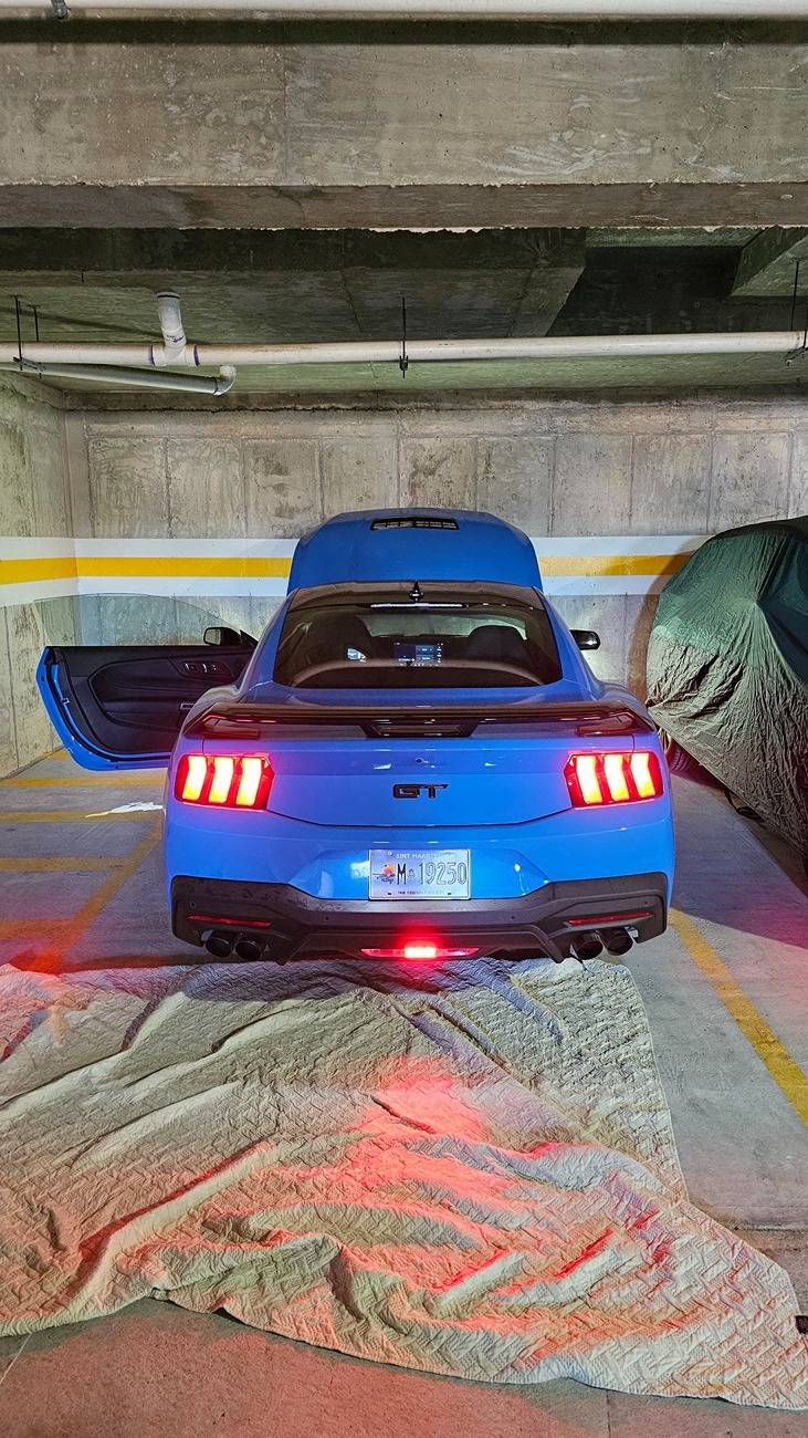

Update: I removed the "metal" tab inside the socket. It turned out to be plastic, so it was easy to brake it with a pick. Now it should be plug and play. I'm going back to the car.
