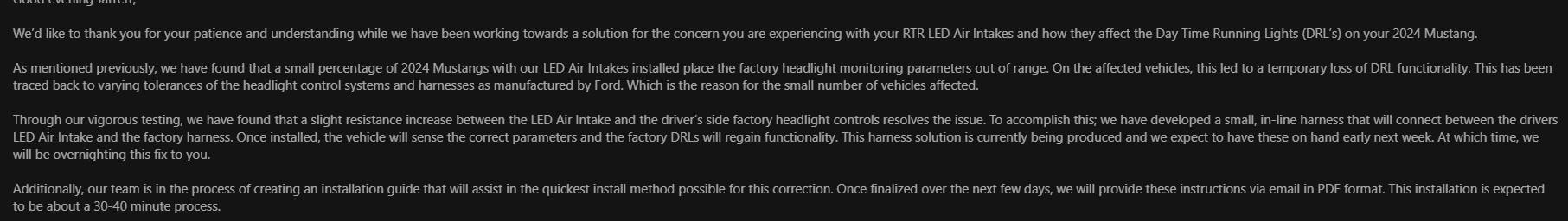

GlenC
Dec 23, 2023
Green Cove Springs FL
2024 Mustang GT PP
I just received the wiring harness to fix the light issue but have not got the instructions yet. Has anyone received the instructions? Suppose to be sent pdf file via email.
