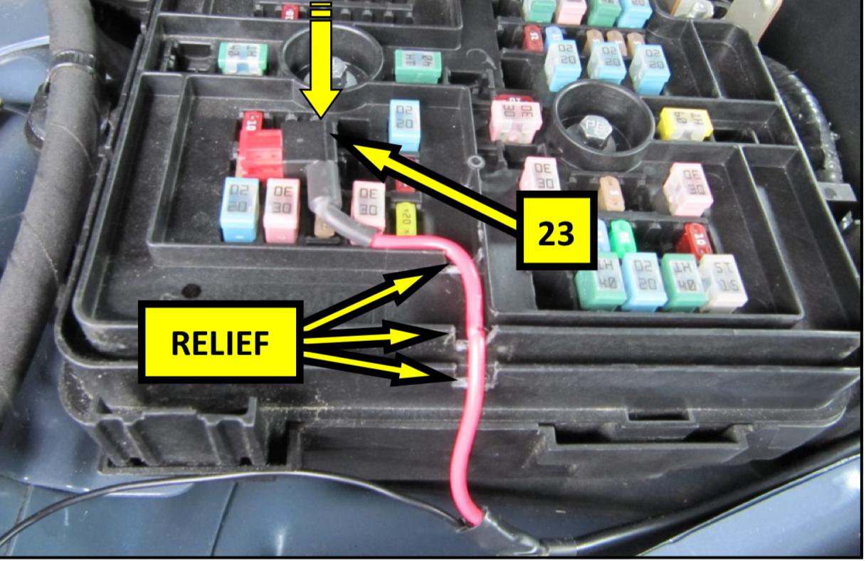

Good luck getting ford to warranty repair it .. void ..that’s why I questioned the barbaric wiring ..when RTR released the install guide

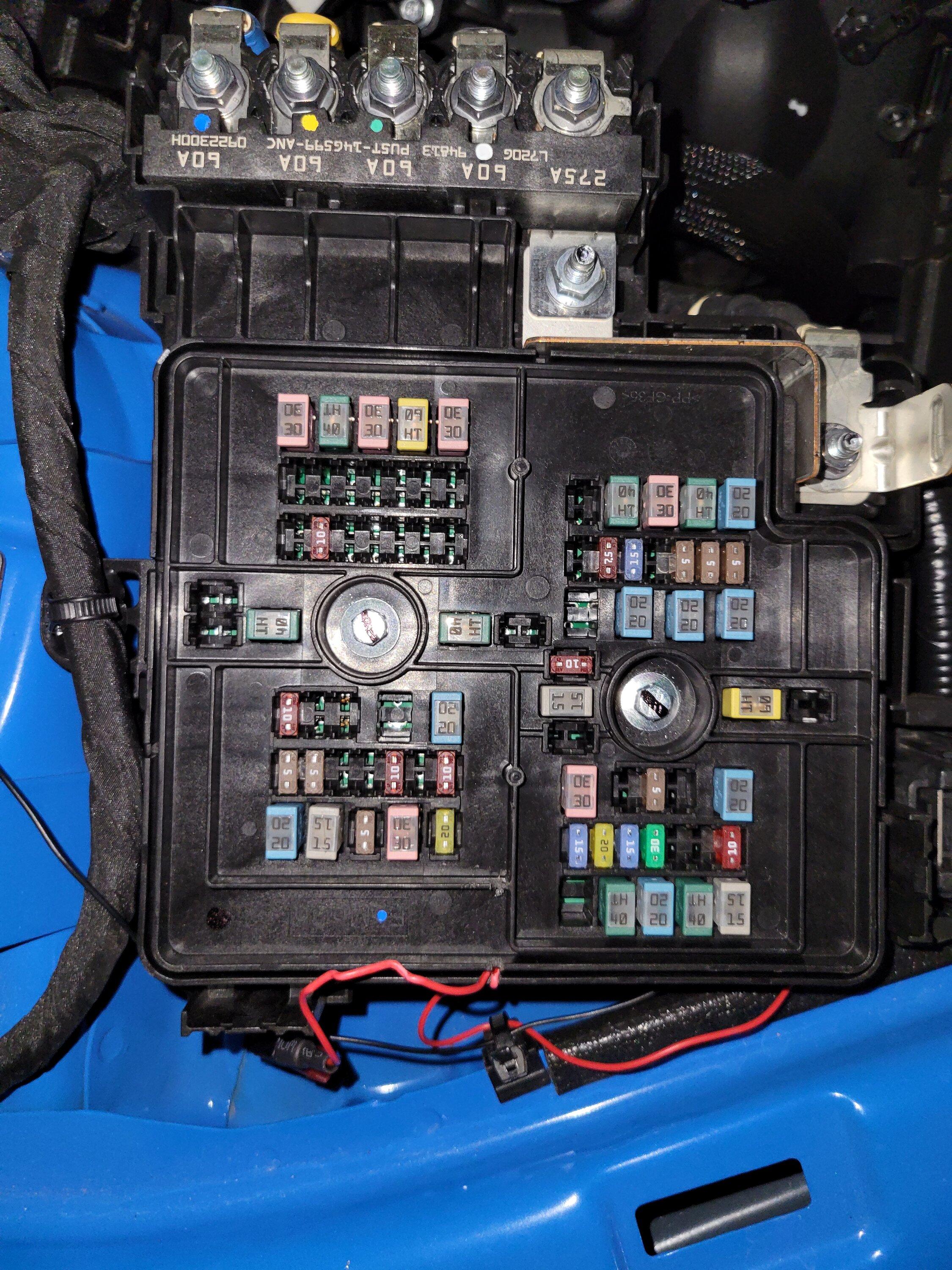

so, after letting the car idle for 20 minutes im either correct or too impatient to verify 100% so YMMV but i have good news and it all starts with this guys picture:
first off, to clear any confusion, your headlights not working because of that fuse tap wont void the warranty as that fuse isnt even the headlights...speaking of fuses... im gonna go ahead and tag @RTR Vehicles in case this is correct so they can fix their manual...
first off...here is a picture of the Fuse box in my GT premium PP minus the RTR fuse
S650 Mustang Anyone install RTR upper grille? 20231220_205741
the two we are interested in here are fuses 100 and 101 circled in red below, those are the headlight fuses:
S650 Mustang Anyone install RTR upper grille? 20231220_205741 red
now if you reference the RTR photo above youll notice the problem...theirs are 30 amps, while ours are 15 amps...
luckily we have two options to fix this: the "proper" way and the "fuck you i want it now" way
the "proper" way is to purchase two of these littelfuse 30A fuses specifically those as standard ones with closed walls wont fit in those slots. simply purchase those, wait 3-5 business days and swap them out with the 15s.

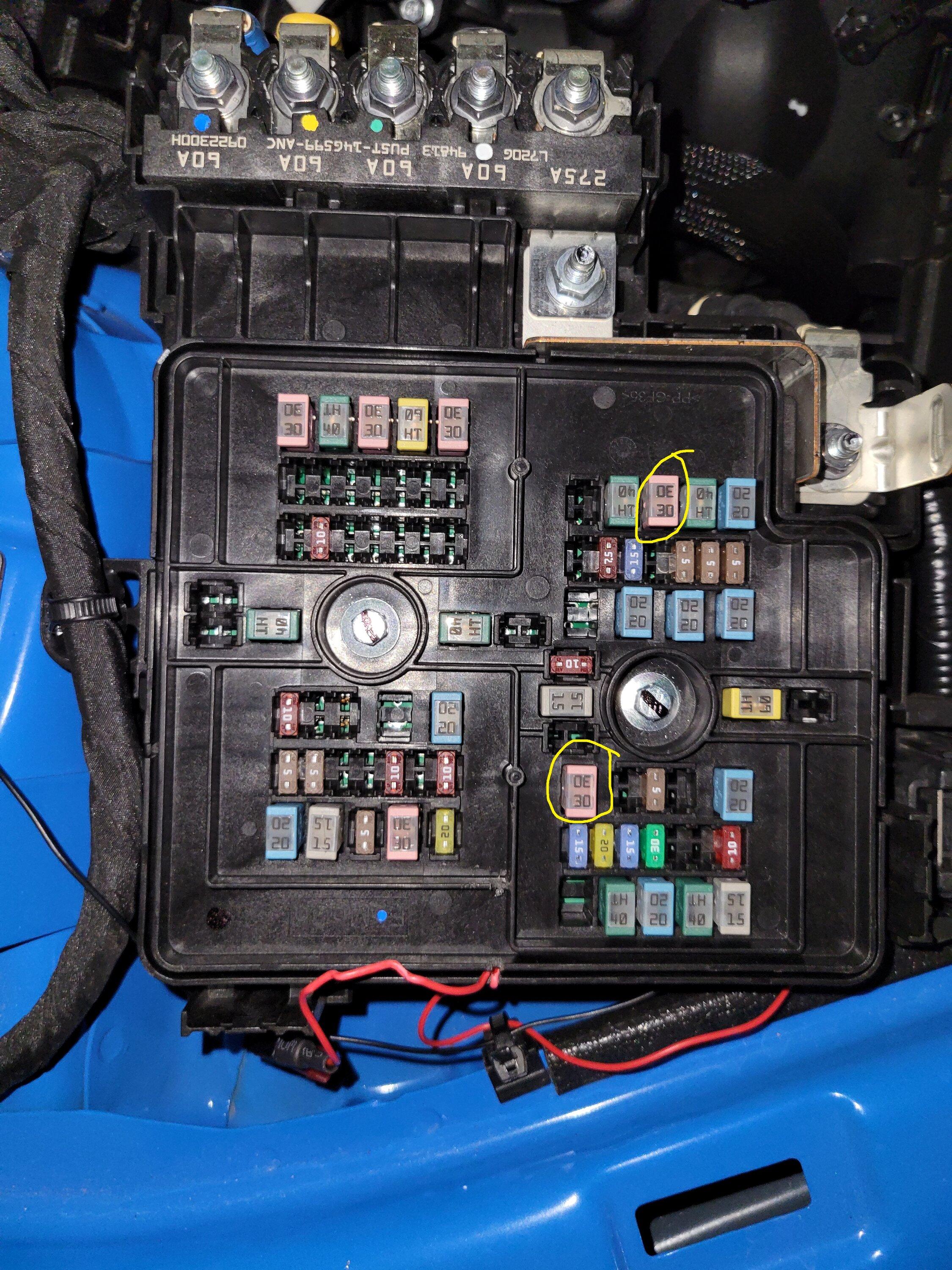

the "fuck you i want it now" way requires a little leg work:
step 1: go down to the local autozone and buy two 30A fuses heres the type i got for reference
step 2: pull fuses 69 and 11 bellow in yellow, youll notice as you pull them that the prongs are smaller than the ones for the headlights, thats good news!
S650 Mustang Anyone install RTR upper grille? 20231220_205741 yellow
step 3: replace the fuses in yellow with the two fuses you bought from the store, as stated above if they are walled and not open sided theyll still fit on those two fuses.
step 4: take the two fuses you pulled and swap out the two 15A fuses for the headlights.
do that and your DRL issue should be solved!

Update: well fuck, after letting it sit overnight and cold starting it the issue has come back.
Damn I was really hoping that was gonna fix it. Appreciate you writing all that out though. Glad I’m not the only one experiencing this issue. You and a few others I’ve talked to are dealing with this same thing. @RTR Vehicles we need a solution
