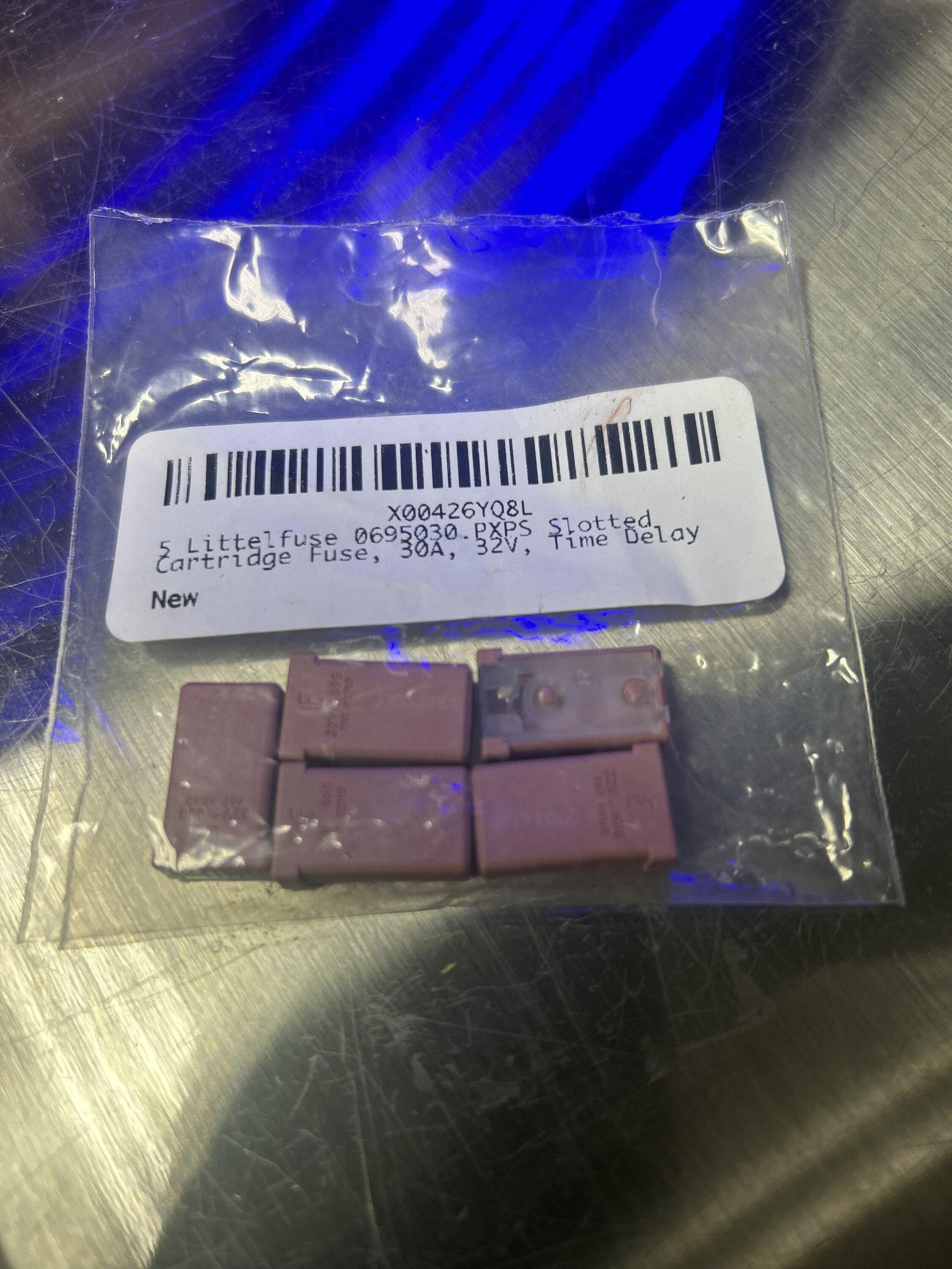

So Amazon delivered the pack of fuses (pic below of what I received) but the walls are not slotted although the picture in the description on Amazon shows them clearly slotted and the model number on the pack I received matches up to the model number of description with the correct slotted fuse as pictured on Amazon. I understand one of you already attempted swapping the two 15a fuses to the 30a to match up to pics shown in RTR’s instructions) with it still not fixing the issues but I wanted to try it anyway just to see. Now I can’t even try that. Talk about bad luck on both sides of this whole thing at this point. I agree it only makes sense that the RTR lights are pulling to much power causing a issue with the mustang lights but why are not all people that install this grille having the same issue and some of us are?? I guess all we can do at this point if wait and hope RTR can figure it out.
BTW mine work fine when I first turn the car on and it seems like around 15-20 min later the driver side cuts out. This sucks is all I can say it this point. @RTR Vehicles please update us when you have any new information.
you can still try it, the second half of my "instructions" post explains how to make it work with those fuses as well
