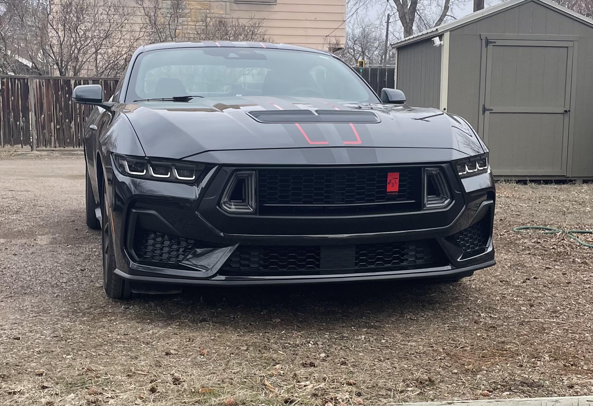

I for one just wanted to share the beauty since I just put the grille on last weekend. Secondly, for anyone who was concerned when purchasing - it’s been a week now and my lights have not been affected. I will update if anything changes but it seams it really isn’t an every car problem (mines premium idk if that matters but I heard it might have something to do with it). Hope it stays strong and I hope you guys get your fix soon!
