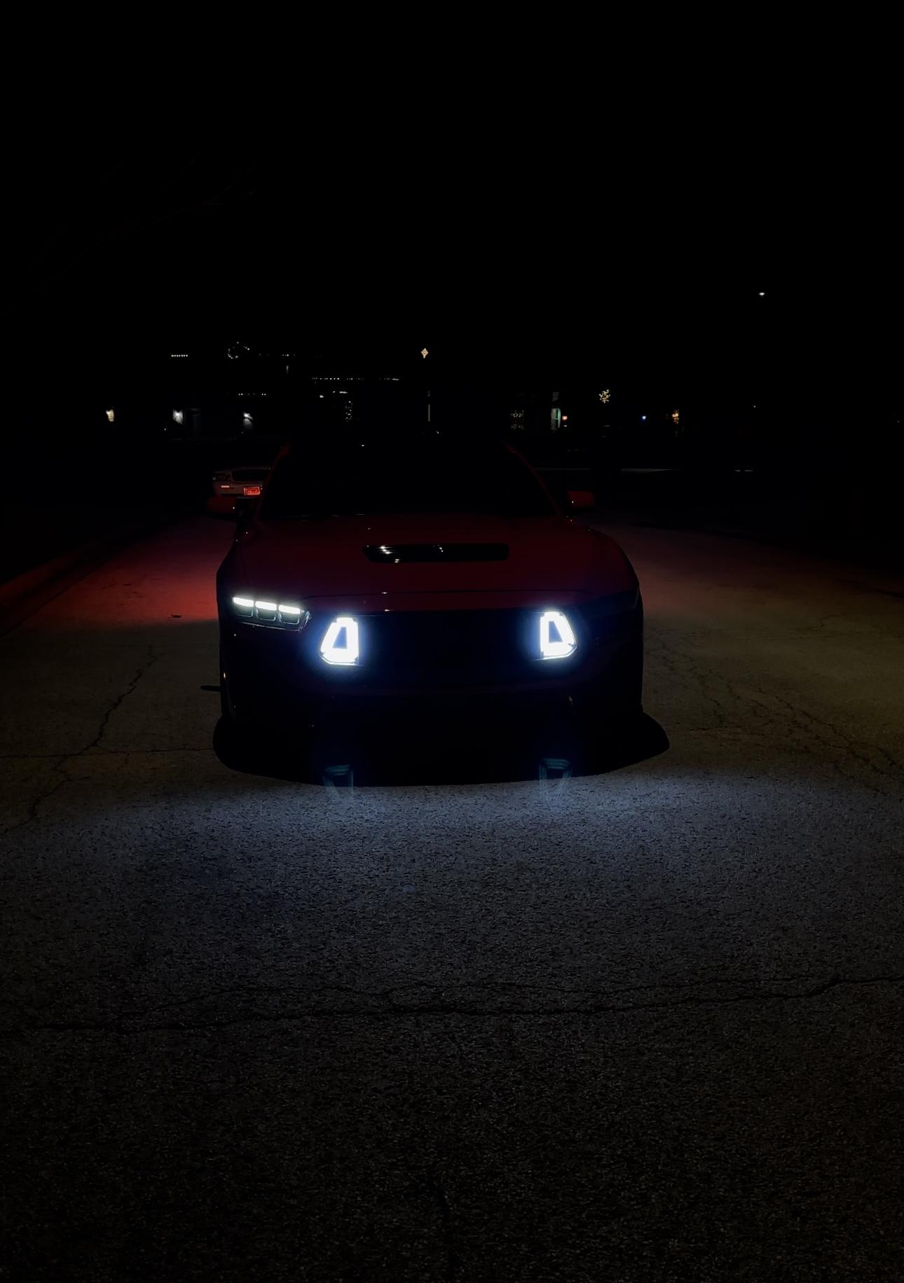

i have the same problem with mine, im currently testing a solution, ill update in 30 or so minutes if it works or not.
I’m glad I’m seeing others with the same Daytime runner issue! Love the grill but may need to sell it if this issue doesn’t get fixed.

Update: well fuck, after letting it sit overnight and cold starting it the issue has come back.
My biggest issue with it seems to be when I first start up. Sometimes it works sometimes it doesn’t and then if I just sit there and play with the lights, they come back and then the issue goes away, but then comes back…. I don’t know if anybody else has this side effect as well but the sequentials also stop working whenever that side DRL is out it just flashes yellow instead of sequencing.

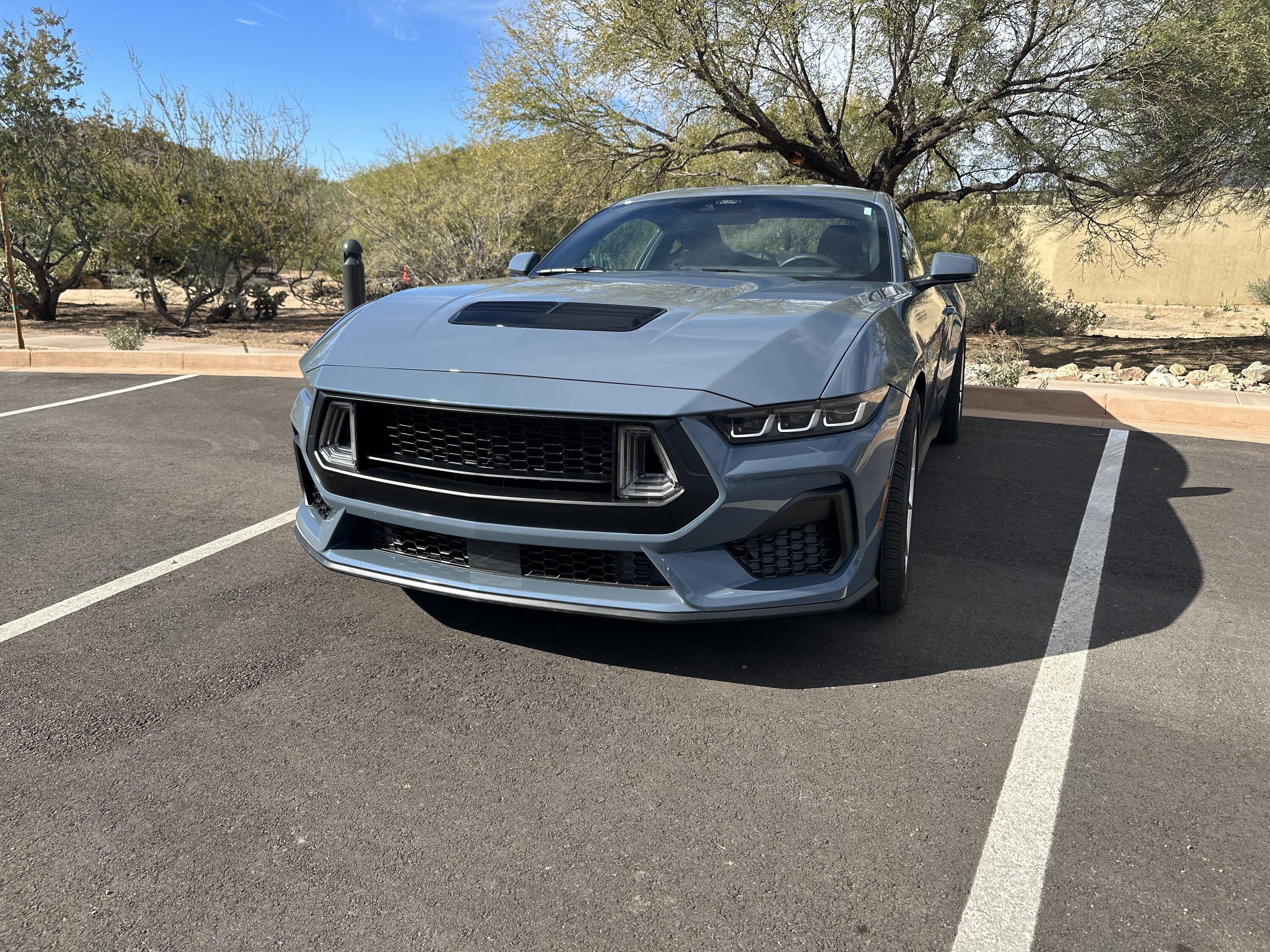

Anyone installed their RTR upper grille? I’m having issues with the Day time running lights now one DRL is working and the other isn’t. Or neither work it’s random. They work then they don’t. Everything is secured and the fuse and everything is correct.
Another issue that I have been having and wanted input from anybody else if they’ve been experiencing this is my Auto highbeams haven’t been acting right either. I don’t know if it’s all connected or if it’s another thing I need to look at.
