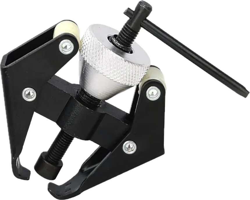

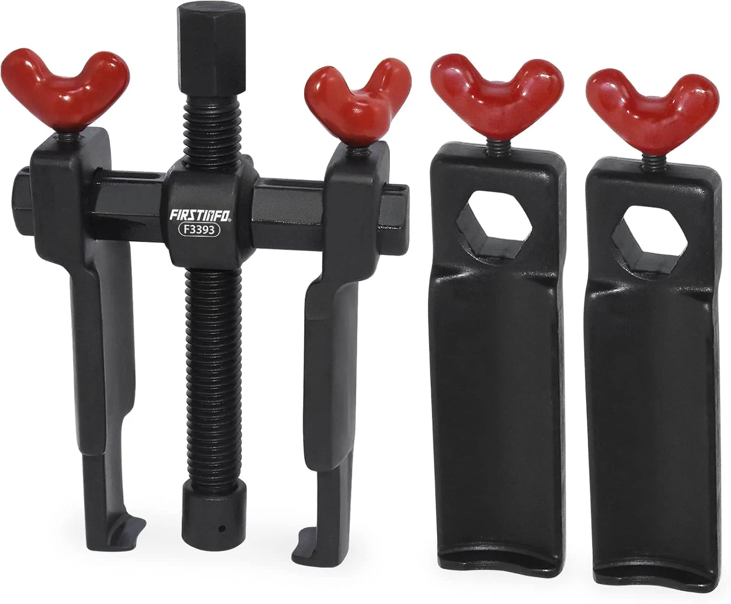

I had to remove both wiper arms when I installed my FP/Whipple SC. I purchased the puller below from Amazon. It did the job, however fitment wasn't the best. Keeping the puller arms under both sides of the wiper arm post is tricky- You have to maintain puller arm alignment on wiper post and adjust the puller at the same time. Having three hands would help. Again, this puller did the job. If I had to do this again I might order a lighter duty, less bulky puller that would also be cheaper.
All the above aside a wiper arm puller is a requirement. Extra caution is needed to avoid marring the wiper arm post during removal. Not an issue when reinstalling.
thanks for the info. I’m looking at this one….
