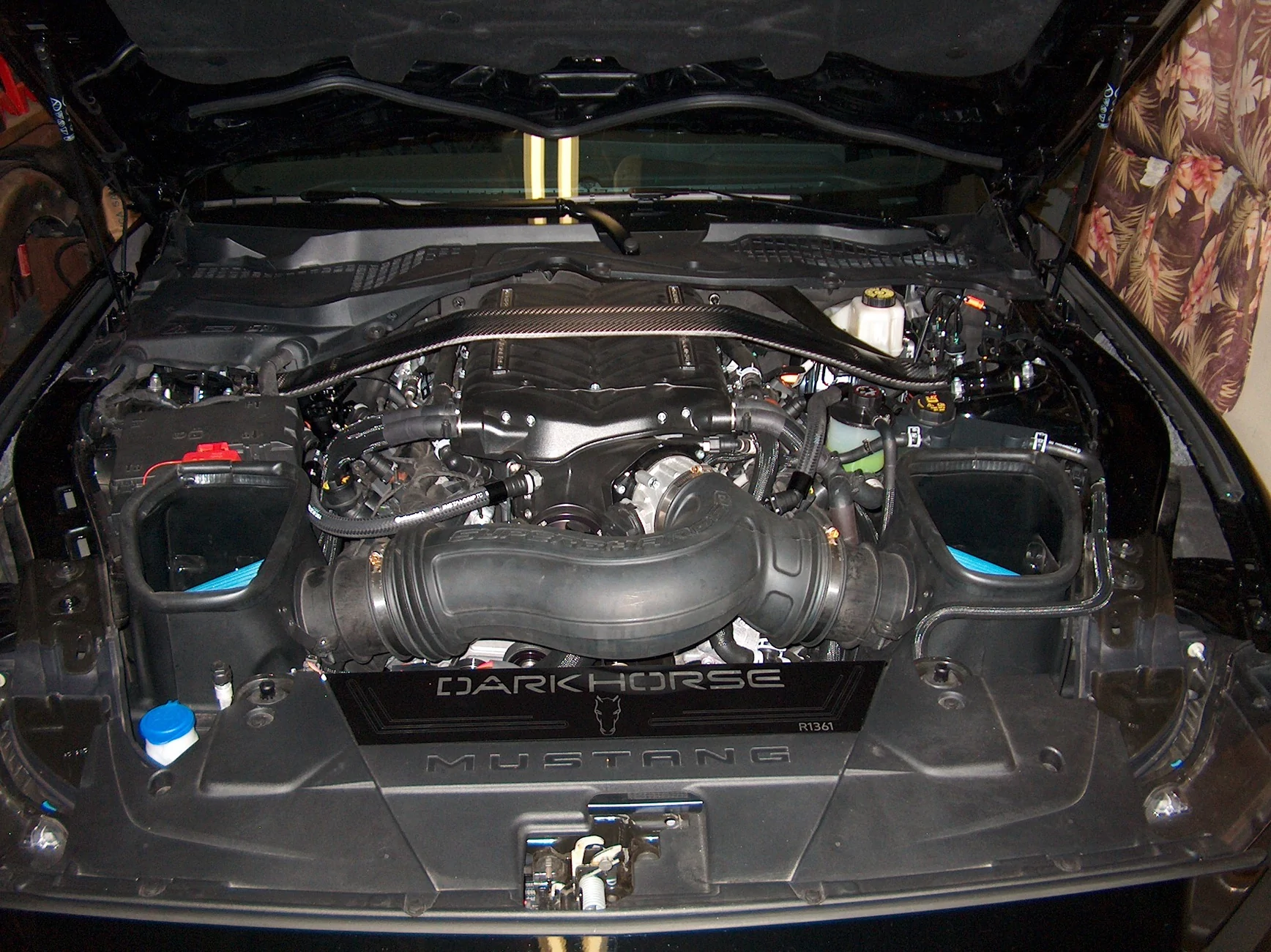

Thoughts on carbon fiber composite brace resting/working over top of the hot engine. does it flex more than steel at temperature? does it warp over time? post cure issues or is it heat cured? That's an expensive maybe to me. looks cool though
