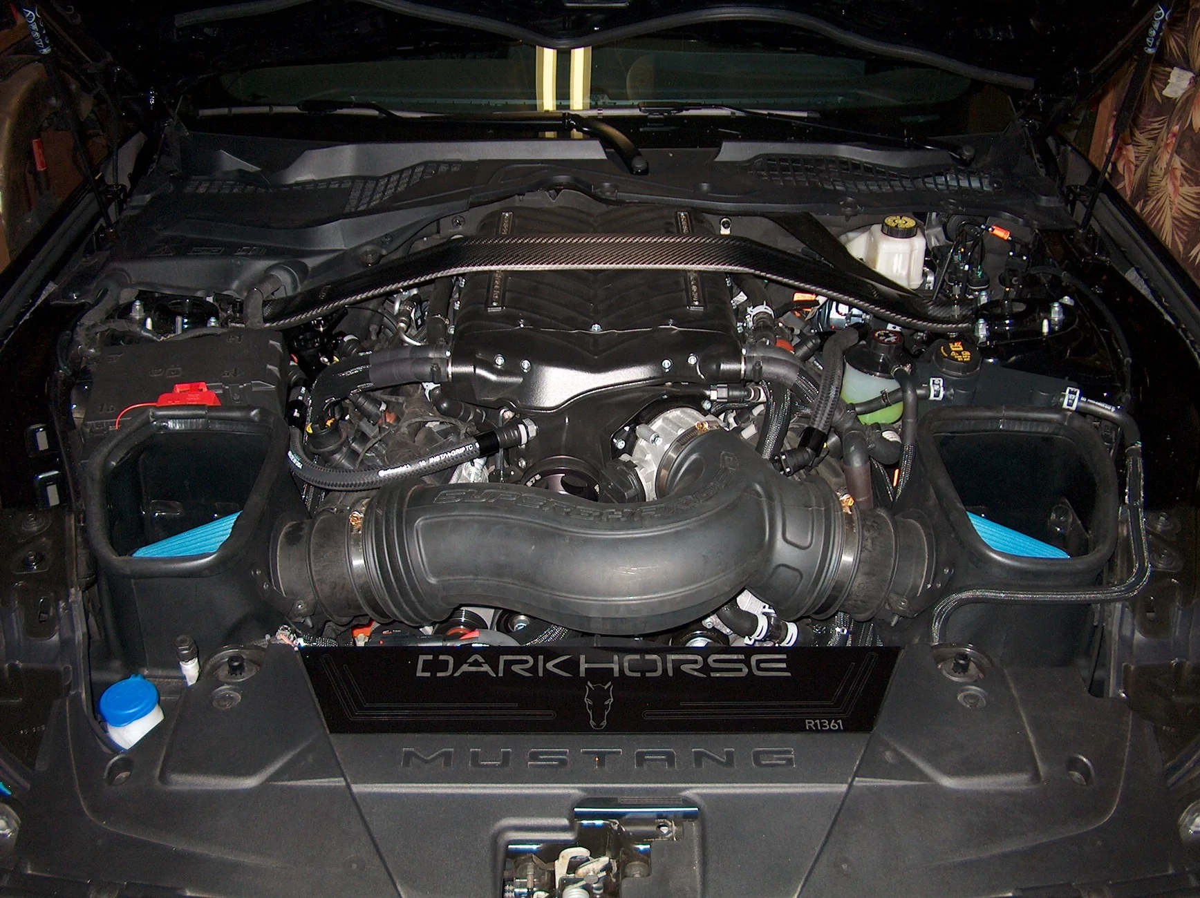

VMP Performance makes a Carbon fiber strut brace just clears Whipple.

I got it from VMP Performance. Don't know how to do a link.

It's very nicely built. It is very strong still does more than not having one.
