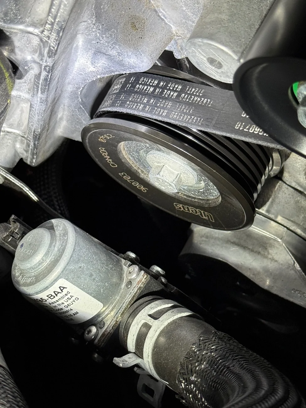

No regrets, but my Whipple/VMP Stage 1 blower is having an issue. Bought the blower at the end of May and professionally installed in June. Never raced, just sounded terrible after starting up recently. Currently at the speed shop waiting to hear back
make sure your car is not eating belts. One of my pullies on Roush charged Stang, one of the bolts (too long) had been incorrectly installed.
You had to look really close to be able to tell which bolt was it. Only reason I could tell was it started shredding a belt on the end. It ate an entire rib of the belt. Good luck. Hope you get it resolved, nothing more infuriating.
