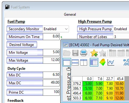

Just so everyone knows this is what KPM is telling me.
Sent to PBD to make sure they know. Will keep you posted.
It sounds like the fuel pump may be triggering a shutdown event with FPDM (fuel pump driver module)
On the 2024 and up vehicles Ford superseded the old FPDM with one that has an over current function.
It’s speculated that this was Fords way of stopping people using BAPs and replacing fuel systems under warranty especially considering the fuel system recalls…..
If this is the case, your tuner will need to adjust a couple of tables back to factory values. The Whipple operating systems have the voltage request set very high to squeeze the most out of the OE fuel pump.
This table here is desired voltage to the fuel pump and should be set with factory values. However, if more is required from the fuel pump these numbers can be increased further but your tuner will have to do it incrementally to ensure it doesn’t have the same issue.
The Max voltage should reflect the highest value in the desired voltage table also.
Give this a go and let me know if I can be of any further help.
