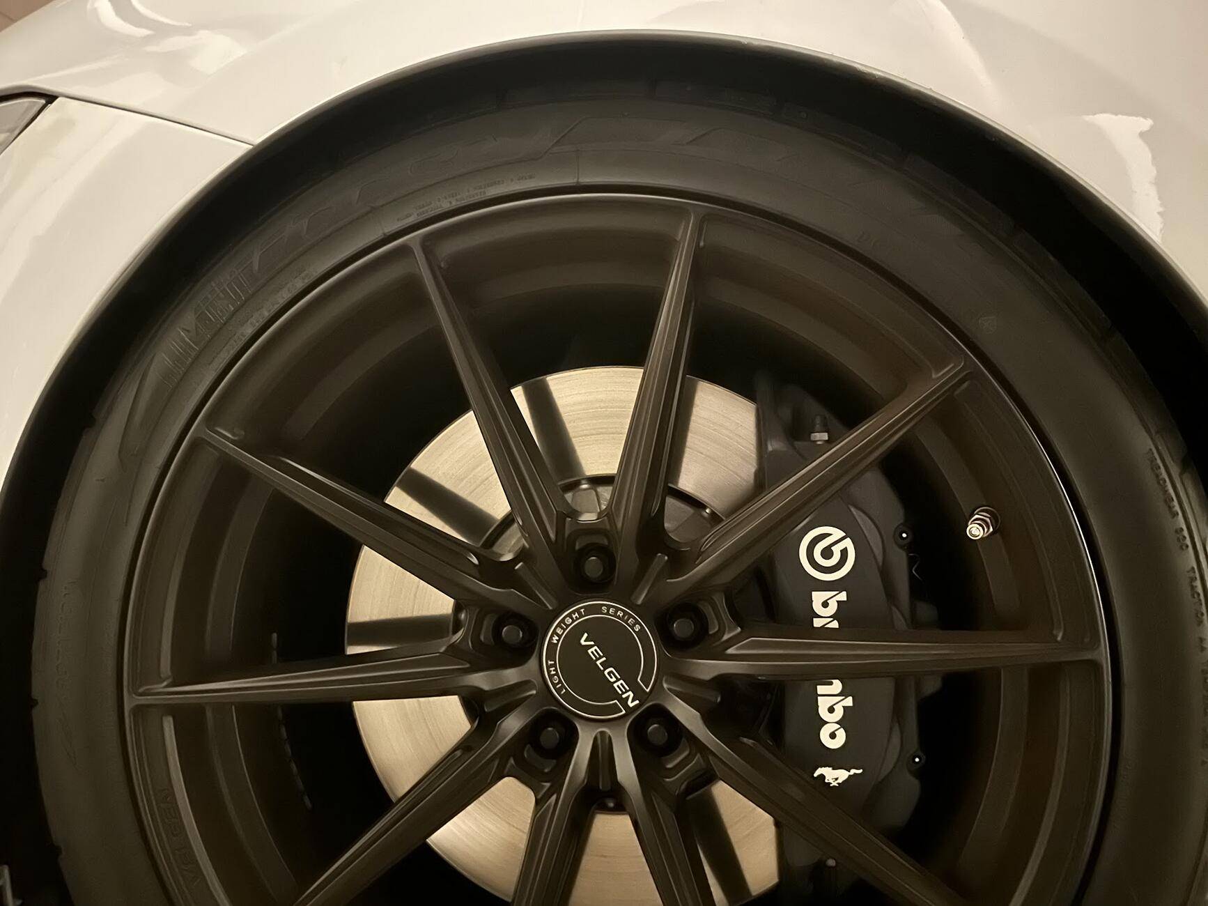

I have a whipple stage 1 being installed in about 3 weeks. I'm currently lowered on Steeda Sport Progressives and have 20" Velgen VF10 wheels with Nitto tires.
Wondering if this wheel/tire setup will be a problem after the Whipple install. I still have my 19" Performance Pack rims that I could get some PS4 for however I love my 20" Velgens and the look they bring.
Thoughts?

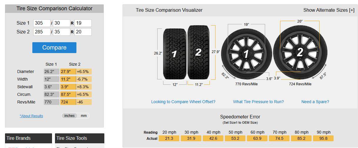

Wheel size doesn't matter... the overall diameter of the tire is what matters... as long as the outside diameter of the 20" tire is within 3% of the diameter of the 19" tire you should be fine with either one.
S650 Mustang Any lowered Dark Horse with Whipple Supercharger and 20" wheels? 1743788460948-s
LEFT is the stock HANDLING PACK tire on the front
RIGHT is the one I have on there now.

I see your dilemma now... that is quite a bit bigger... if you had 30 series on the 20" wheel, you would be good. Everything is fine now I take it, no rubbing anywhere? If all is good, I think it would just be a matter of wait and see... it could just be fine.

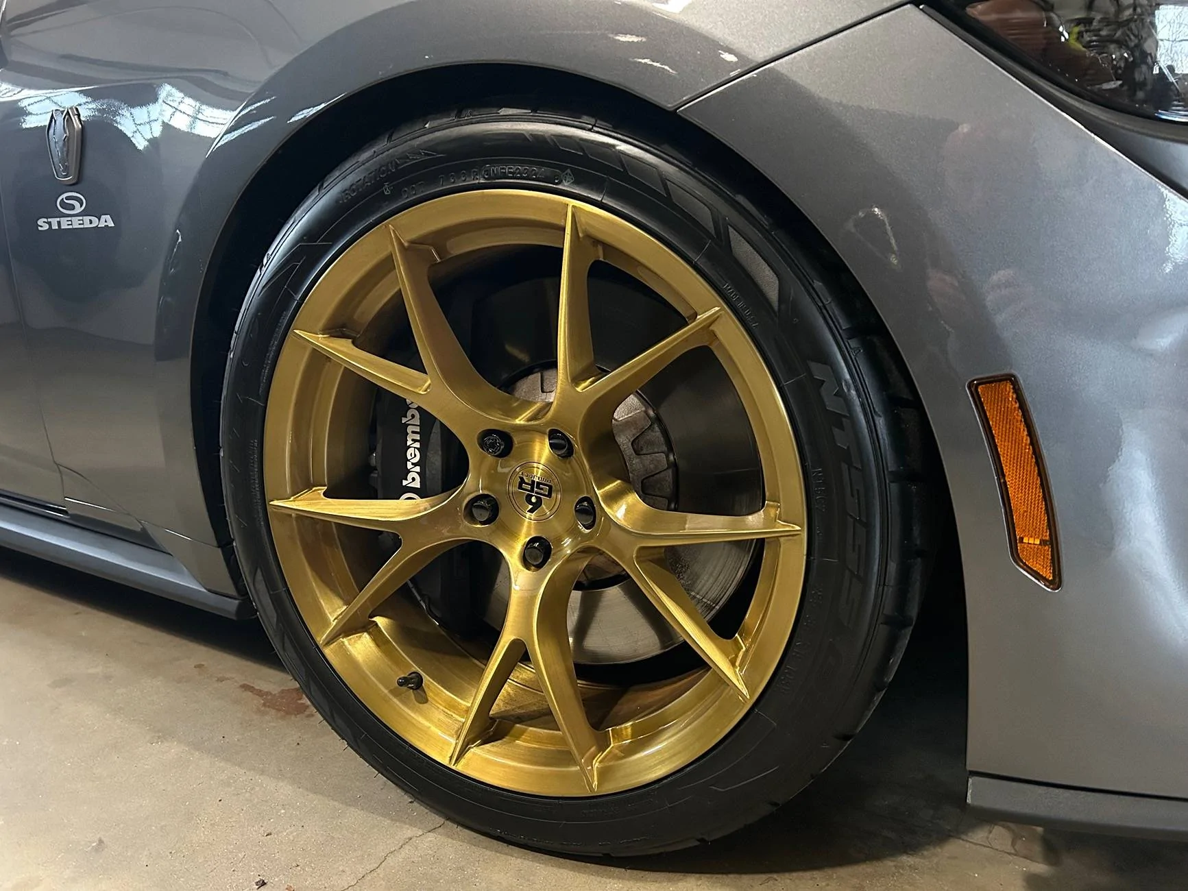

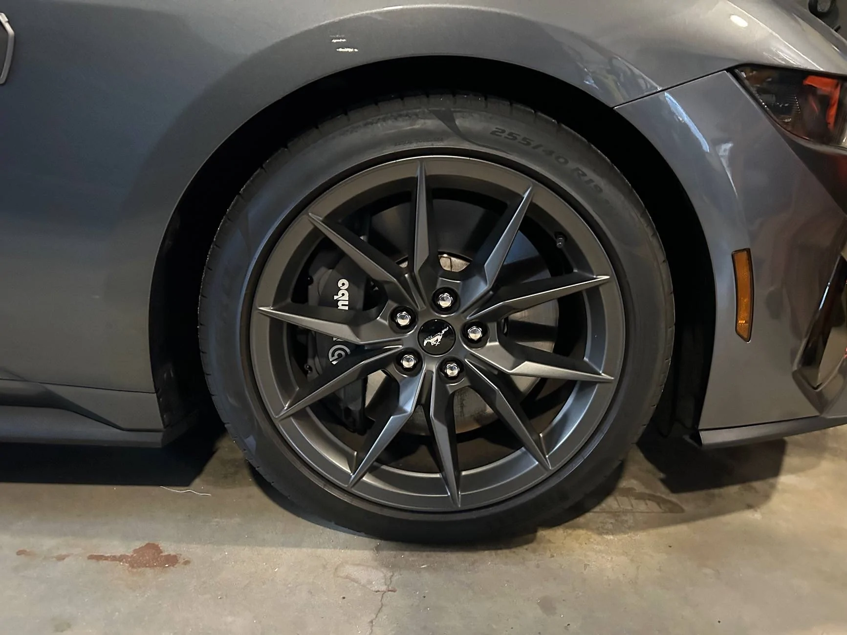

I talked to Rodney at Steeda about the weight of Whipple kit when I ordered mine. Changed springs to Steeda dual rate lowering springs and used their lightweight strut brace that goes underneath. I’m running 285/35/19’s. No issues at all and looks way better without the big gap. Pic with stock DH wheel is a before photo.
Thanks. More trying to see if my existing 20” rims and tires will fit or whether I have to slap some PS4 on my stock HP rims

Shouldn’t make a difference. The overall tire dimensions are pretty close on the 19’s & 20’s. I was going to go with 20’s, but wanted a little more sidewall.
