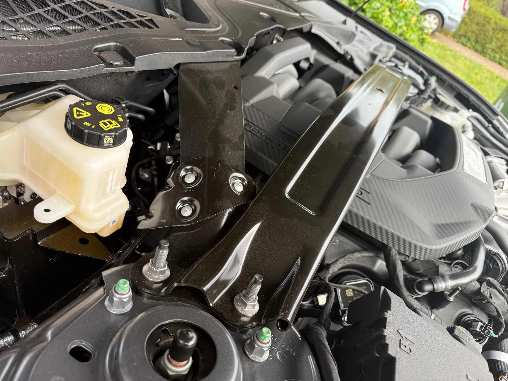

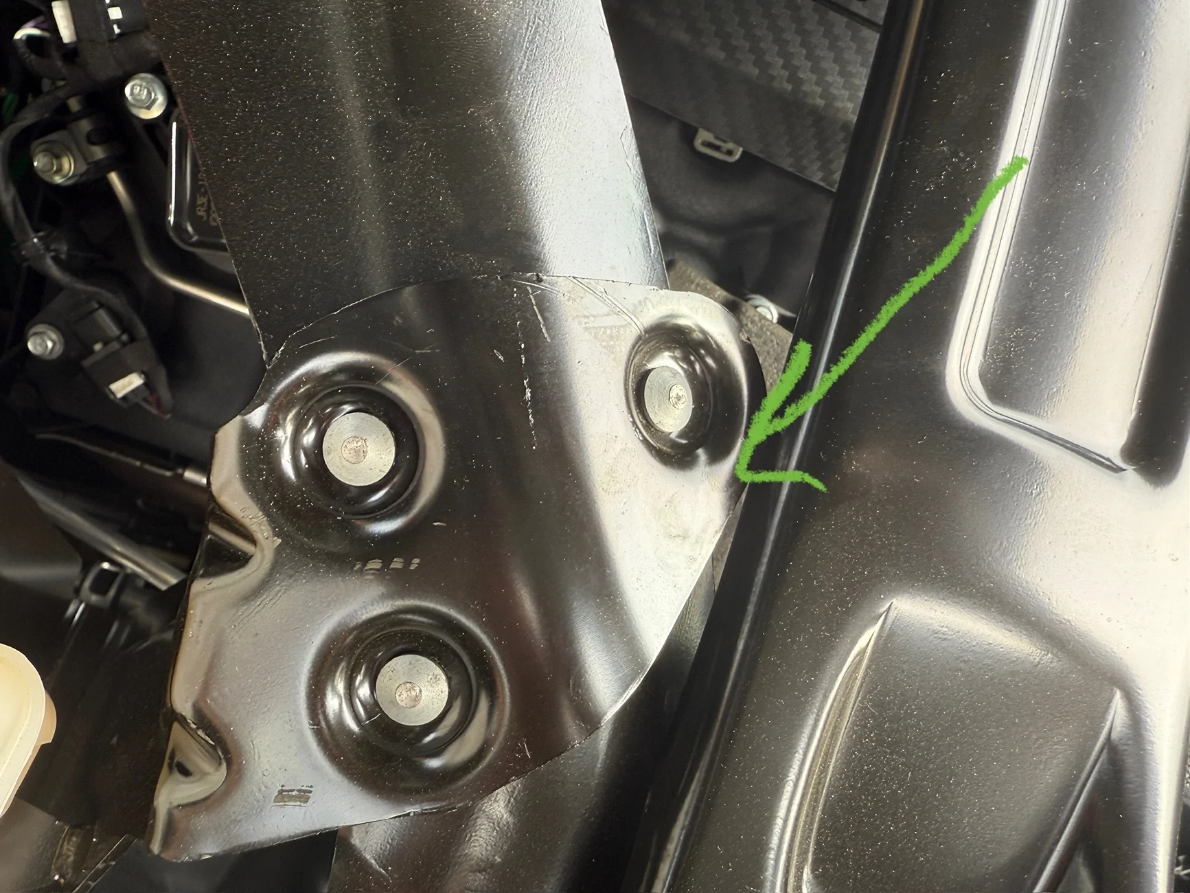

So I was able to self-diagnose the problem, Jerry rig a fix to prove myself correct and then get the dealer to complete a proper repair…
Sharing here for anyone else who might suffer the same thing…
The strut brace was touching this piece, so every time I went over a bump they rubbed together, with the strut brace acting as a tuning fork and making a loud squeak.
S650 Mustang Annoying Squeak - goes away when warmed up IMG_5453
S650 Mustang Annoying Squeak - goes away when warmed up IMG_5454
I added some silicone lube and wedged a thin shim of plastic between the two and boom - no squeak for a week.
Dealership unbolted and moved the strut brace to give it a 2-3mm gap and now we’re problem free.
At least with this issue!
