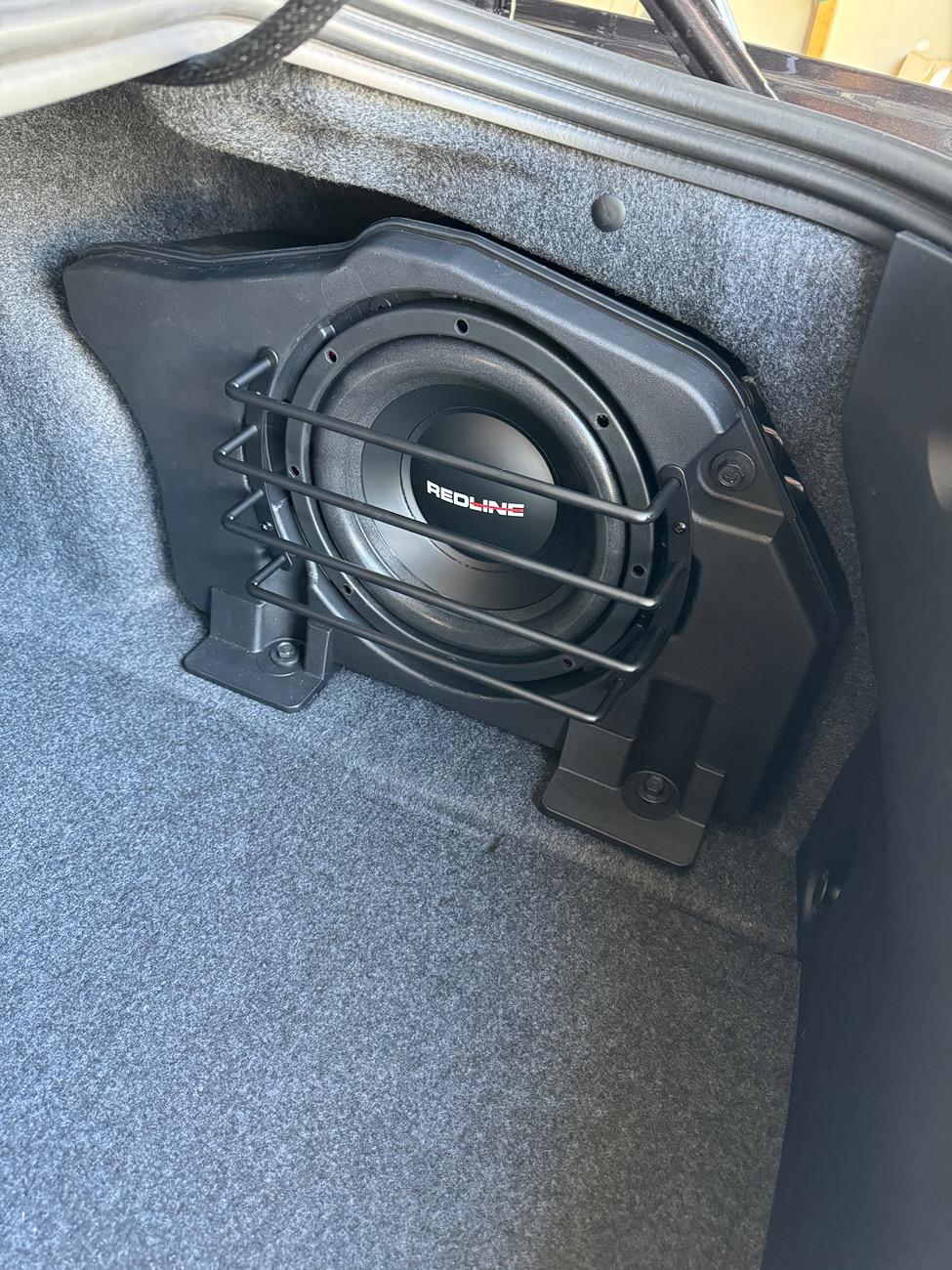

I just ordered the REDLINE SW Series 300W 10-Inch Subwoofer EOL (D4) from DD audio. Slightly better efficiency than the Pioneer but doubt one could hear the difference. Close out with no tax. $85.62 includes shipping.
That’s what I ordered. I am a big DD fan and their Redline series is a great value. I prefer dedicated speaker companies than big box electronics.

And definitely no placebo effect. I cannot comment on the Pioneer but the DD hits much harder and tighter than the stock sub. The difference is very clear!

I think I’m going to go with a DD as well. Was it plug and play? And also where’d you get that grill to protect it?

It is the same P&P connection as the Pioneer. Grill came from Amazon.
GS Power 10 inch Bar Grille for Subwoofer & Speaker in Chrome Silver or Matte Black Finish (1 pc). Also Available in 8 & 12” https://a.co/d/aI8AKDP

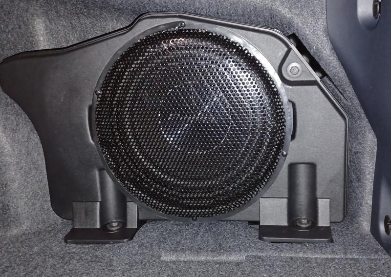

Did a little upgrade on the stock subwoofer after following a thread on the s550 forums. The pioneer replacement subwoofer was only $79 and took less than an hour to do!
Sounds tighter and more crisp than the OEM subwoofer.
Honestly kind of surprised with how much better it sounds over the crappy cardboard subwoofer that comes factory.
I figured I would make a video on the install because I couldn't find one and its just easier to follow along a video than sift through 40 pages of a forum thread
initial thread: https://www.mustang6g.com/forums/threads/b-o-10-sub-replacement-guide.148813/
Couple things: I would have over drilled the holes and made them bigger - would that have solved the issue - I think, and cleaner ...?

You definitely could drill out some new holes. I just would rather modify the speaker rather than the box. Less expensive to replace the speaker than the enclosure if I had messed anything up.

I meant the speaker - not the box 👍🏻

Do you wire both negatives and both positives from the car to one side of the subwoofer or do you wire one of each from the car to one of each form the sub?

I wired one of each to the sub. Two sets
