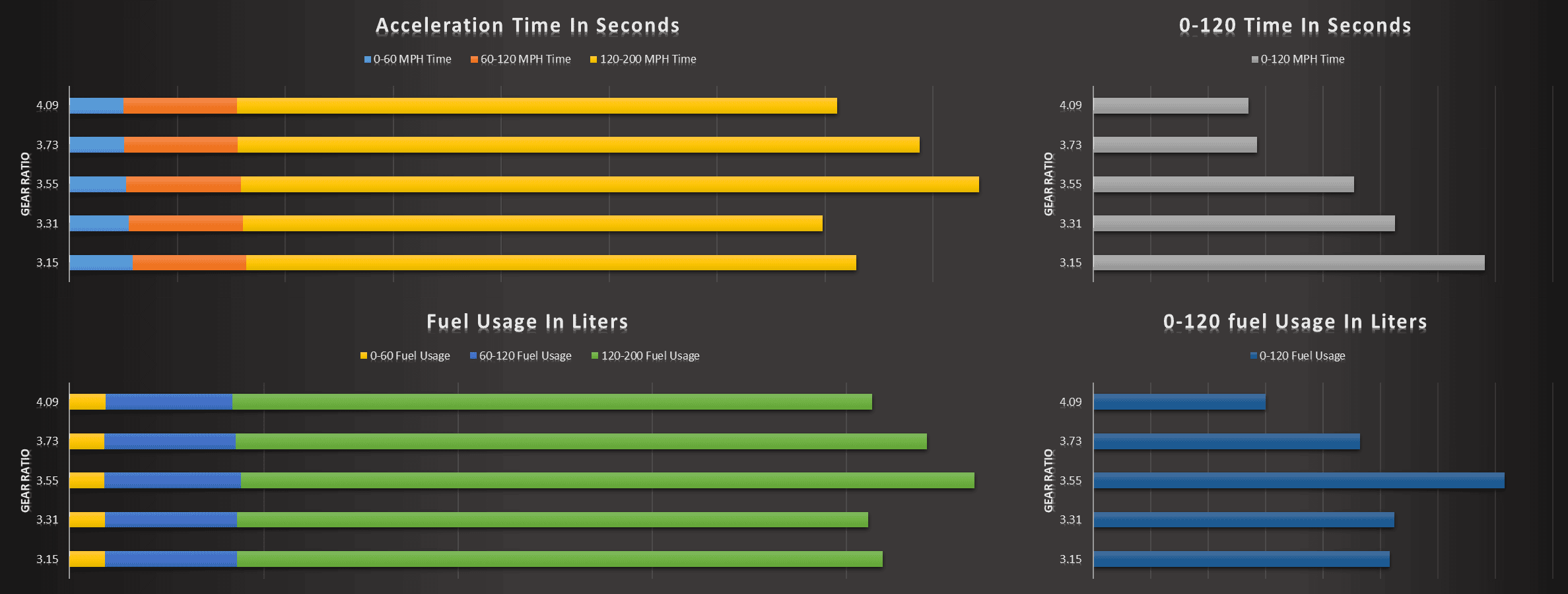

the 3.15 will be better for daily stuff and fuel economy, but getting the 3.55 gives you more future options. ones like putting a Torsen diff (a better limited-slip diff than the standard clutch pack type) in it, changing the gears for 3.73 or 4.09 or stuff like that. the 3.55 also has better acceleration. attached is a chart i made a while ago using digital testing methods on what diff ratio is best. there's no time or fuel measurement because it's meant to be a comparison vs each other
Really neat chart and thanks for posting it.
