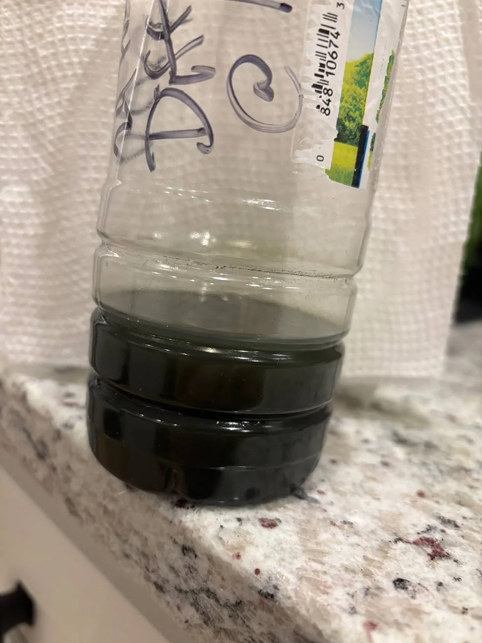

Had my Rear Differential and MT factory installed lubricants drained and replaced at 1,740 miles. MT looked clean but the Service Tech at my local shop (Not Ford) brought out a soda bottle half full of a nasty looking gray looking milky fluid. Pictured in the post. The tech who I trust said it looked like fluid out of a car with 100,000 mile not 1,740 miles. His theory is that the clutches in the rear end are bad and getting worse. Also the CV boot on the drivers left rear was leaking grease all over the chassis and wheel. I’ve got an appointment with my Ford dealer March 25. Never knew there were “clutches” in the rear end. Any thoughts on this?

The CV boot failure is something which has been brought up before. Your S650 is not the first. Was the boot detached from where it is normally secured, or, was the boot itself cracked and broken? Any chance it was struck by road debris?
Regarding the diff fluid, I'd be concerned if there were metal shavings with that. The color, could be due to the surfaces of the clutch material seating and wearing in from new and general wear. The plates inside do rub against one another.
I'm attaching two files, explaining the differences between an LSD and Torsen; they each have their own advantages and shortfalls. It depends on how those diffs will be used, circuit track or drag race, for example.
Edit,
One thing you could do to monitor the diff: if a gauge to monitor is available ("axle", page 408 of the manual), watch the rear diff temp. Mine slowly comes up to temp and later stabilizes; it has never displayed a reading to give me concern.
If you are seeing a lot of slippage in the diff, I'd think it's show in two ways: 1) the driving experience, either in traction or sound, 2) the diff temps being much higher than expected.

Milky oil could be due to air mixing while you were driving. It would be best to let it sit over night and see of the milky appearance goes away. That said, my 96 mustang had a bad rear end from the factory. It would sing and took a while to verify it wasn't the transmission. When they assembled it, they didn't get the gears lined up and that caused it to sing. Ford rebuilt it under warranty and that corrected the problem. Gear lub used to be black but depending on where they put it, they can use something as thin as automatic transmission fluid I hope you guy is up to date on what ford is using because unless you race, you shouldn't need to touch the rear end for a long time.

UPDATE
