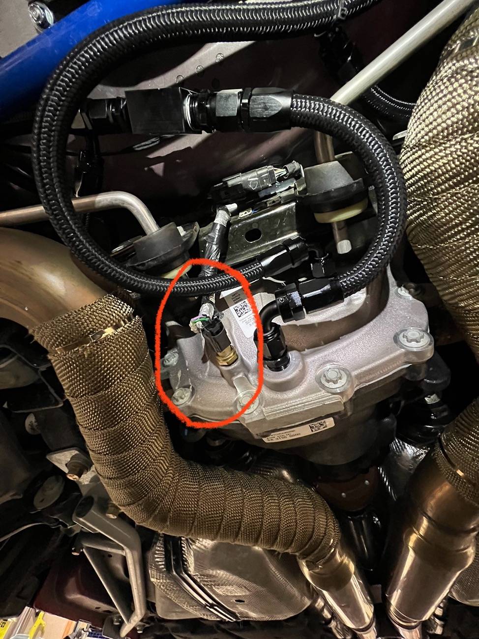

Are the rear differential temps on non cooler installed S650 Mustangs "inferred" like the engine oil temps?
No. There is a sensor in the differential. I’ve circled it in red in the photo.

Did you have to drill and thread the boss for the temp sensor or was it already drilled and threaded?
The temp sensor is installed from the factory on performance pack cars. I don't think non-pp cars have the sensor.
